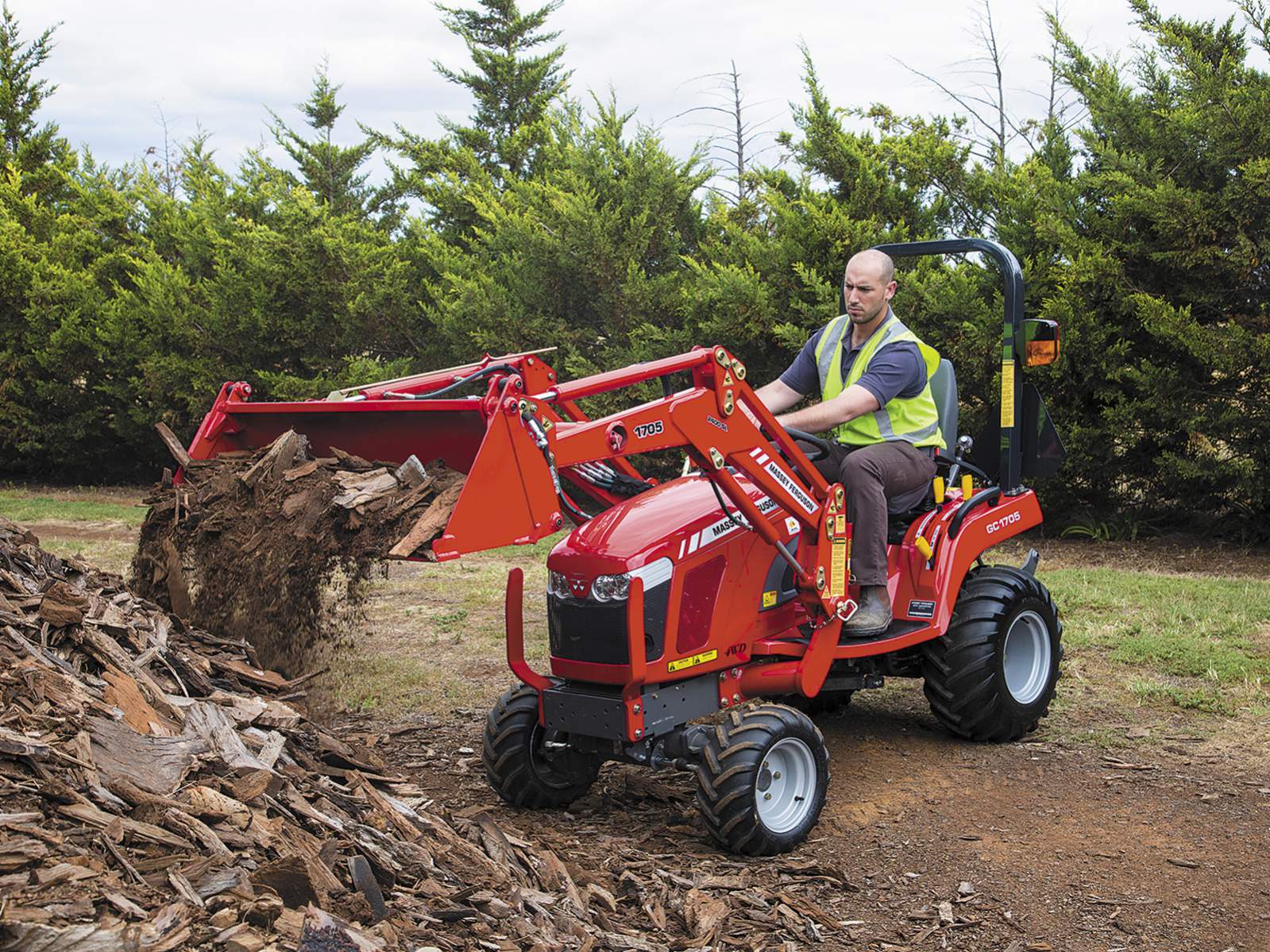

Just curious and I know this is probably not an option at this point, but has anyone seen or run this low agressive AG tire as shown here? Seems the rounded egde would be mower friendly?
My Sons both run those on the rear of their 2wd JD mowing tractors (455 and 420). The lugs are much sharper than R4s and rip the sod up easily when changing directions.
