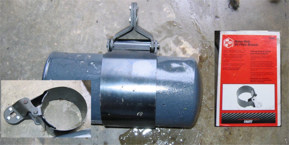

We were doing our 50hr new equipment service on the Mahindra 3510 and the hydraulic filter is about 4.25" x 10" (?).
The filter wrenches we had barely fit on the filter and being the automotive type have a thin band and deformed the filter.
We went to our local heavy equipment repair shop and bought this monster. Took the filter off easily.
About $33.
Thought I'd share the info for others who may have a similar problem.
Size really matters in this situation... /forums/images/graemlins/grin.gif Anybody have a larger wrench?
-JC

/ Filter wrench for large filters
From the front of the box:
KD Heavy-Duty Oil Filter Wrench 2320.
4-1/8" to 4-21/32", 1/2" square drive.
"Fits most Mack truck filters and Ford 6.9 and 7.3L diesel oil and fuel filters"
This local shop repairs tractor trailers, coal trucks, etc. Took my new filter in, found the biggest filter wrench in this style that would fit. The filter band is about 3.5" wide (I'm estimating)
My grandfather always says that having the right tools makes all the difference.
-JC
Phred,
I tried a chain wrench, but it was collapsing the filter. This was the original filter and I guess some of the places must use a welder to install them /forums/images/graemlins/grin.gif
The long filters are certainly more prone to being squashed. There is solid reinforcement at both ends, then that long section in between with basically tin covered cardboard (at least in most oil filters)
That's why I really liked the wide wrench. It gets a good grip and doesn't smash the filter.
I've used the ones like you show. They're great if you've got the room.
-JC
