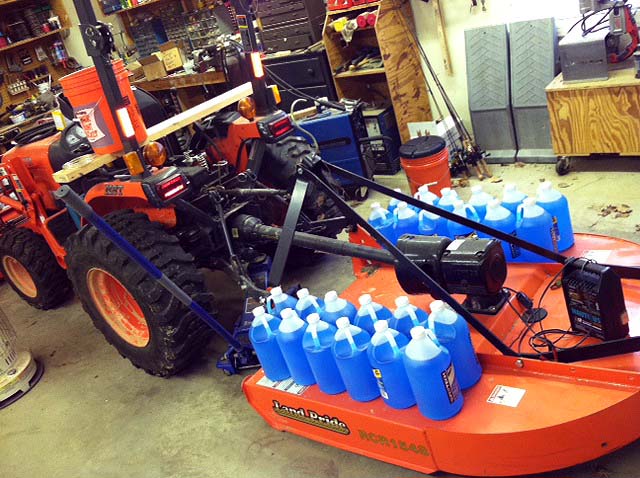

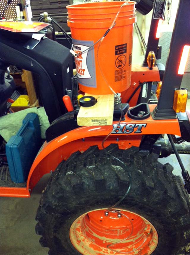

Siphoned 12 gallons of 0 degree Walmart windshield washer fluid from a 5-gallon bucket into each rear tire. Lifted the rear tires slightly with a floor jack and deflated them. The tires seemed to be a little above the level of the axle. I believe 15 gallons would have put them at the 3/4 mark. The whole process took about 3 hours. It will be interesting to see how the ballast and the 2" rear wheel spacers effect the side to side stability.

Just kidding ,what method did you use for the transfer.
edit; guess i should have read instead of just looking at the picture.
View attachment 360681View attachment 360682
I put 40 gallons in each rear on my last tractor.
You will find an improvement in stability.
Between the spacers, and the extra 180 or so lbs. down low - You will be pleased.
So you take the shrader valve out of the stem and connect the flexible tube to stem. How does the air in the tire get out as it's displaced by the fluid? Or is there enough head pressure to keep the flow going without letting air out?
   / Filled My B2920 Tires With Windshield Washer Fluid
I originally planned on removing the shrader valve and using a very small plastic tube (about 1/8" od I think) that would pass thru the shrader valve opening and still have a little clearance for air to escape from the tire. I had done a test shiphoning windshield washer fluid thru that small tube. It would have worked, but it would have been 3 or 4 time slower.
But I found that the valves that came on the wheels where the type of valves that the whole shrader valve section could be unscrewed and removed (it seals with a small o-ring). That allowed me to use a larger plastic tube (1/4" od I think) which made siphoning much faster (about 1 gal per 8 minutes).
My main concern was that the tire might start leaking around the bead before I could get the fluid in and the tire aired back up, but that did not happen.
