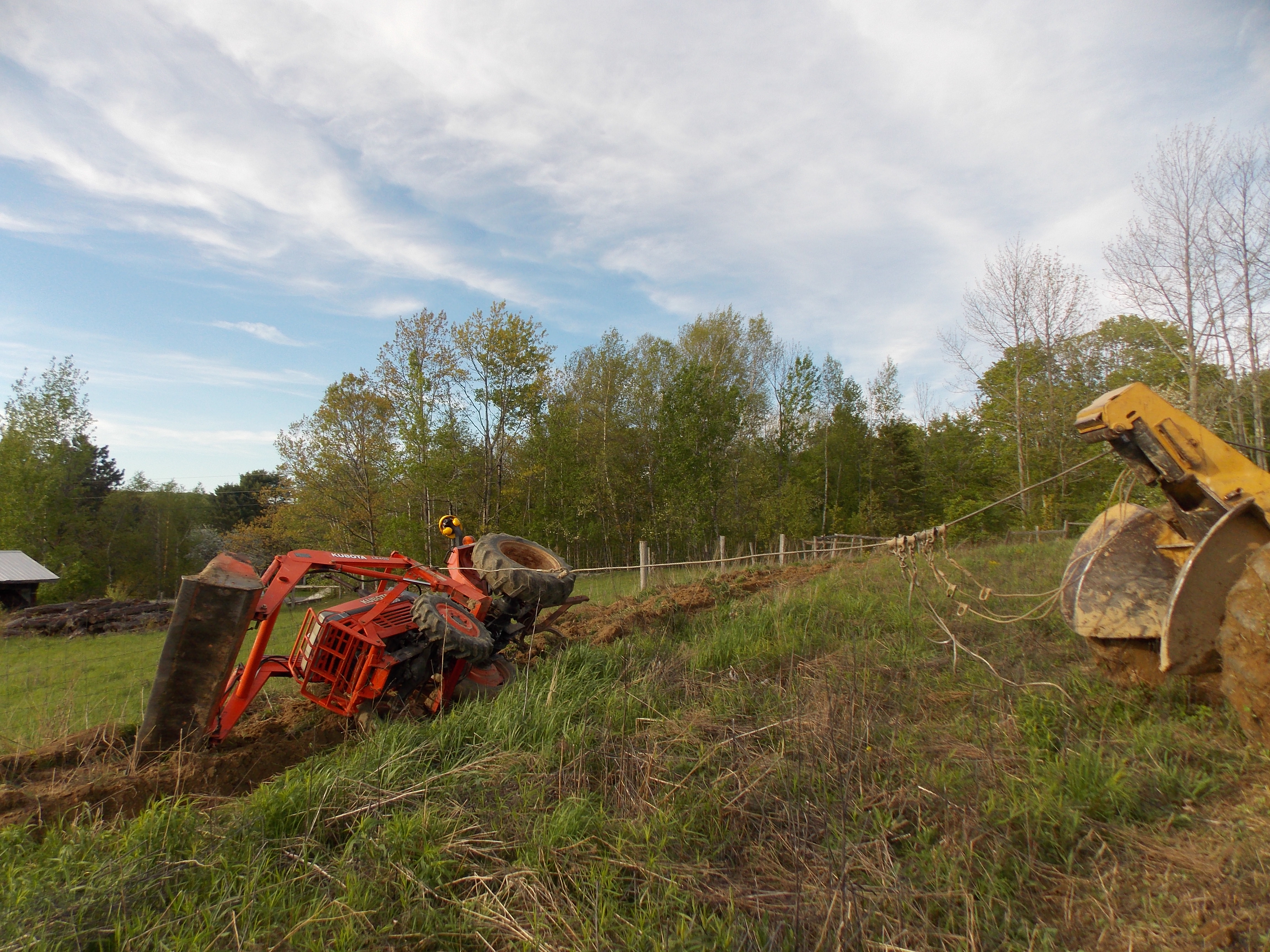

What I have found works good in revitalizing a field is to first use a turning plow and plow the entire field as deeply as possible. I then added lime and fertilizer to my field as a soil test indicated. In this case I went with 2 tons of 05-13-41 which is a great fertilizer for establishing sod, and you will probably need something fairly high on the phosphorus (the middle number). You don't want much nitrogen (the first number) because it will just produce weeds.

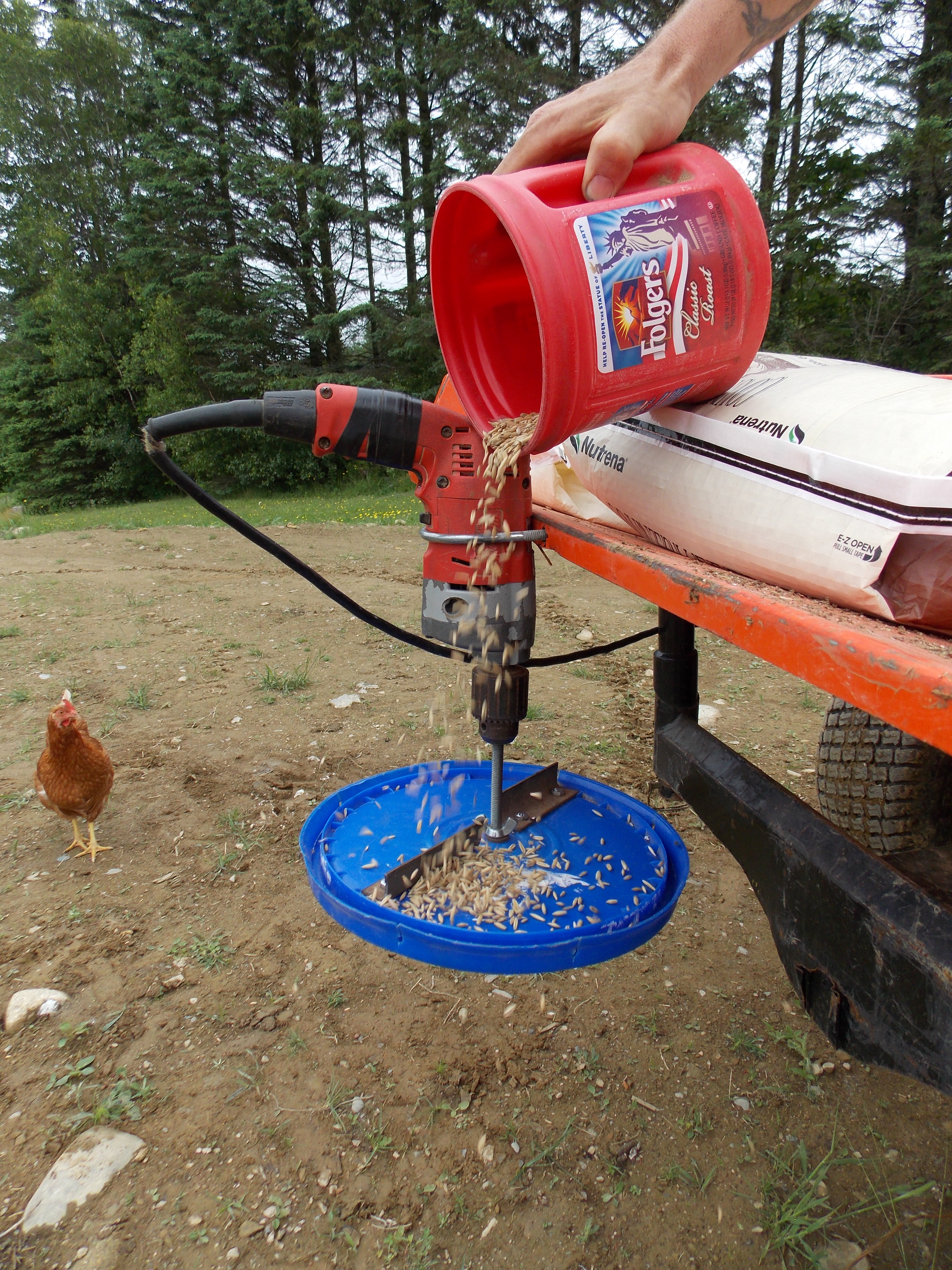

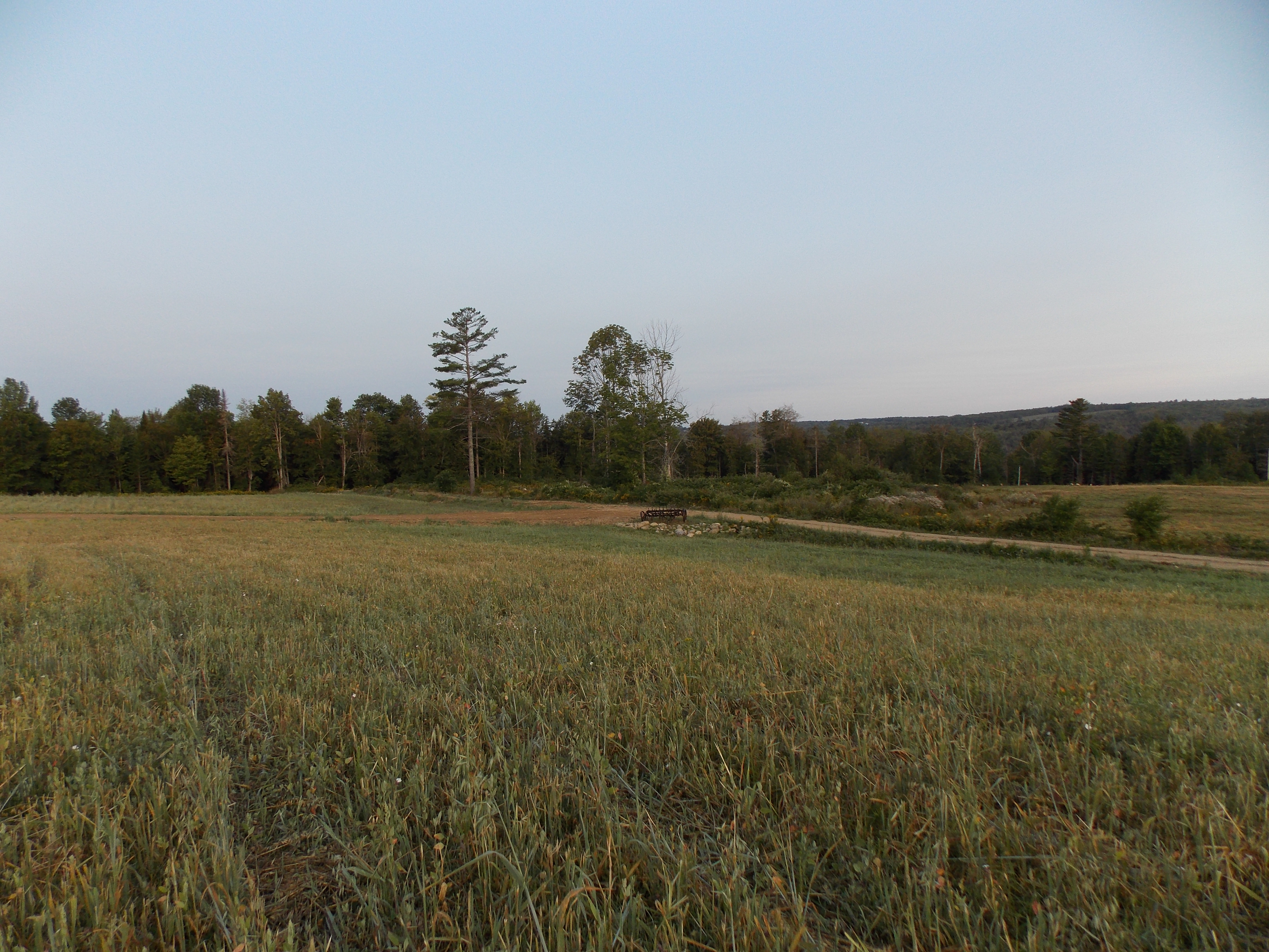

After that I spread seed. Here in Maine where alfalfa is prone to winter kill from the cold, the percentage in the sward is dependent upon snow cover. Myself I like 10% alfalfa, then 45% clover and 45% timothy, with 50 pounds of oats used as a cover crop at time of seeding to keep weeds at bay.
I broadcast this over my fields, then drag that same smoothing log back over my fields to help cover the seed with soil.
I found this method is the fastest, requires the least equipment, and gets the hay fields that I want.
Here are some photos of me land plowing a field last summer of a 10 acre field I was crop-rotating from corn into hay, then smoothing the field with a log, then the resulting field after, and even a homemade broadcaster I made up. Revitalizing a field does NOT have to be complicated or expensive (even if you put the rubber side up on your tractor while plowing). :)
