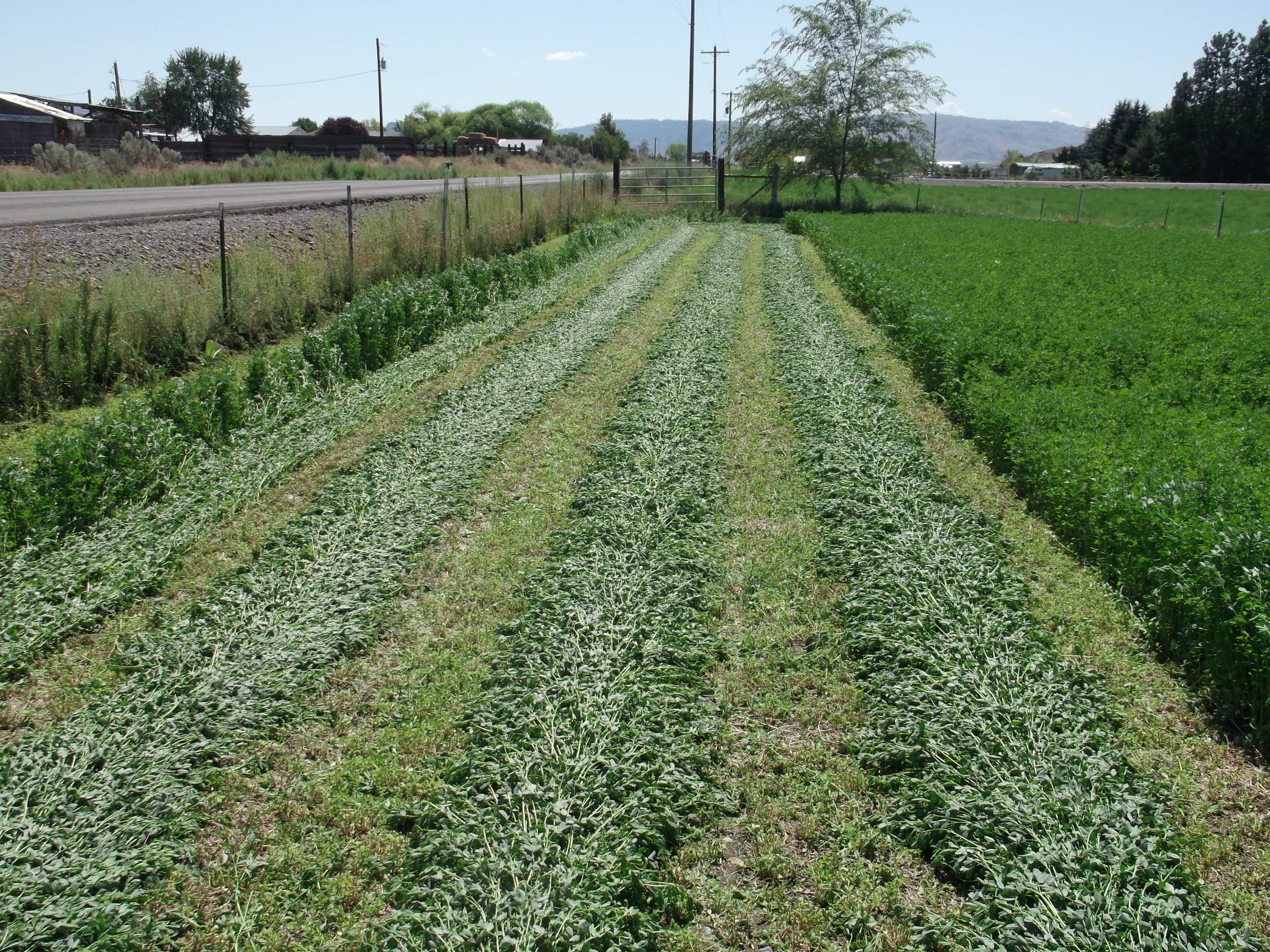

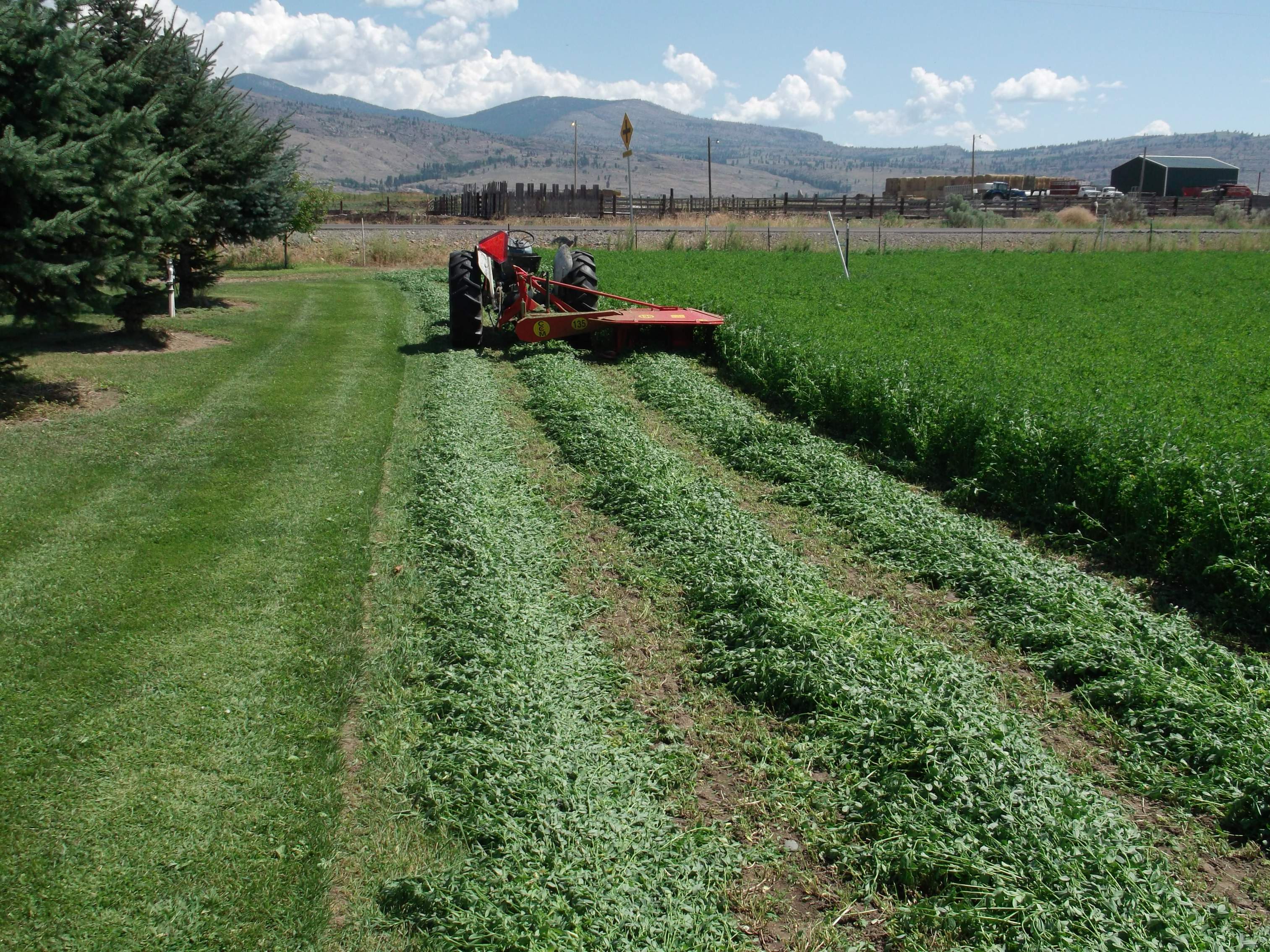

My alfalfa field after the first year of growth... Mowing with my CCM drum mower...
It's a lot of work to prepare soil for years of reward.. I conditioned the soil with a spike tooth harrow... it helped to compact the soil... soil needs to be compacted for the small seed to have contact with the soil.. The seed was sowed in the fall .. above recommended rate.. then spike tooth harrow was ran over it to bury the seed and compact the soil again... fall rains grew the seed to the second and third trifoliate which helps it to overwinter prior to freeze.. alfalfa will grow at about 35 degrees, seems like, so overwintering is not a problem ...
The field has produced well...

Dave, nice work on your Alfalfa field. Very good advice offered as well. Soil definitely needs compacted prior to dropping seed. Then minimal tillage to bury it.
   / field prep for alfalfa? #26
A healthy looking stand, and dense too. Well grown.
   / field prep for alfalfa? #28
Always enjoy your posts. Especially mowing with that drum mower and a vintage Ford Jubilee tractor. A nice mix of the new and the old. Super cool:):thumbsup:
