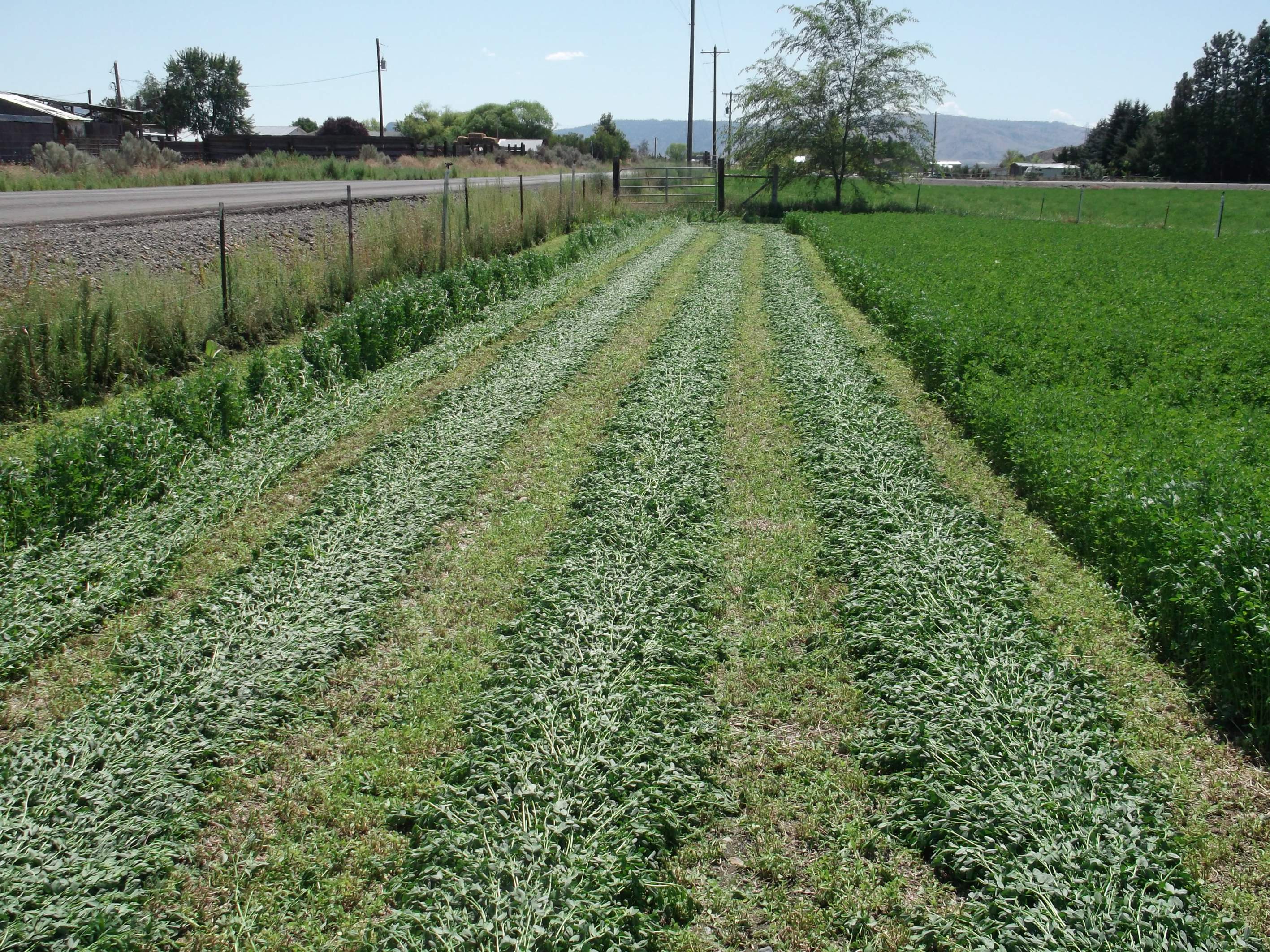

My alfalfa field after the first year of growth... Mowing with my CCM drum mower...
It's a lot of work to prepare soil for years of reward.. I conditioned the soil with a spike tooth harrow... it helped to compact the soil... soil needs to be compacted for the small seed to have contact with the soil.. The seed was sowed in the fall .. above recommended rate.. then spike tooth harrow was ran over it to bury the seed and compact the soil again... fall rains grew the seed to the second and third trifoliate which helps it to overwinter prior to freeze.. alfalfa will grow at about 35 degrees, seems like, so overwintering is not a problem ...
The field has produced well...

Dave, nice work on your Alfalfa field. Very good advice offered as well. Soil definitely needs compacted prior to dropping seed. Then minimal tillage to bury it.
/ field prep for alfalfa? #26
A healthy looking stand, and dense too. Well grown.
/ field prep for alfalfa? #28
Always enjoy your posts. Especially mowing with that drum mower and a vintage Ford Jubilee tractor. A nice mix of the new and the old. Super cool:):thumbsup:

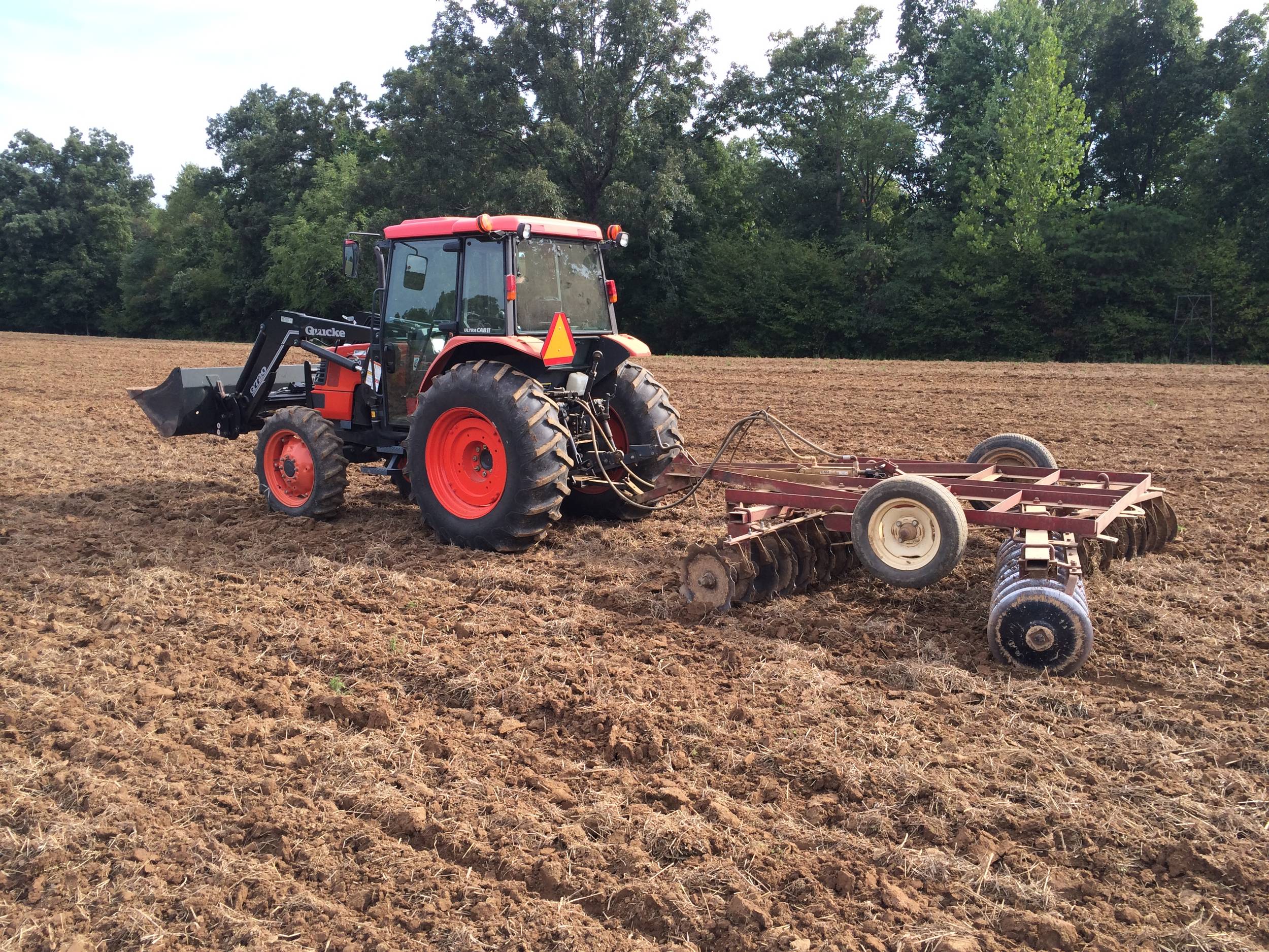

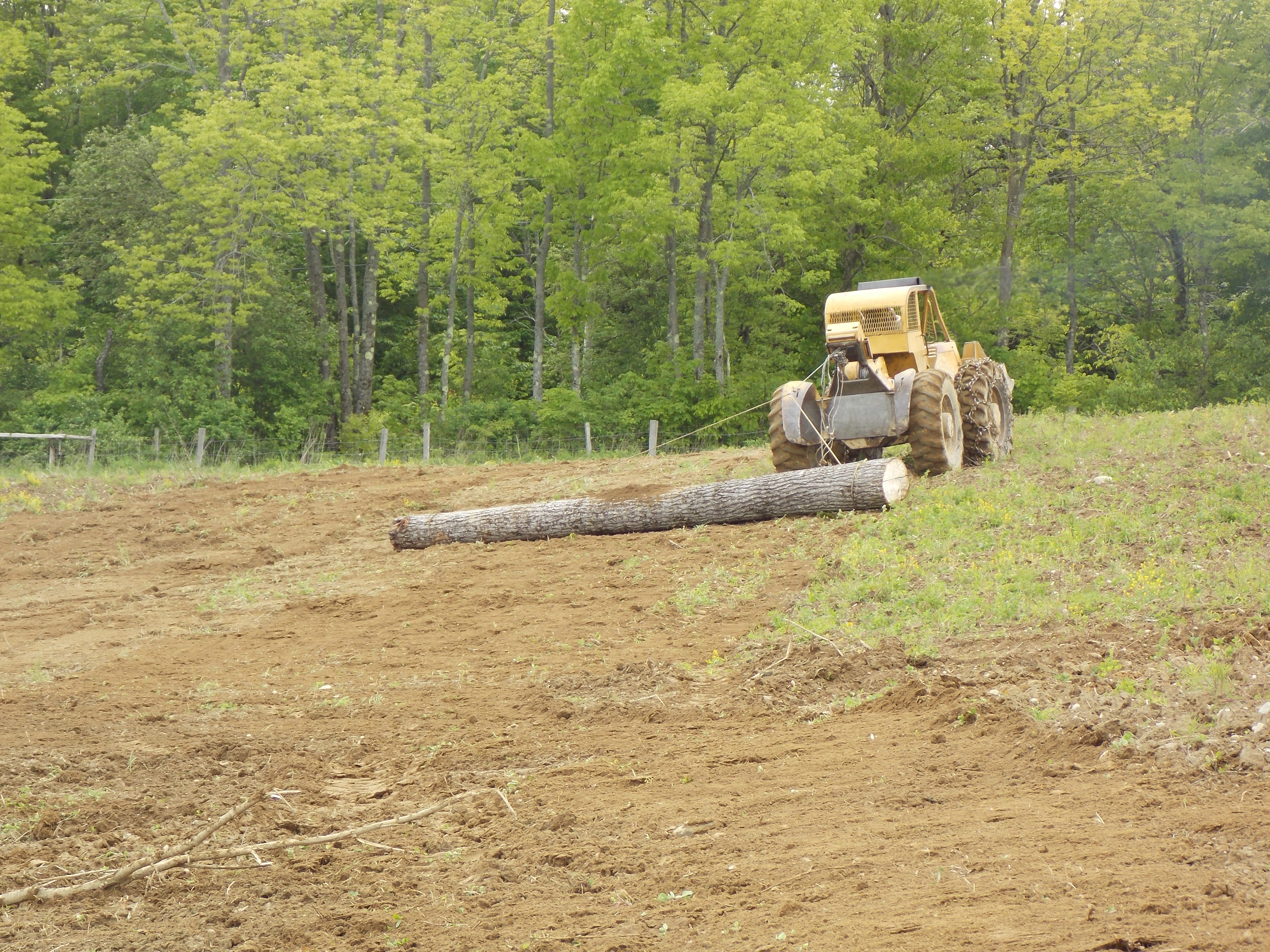

What I have found works good in revitalizing a field is to first use a turning plow and plow the entire field as deeply as possible. I then added lime and fertilizer to my field as a soil test indicated. In this case I went with 2 tons of 05-13-41 which is a great fertilizer for establishing sod, and you will probably need something fairly high on the phosphorus (the middle number). You don't want much nitrogen (the first number) because it will just produce weeds.

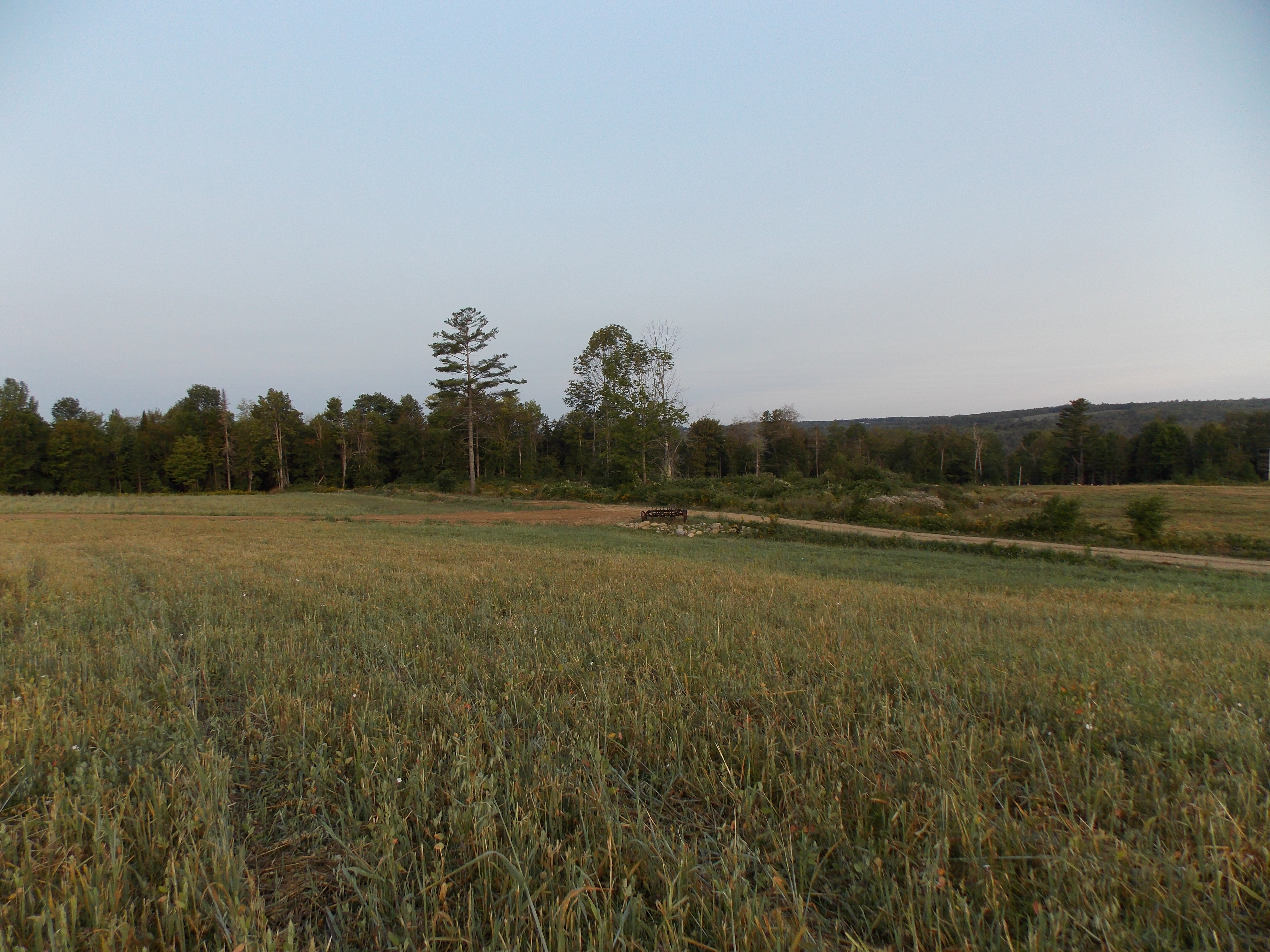

Then I find a log that is as big and long as I can drag with the equipment that I have, and drag it sideways across the field so that it is smooth. The longer the log the better because that will really make a smooth field. It takes several passes, but really makes the field smooth and firm.
Sometimes I have to pick rocks a few times, but mostly the weight and shape of the log presses the rocks into the loosened soil making rock picking much easier. years ago we were silly and disced the field, picked rocks, disked the field and picked rocks...rinse and repeat. It was stupid. Some have said that frost action would push the rocks back up, but I have not found that to be a problem.
After that I spread seed. Here in Maine where alfalfa is prone to winter kill from the cold, the percentage in the sward is dependent upon snow cover. Myself I like 10% alfalfa, then 45% clover and 45% timothy, with 50 pounds of oats used as a cover crop at time of seeding to keep weeds at bay.

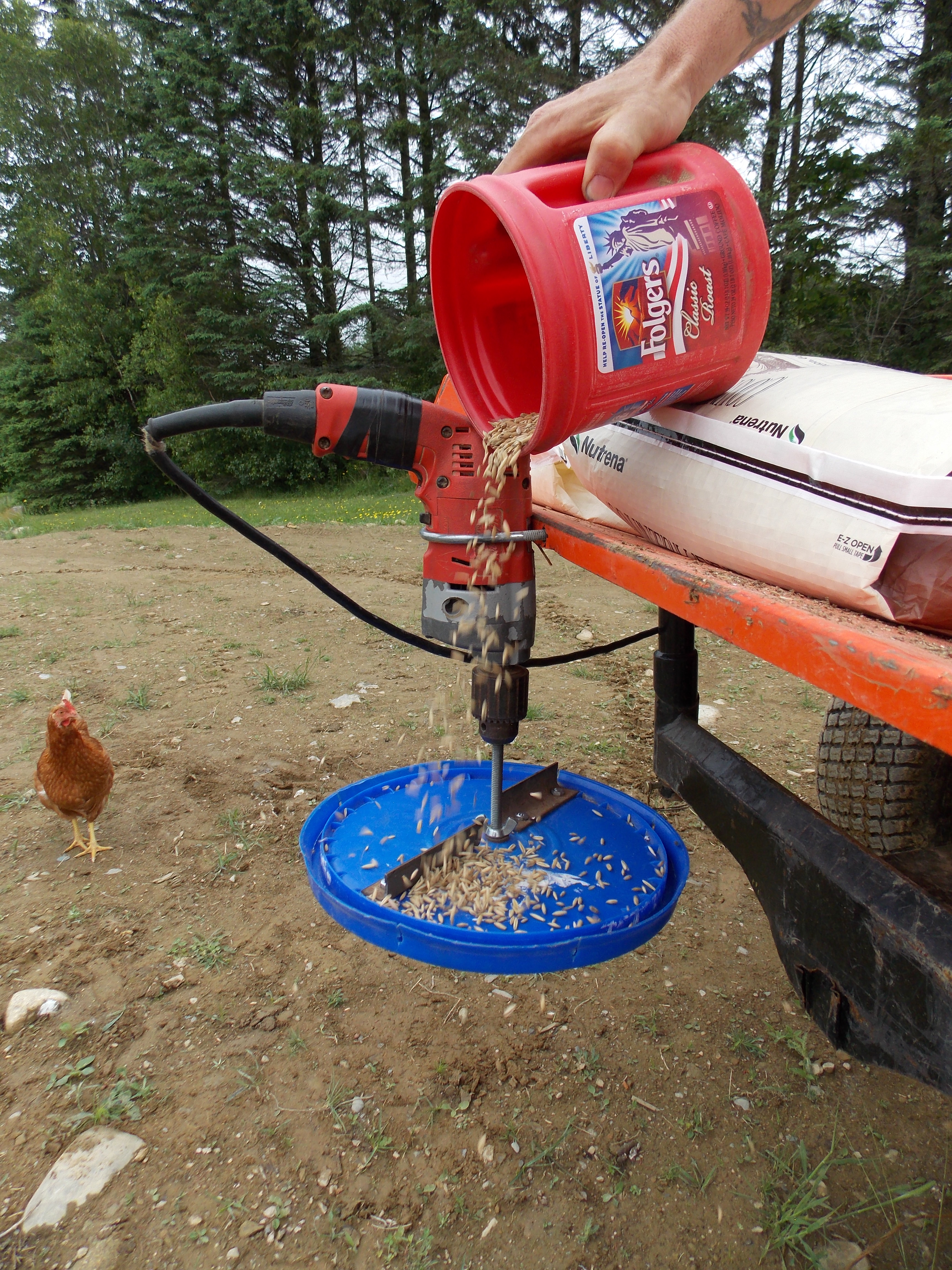

I broadcast this over my fields, then drag that same smoothing log back over my fields to help cover the seed with soil.
I found this method is the fastest, requires the least equipment, and gets the hay fields that I want.

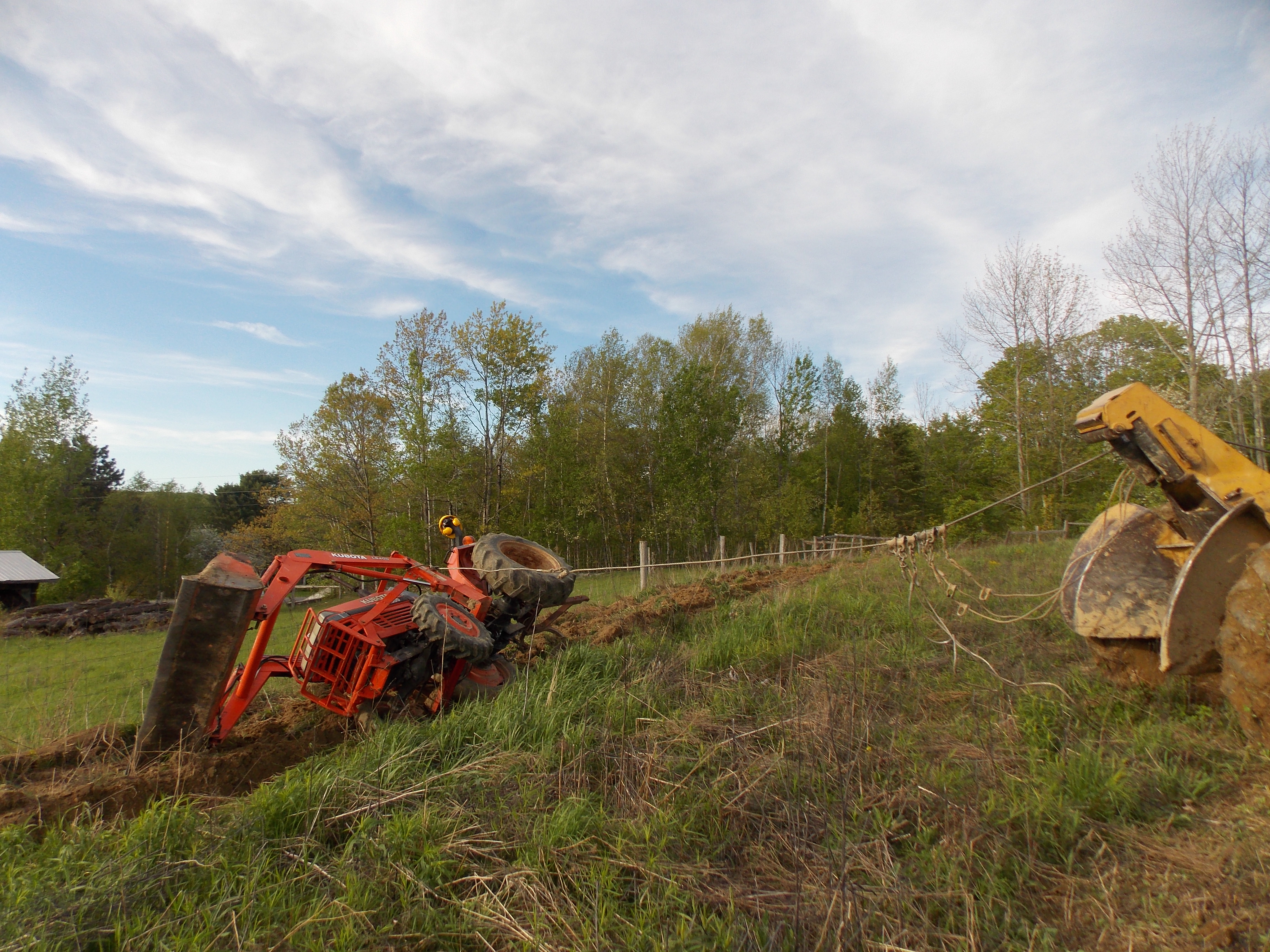

Here are some photos of me land plowing a field last summer of a 10 acre field I was crop-rotating from corn into hay, then smoothing the field with a log, then the resulting field after, and even a homemade broadcaster I made up. Revitalizing a field does NOT have to be complicated or expensive (even if you put the rubber side up on your tractor while plowing). :)
