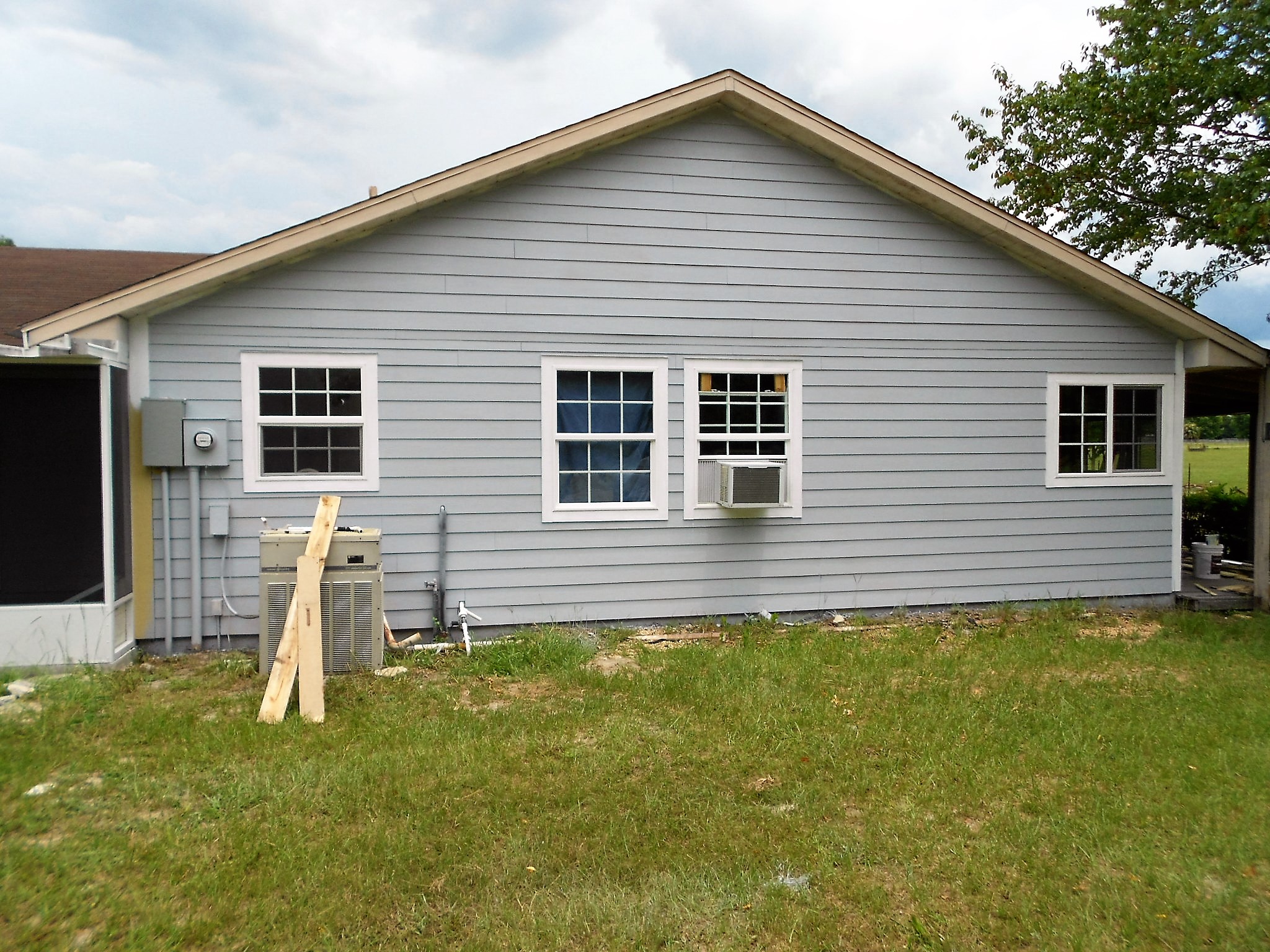

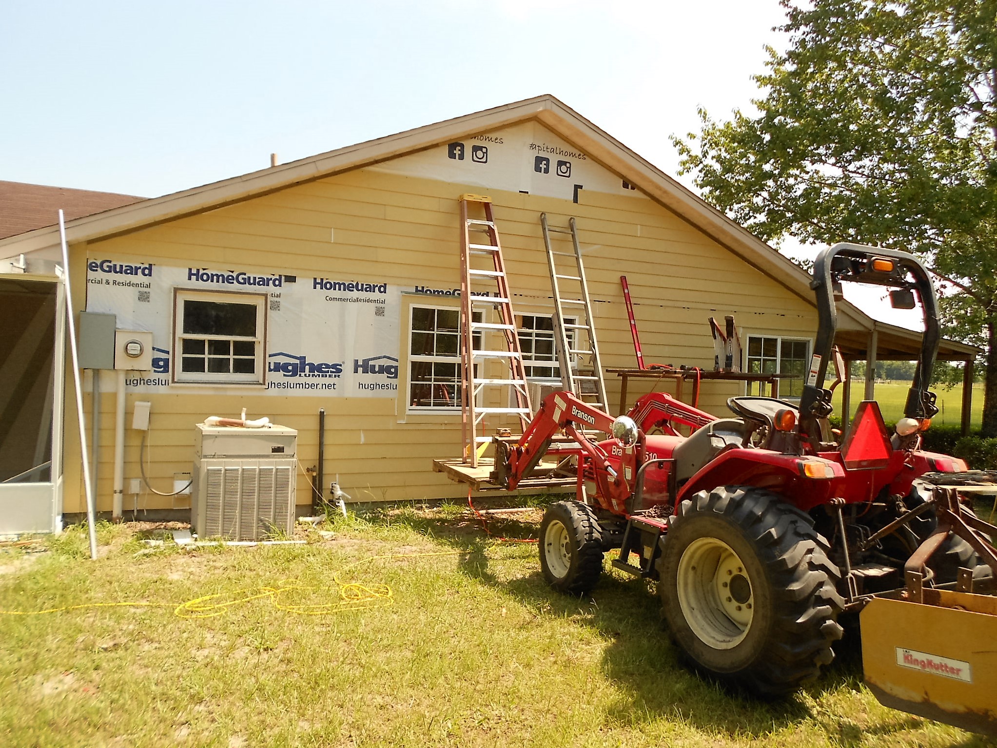

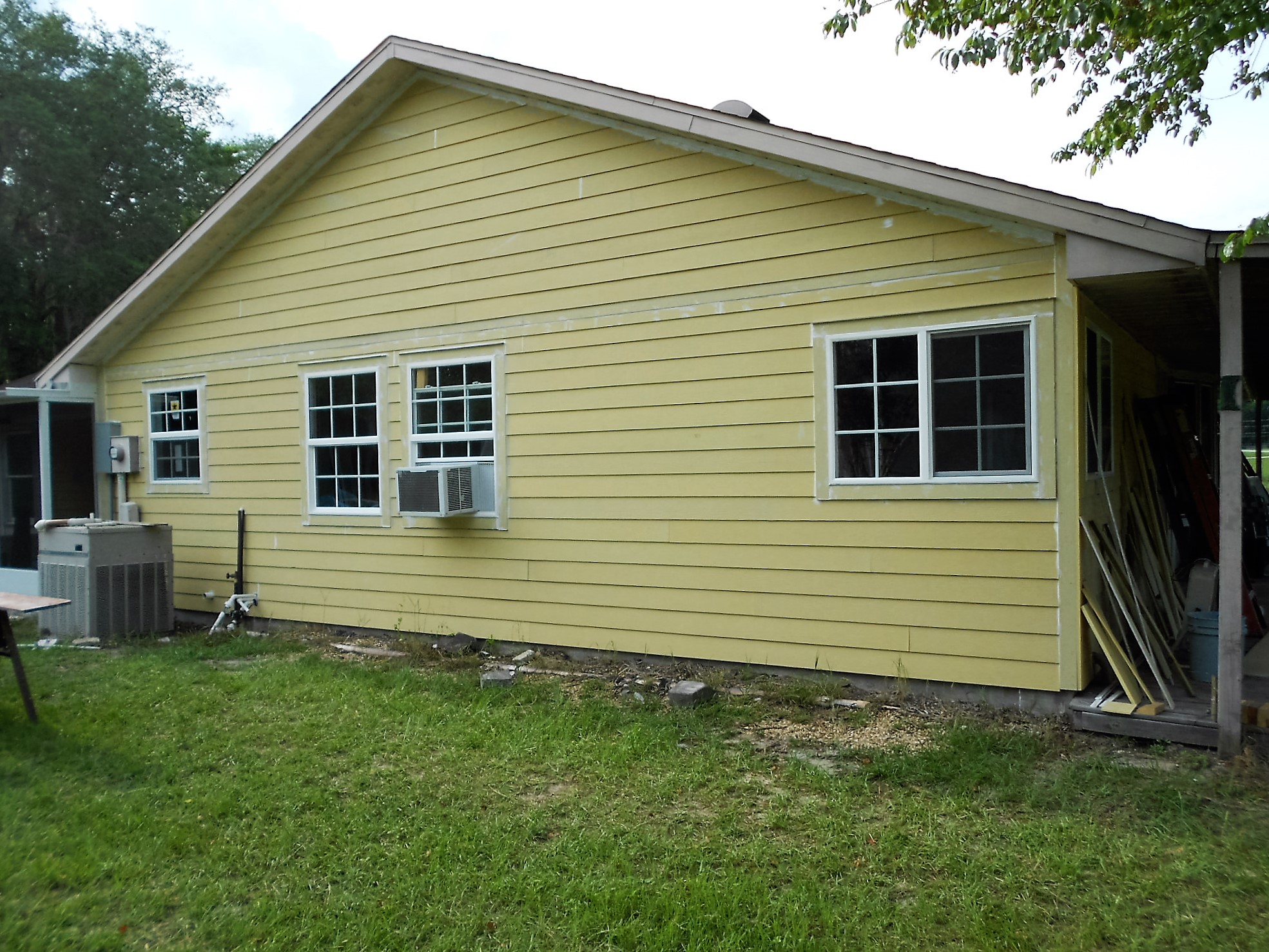

I sided my 2600 sq ft house with Hardie Plank a couple years ago BY MYSELF!!!
Some days 102*, I just turned 70.
My house has metal studs (what a joke!) so I had to install all planks with Hardie Backer Screws.
I used Solo Siders to install and they worked great. I checked EVERY course with a 4' level and they came out perfect.
I sealed every cut with latex paint and put 30 lb felt strips behind every joint.
I cut the whole job with a 4 1/2 grinder and cheap diamond wheel plus a diamond wheel on my old table saw when I needed to rip.
I bought a whole pallet of siding, put it on my trailer and moved it around house plus about 80 more planks.
I had very little waste.
I'm curious....why the double narrow row above the windows?.........Jack
The stupid way that the house was built had T1-11 on the bottom and then T1-11 overlapped from the top.
I had to put a 1" X 4" strip across the top of the bottom panel and lap the next course over it.
I could probably paint that strip white to make it less strange looking. ???
