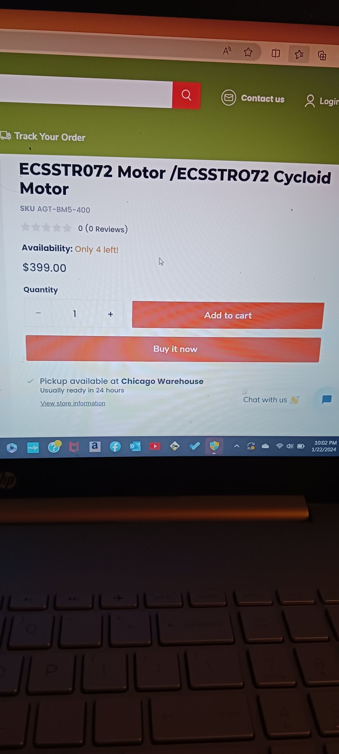

Yeah, they don’t have much in the way of component parts. It’s mainly attachments for the excavator and tracks. I haven’t been able to find anything on hydraulic parts on that site.
I found Hydraulic motor but not the right number. They have the Chat feature, maybe try if cant find anywhere else. AGT chicago 20240122_220218.jpg

That BM2-351 seems like a very convenient typo from a BM2-315. Hydraulic geroller motors typical come in in 200cc, 250 cc, 315cc then 400 cc, which are often part of the model designation. So the 315 cc makes more sense to me.
If you go by dimensions, I'm pretty sure you'll find a motor very fast. The taller the motor, the more CC it has.
For instance, Bailey has a BM2 series motors on their website. Grab a chart from that series of motors and start comparing dimensions.

Thanks for your replies we actually took the rotational motor out of the excavator and disassembled the motor and it turns out there was a piece of metal or a ball, bearing inside the pump, which is jammed up the pump mechanism and I tore it up inside jamming the sprocket that pumps the fluid and turning the motor so I’m in the process now I’m trying to locate a new hydraulic Orbital motor model number bm2-351 but can’t seem to find anyone that sells parts for these things. Any ideas
