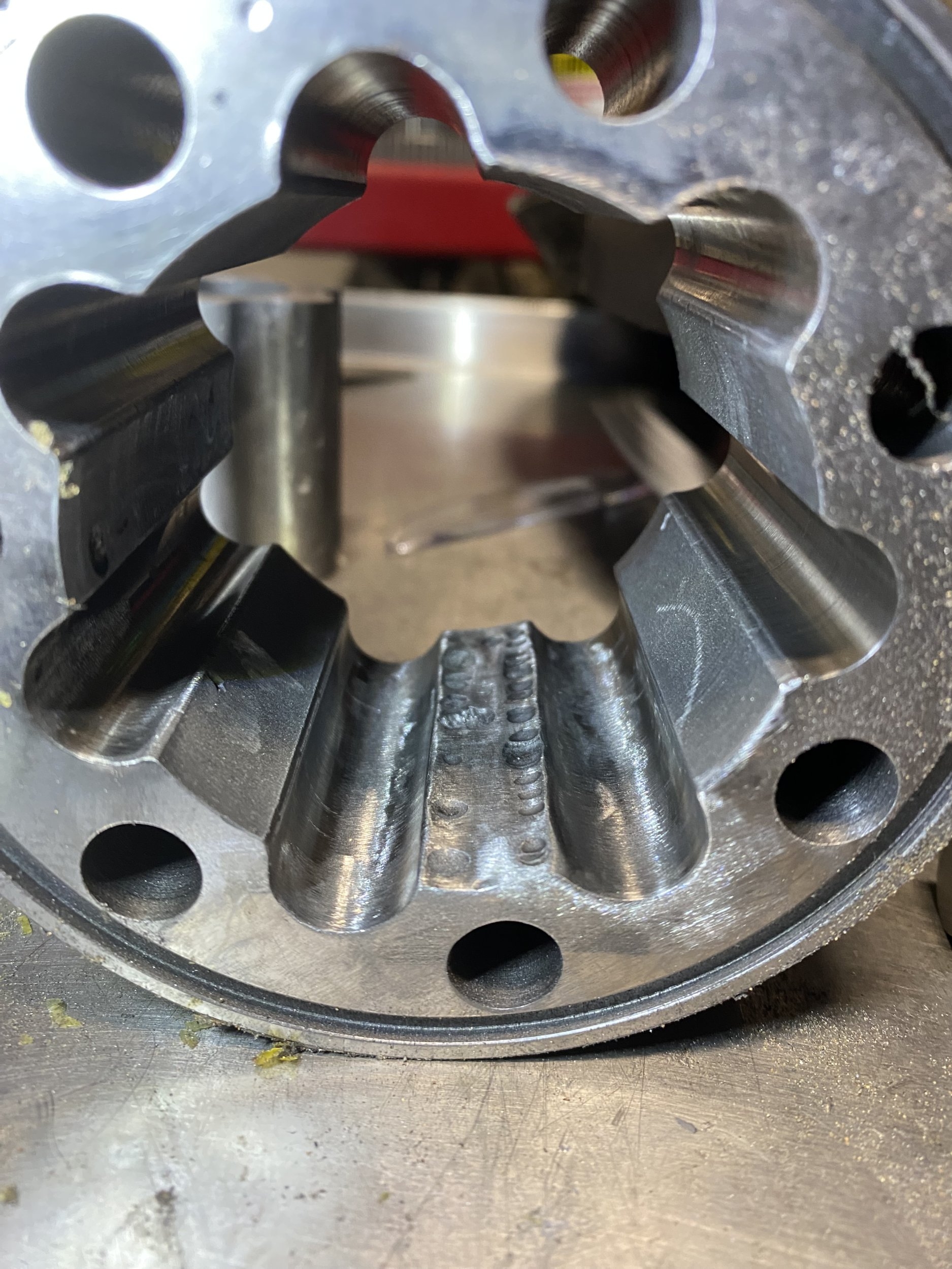

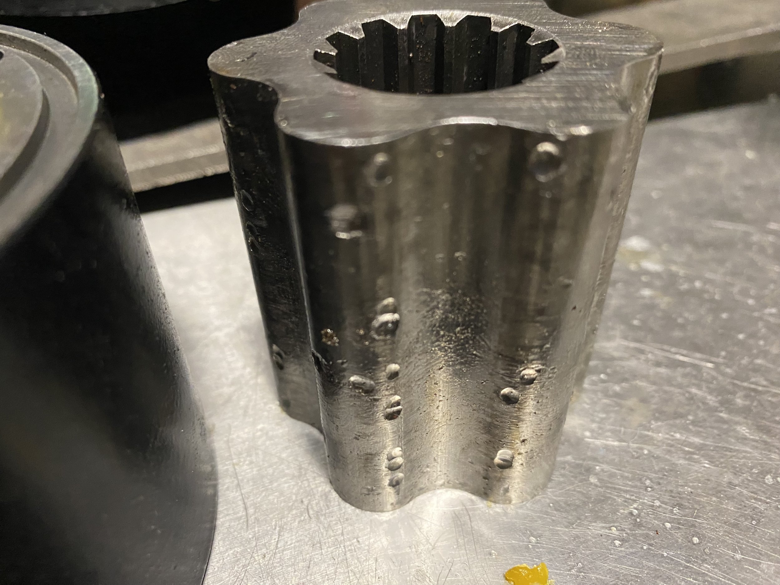

Thanks for your replies we actually took the rotational motor out of the excavator and disassembled the motor and it turns out there was a piece of metal or a ball, bearing inside the pump, which is jammed up the pump mechanism and I tore it up inside jamming the sprocket that pumps the fluid and turning the motor so I’m in the process now I’m trying to locate a new hydraulic Orbital motor model number bm2-351 but can’t seem to find anyone that sells parts for these things. Any ideas
   / Ff12 mini excavator stopped rotating after being washed
Here’s some pics of what we found. Still trying to locate where to buy a new hydronic orbit motor for this with the same model number BM2~351

Did it lock up solid or spin freely after the slew went out?
Something to think about if you ever have a person helping you near the bucket.
#9
It locked up solid
   / Ff12 mini excavator stopped rotating after being washed #10
My L12 has an Eaton swing motor made in Ohio. it may be easier to get and should be the same as yours. My L12 is made by AGT like yours is. Lookng for a pic or # now.
