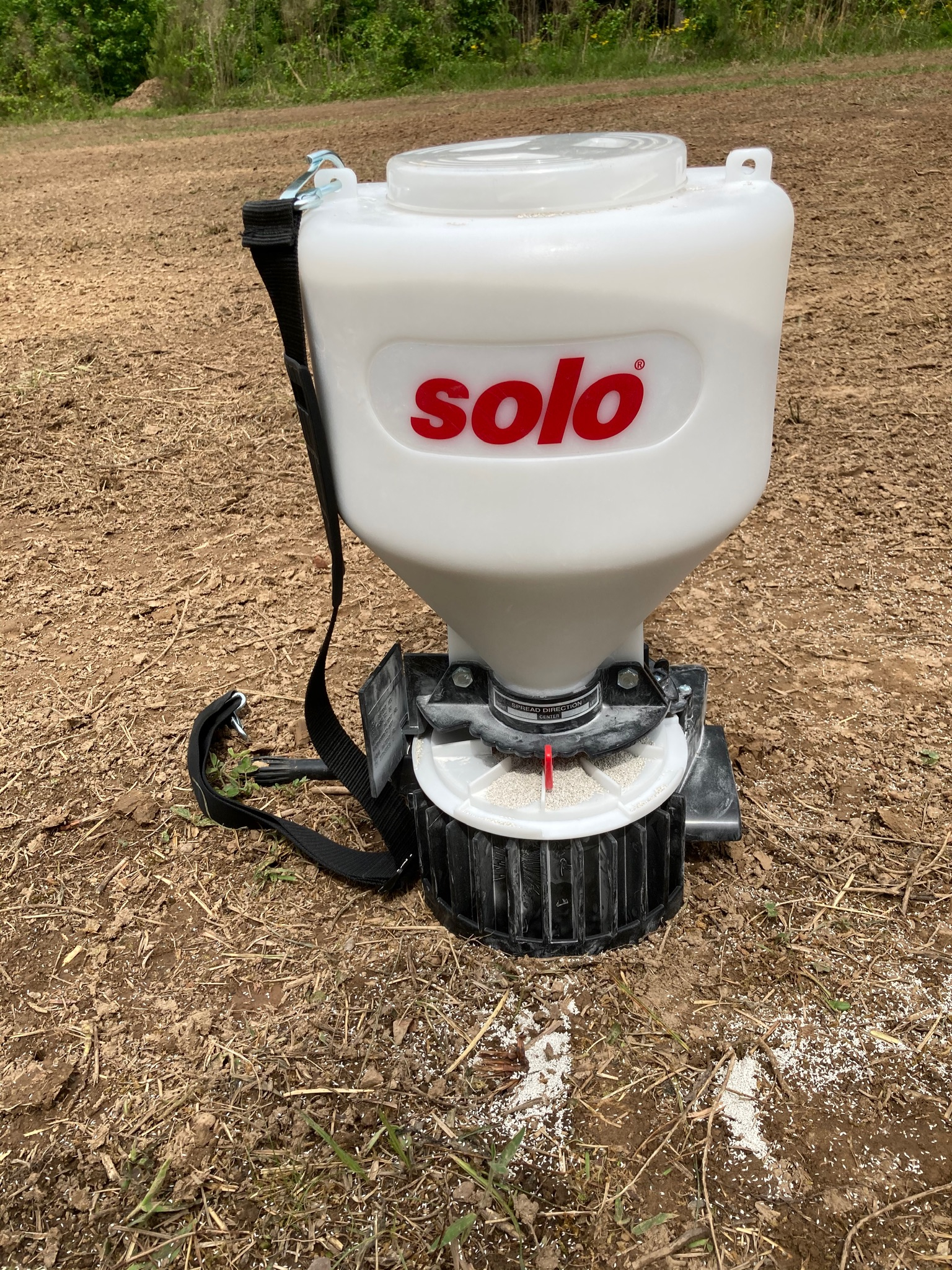

Just want to say I bought a hand held seed spreader yesterday and it works great. About $80.
I've got an area maybe 2 football fields in size and after looking at this and that option I figured it would be easier and faster to just broad cast the seed, after airation, dragging etc etc etc.
