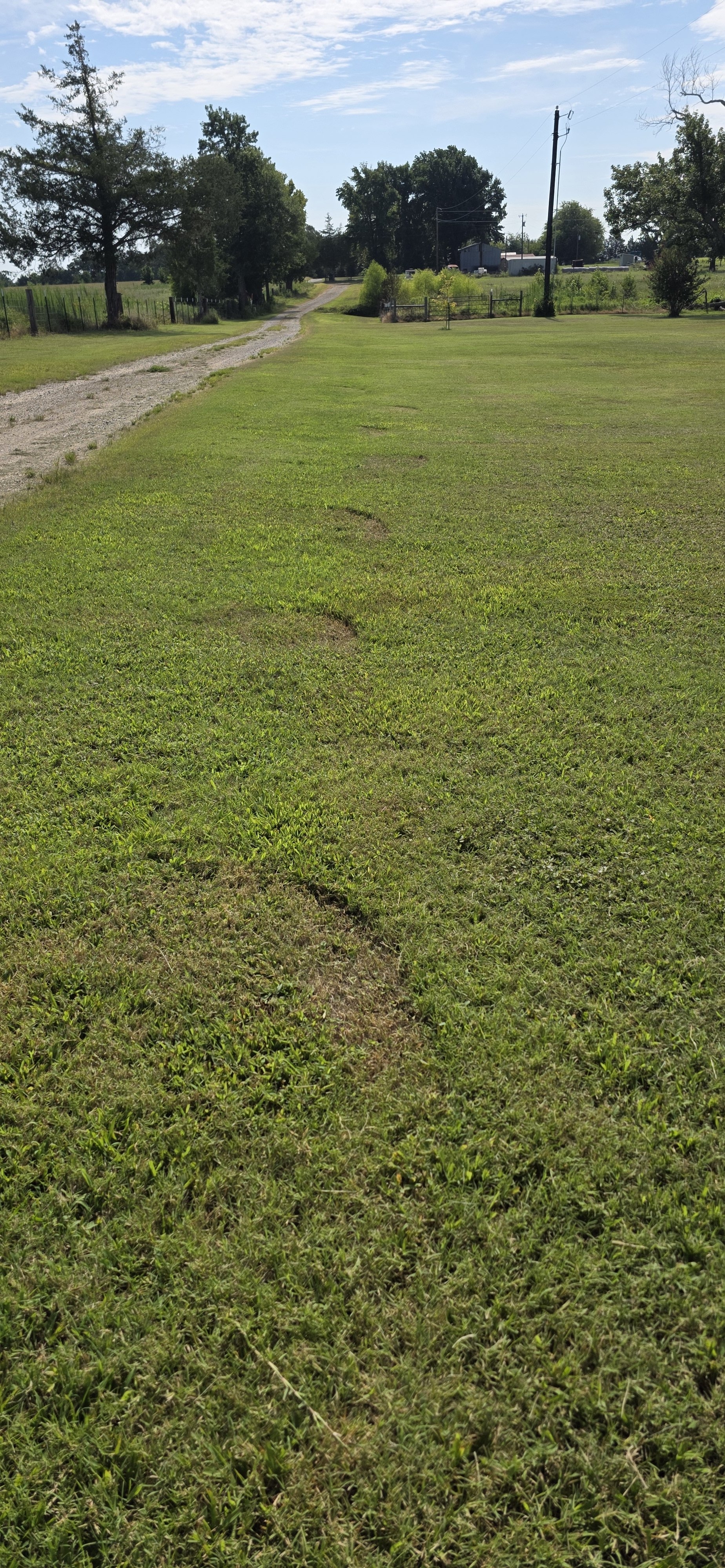

I have a IS700z, so not true IS like yours. I mow at 3.25", and was having some scalping issues..leveled the deck and found it WAY off, especially on LH side that seemed to scalp the most. That took care of mine, and adding in 1/4" of pitch also helped it stripe a little better.
/ Ferris scalping #23
Looks like you are making a couple laps around the lawn to have room to turn around and mowing across the lawn do do the rest. It looks like you are turning right where the slope from the road levels out with the lawn so your deck is hitting the edge of the slope. Maybe try making another lap or two so you are turning on completely level ground.
/ Ferris scalping #25
A low tire will also give you some scalping on turns. At only 12# on my rear tires, it doesn't take much to allow scalping to happen.
