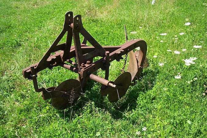

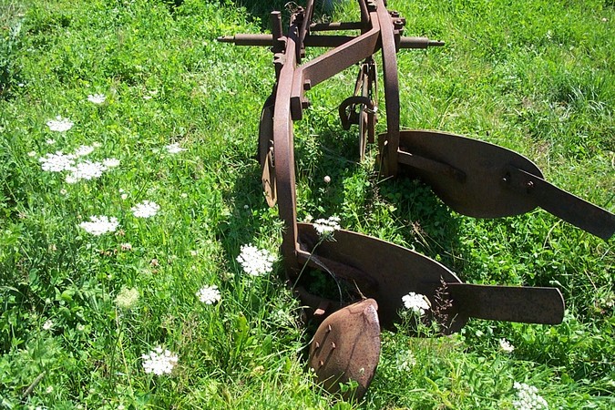

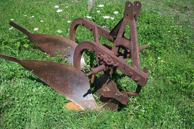

Afternoon Guys,
This past weekend I went to look at a 3 PT 2 BTM Ferguson plow. I pm-ed my buddy Bill aka FWJ to get his feelings on the plow ! I informed him that the asking price is $200 and that one of the points was broken. After I got over there to look at the plow, I realized that not only was the rear point was broke but the rear cutter wheel was also shot ! I know there are other members out there that have much more experience with this type of implement than myself, so feel free to add your commentary. As I informed Bill I would only be using this plow for a garden or food plot at some point in time. Please see attached photos !
BTW, sorry meant to say tail wheel is shot !

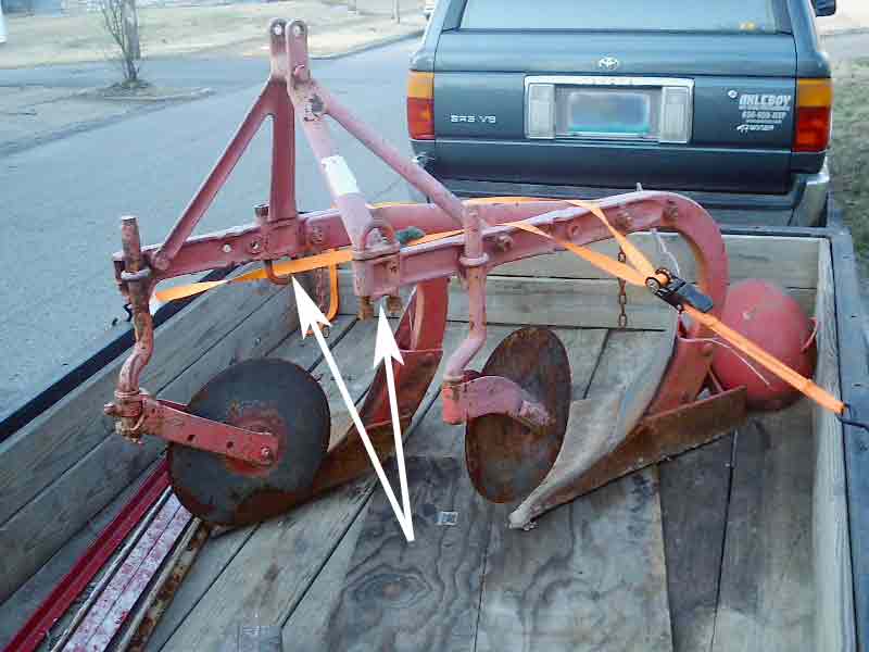

schmism,
Where is the Drawbar ?

Hey Scotty!
Well, from the picture, it looks like a Dearborn plow to me too. No problem with that. In fact, points, albiet hard to find in that style, are EASIER to find for the Dearborn plows. Looks like the coulters were once equipped with jointers. Some of the hardware is still there. I'd remove all the extra parts. They'll just collect debris without the jointer shares. The tailwheel can probably be fixed with parts (or a complete tailwheel assembly) from a later model Ford plow. For MOST plowing conditions, you can get away with not even using a tailwheel. Rotate the offset drawbar so that it moves the tail end of the plow a bit towards the furrow wall, putting a little more pressure on the landslides, and that plow will probably track straight enough without a tailwheel.
I saw a Dearborn 2X12" plow in far WORSE condition than that sell for $420, 2 weeks prior. (P.T. Barnum was right ;))
Bill

Scott, looks too much like a Dearborn 10-8 (assuming its a 12" model). Plow points/share can be had but are pricey. Cast iron will be about $65 each. If you want steel, you can pretty much pay for one what 2 cast will cost. Rear furrow wheels: Usually Dearborn had the scraper at the front of the wheel whereas Fergs (I believe) had the scraper at the rear of the wheel. Good luck with it! BobG in VA

In answer to Deerhunter question, Schisms plow is missing the bar that goes from beam to beam for the lower arms on the 3 pt to hook up to. If you look at the pics I posted you will see what Im talking about.

Schmism I happen to have the draw bar for that plow. I live 30mi. west of St. Louis. PM me if you are interested. You can have it if you come and get it.

ya id love it... mine came with a draw bar, but its the wrong size, its 1.75" in diam and the ubolt spaceing on the dearborn is 1.5" if i remember correctly...
currently i used my straight hole'd drawbar from TSC and used it passing 1 side of the U bolt through the hole in the draw bar. not perfect i know but it worked for me....:cool: (sorta)
so ya id love the correct one.
shooting you a PM
/ Ferguson Plow... Opinions #17
schism I just went out and measured mine 1.75. are you sure that yours is 1.50? I`had two of them both were the same? Give me a call anyway if you want
