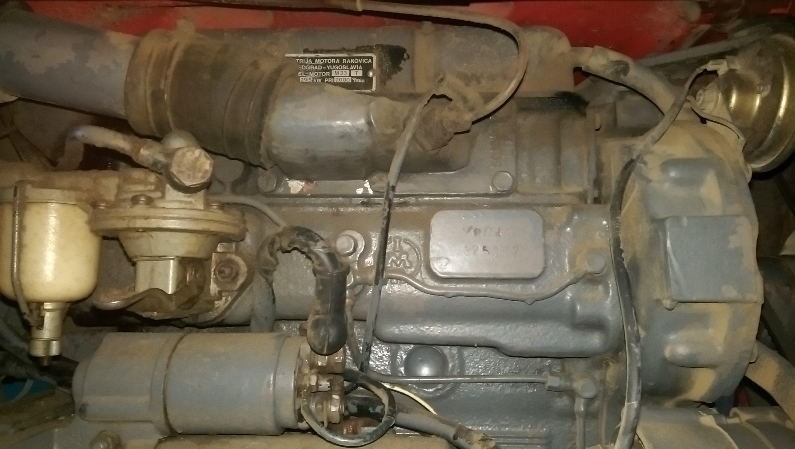

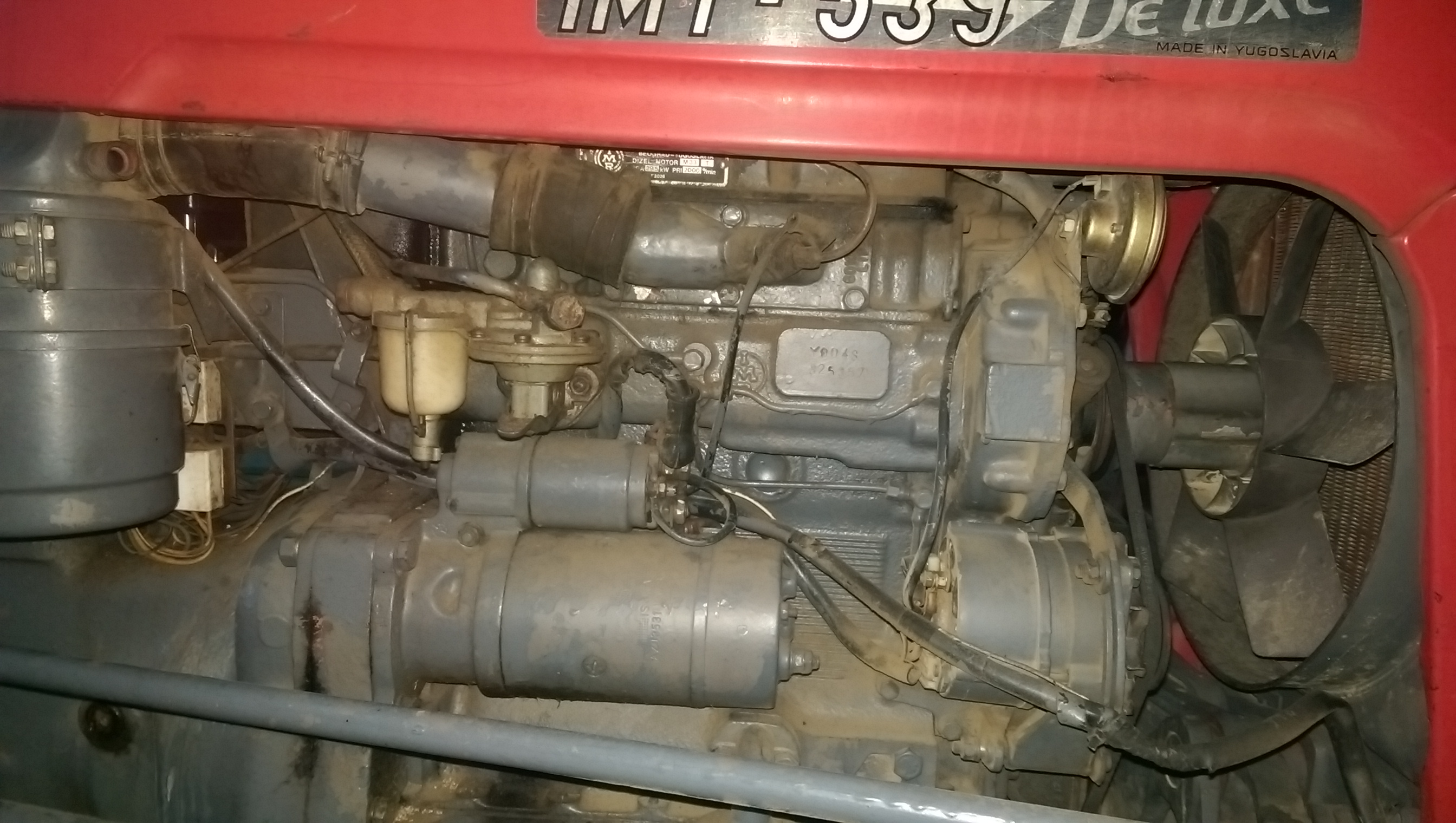

@pumpgay...On the photo I can see its a 3 sil inline pump but can not see if it is a Sims....what is yu tables tels you ?
   / Ferguson excessive smoking #22
And don't forget to keep an eye on the exhaust see what color your smoke is.
This was a problem with some heater plugs brands/years of usage etc
It's worth a check to illuminate it. I'd be thinking it may well be the problem. If not maybe advance the injector pump a little as from the video not sure but thought there might be a little miss when it was ticking over.
   / Ferguson excessive smoking #23
Inline pumps have the output tubes in a fore-aft line along the top of the pump. CAV rotary pumps have the output tubes at the rear end of the pump in a distributor (120 degree distance) configuration. 3000s came out with both. I have a CAV and my FO-41 I & T manual shows Simms.

   / Ferguson excessive smoking #30
Follow that line that's hi-lited in the photo & see where it goes.. does it go over to the injection pump??
IF it does, That would be your "thermo-start".. it allows a small amount of fuel to pass thru a "glow-plug" & create a small fire in the intake manifold for cold starting..
That PLUG might be leaking fuel into the intake instead of shutting off when not needed.. I've seen it happen quite a few times..
IF that's what it is>> just unscrew it out of the manifold & run the engine & see if the smoke cleared up.. quick & simple..
