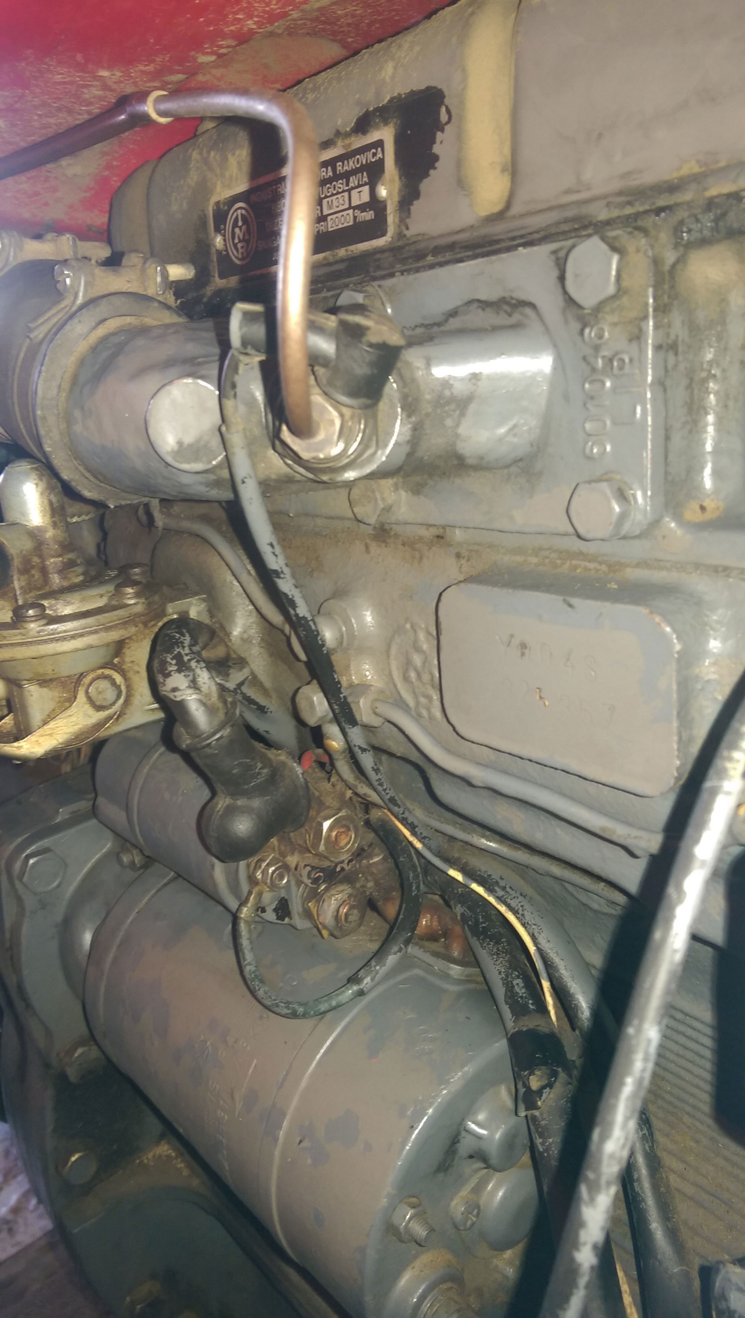

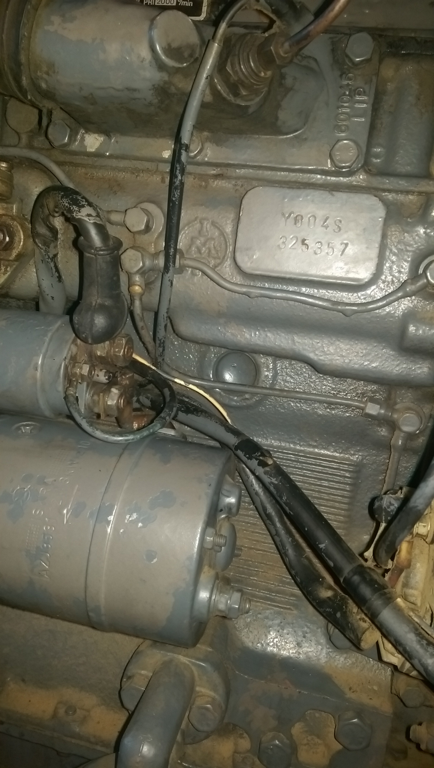

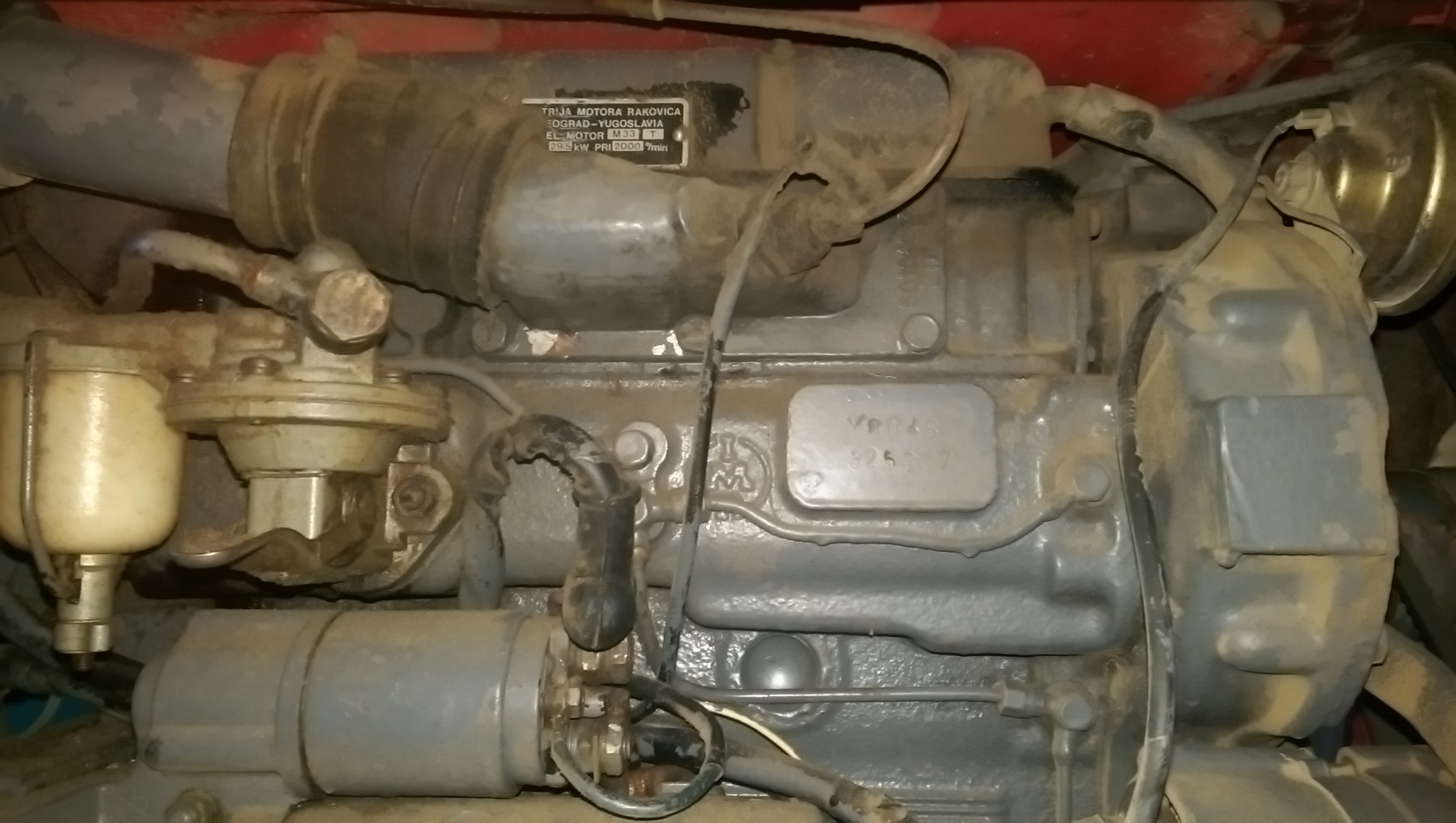

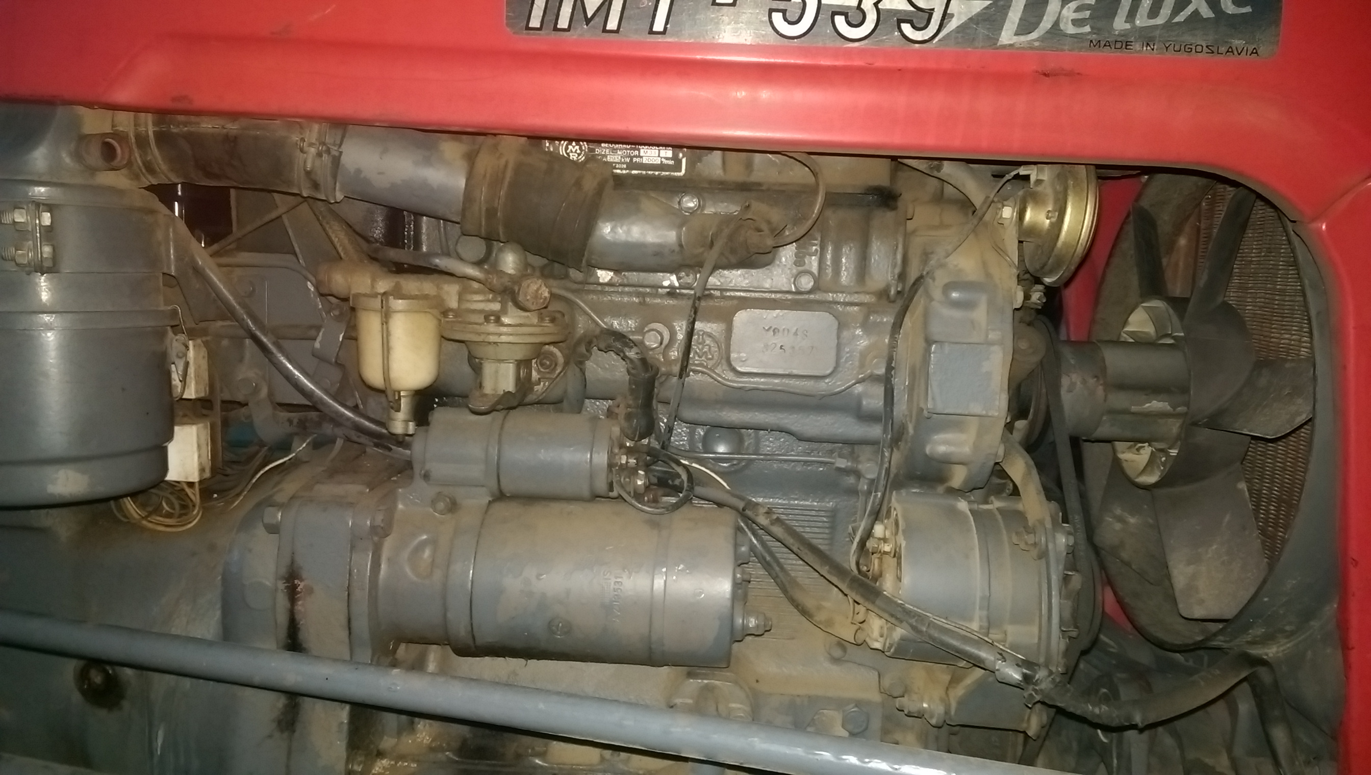

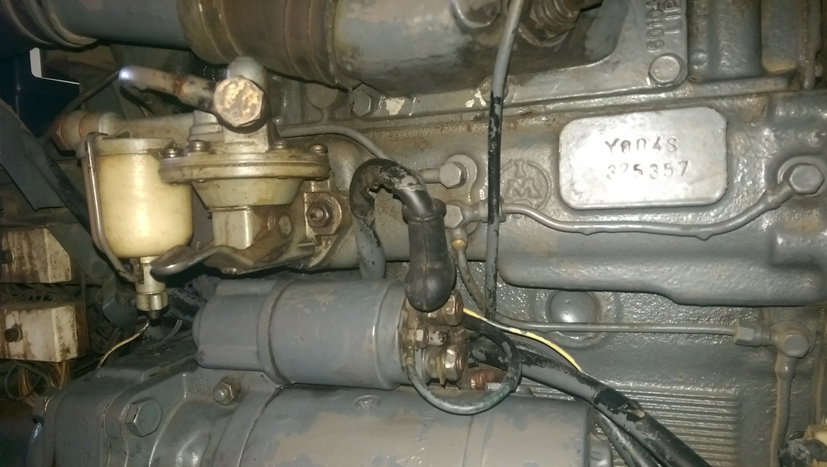

The video is still not viewable on my computer.. Can u snap a couple of pic of the inj. pump?
Can u raise the hood & snap a couple of pics of the air intake, where it goes from plastic/rubber to metal..??

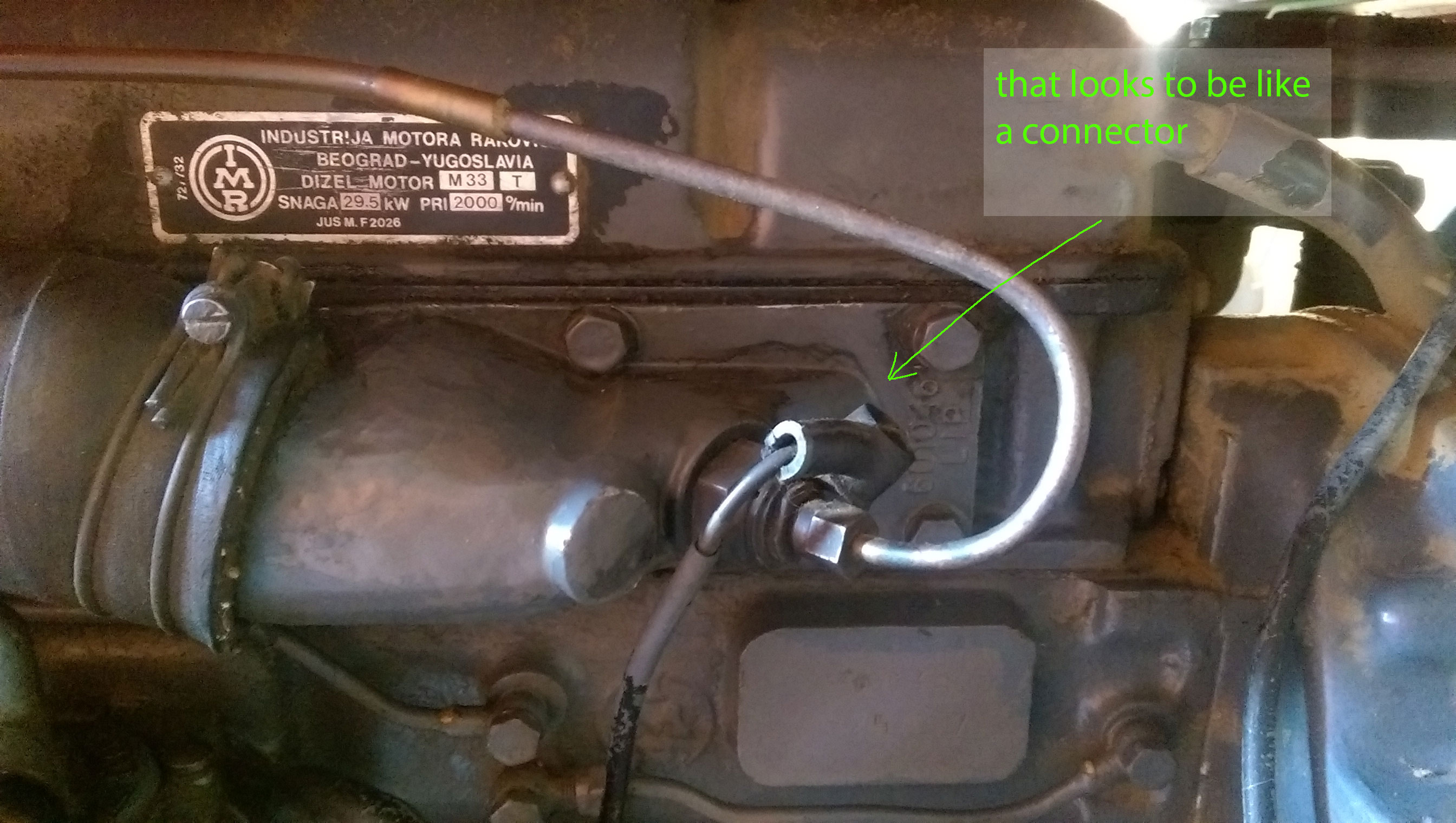

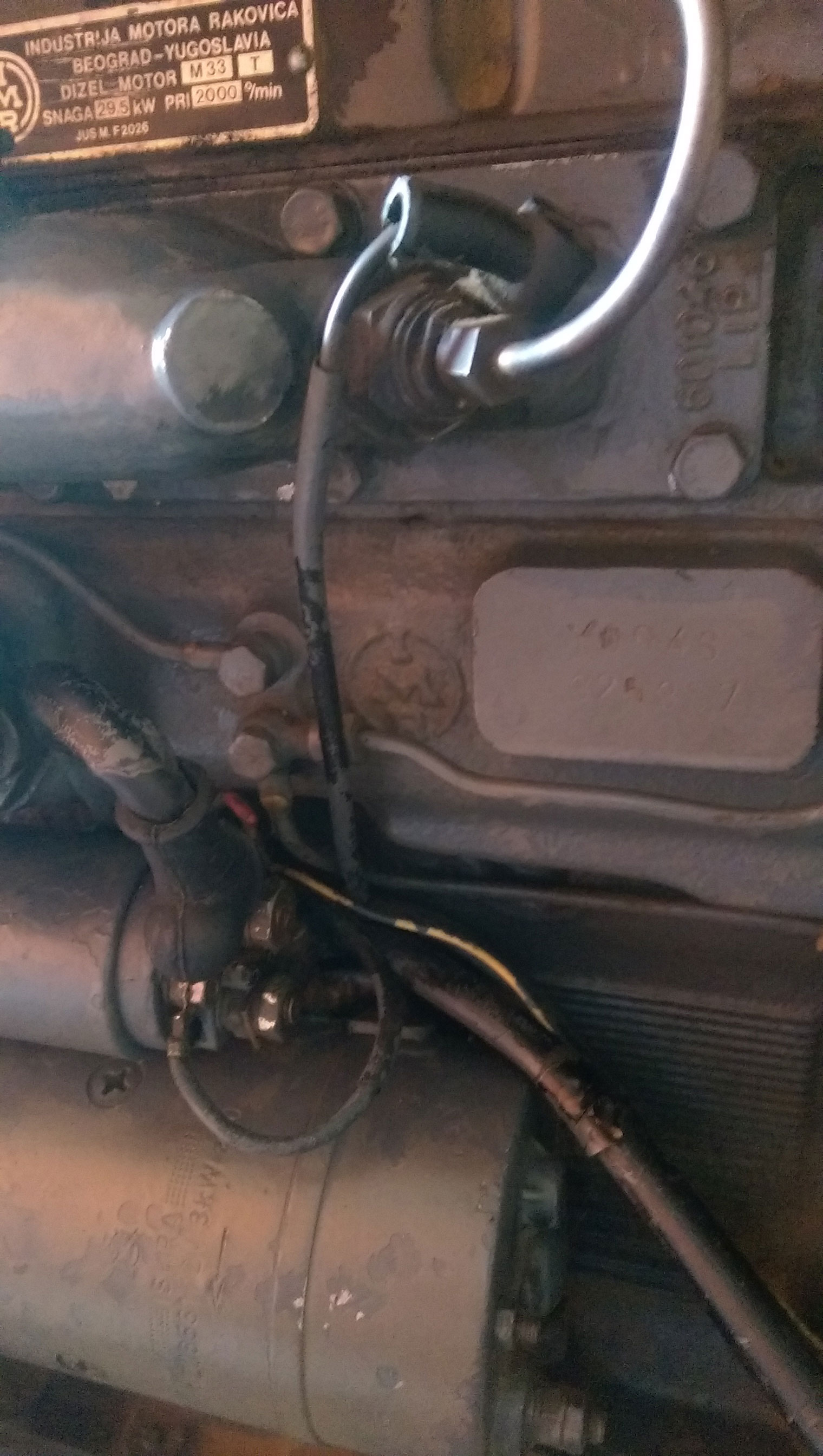

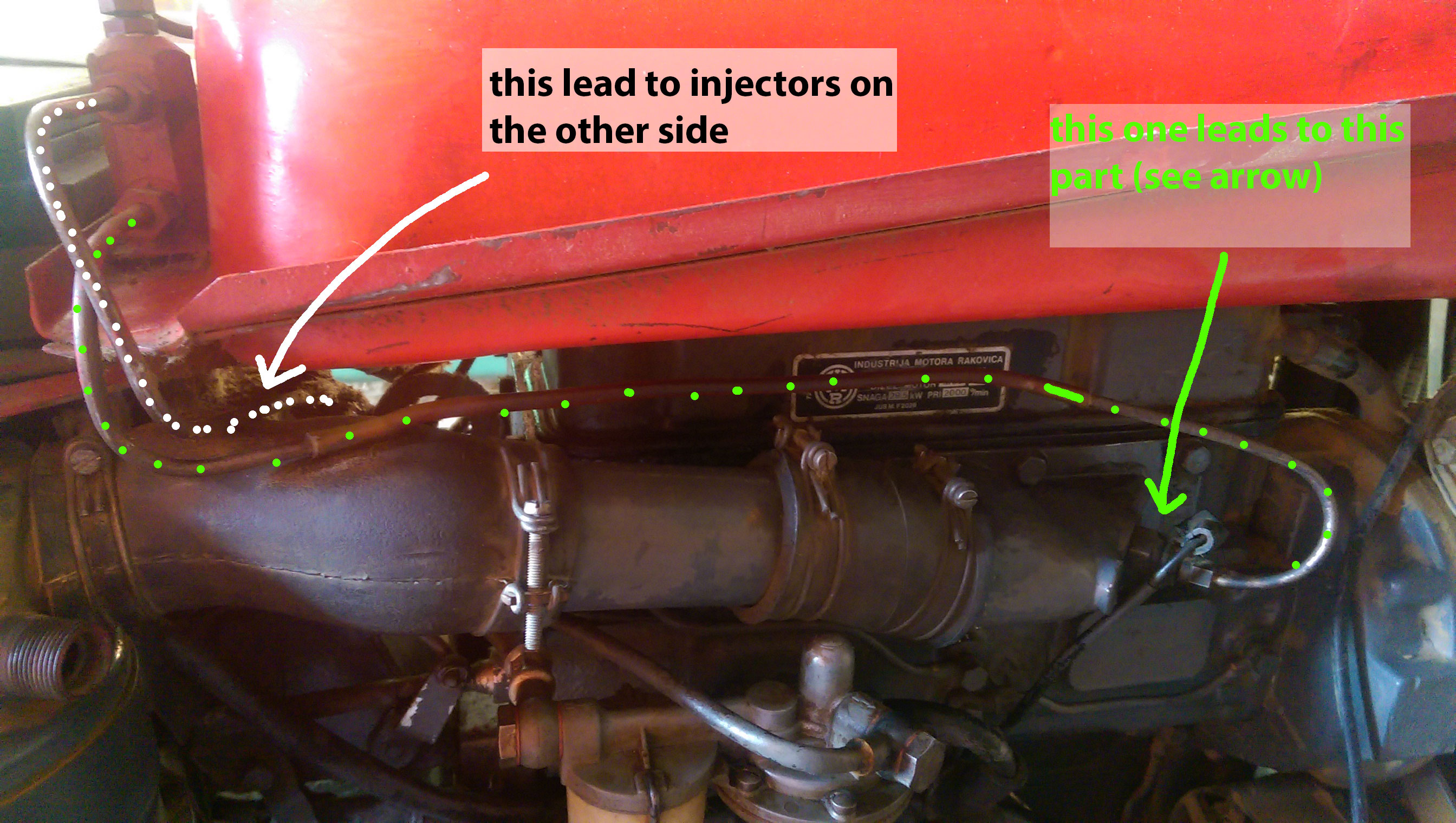

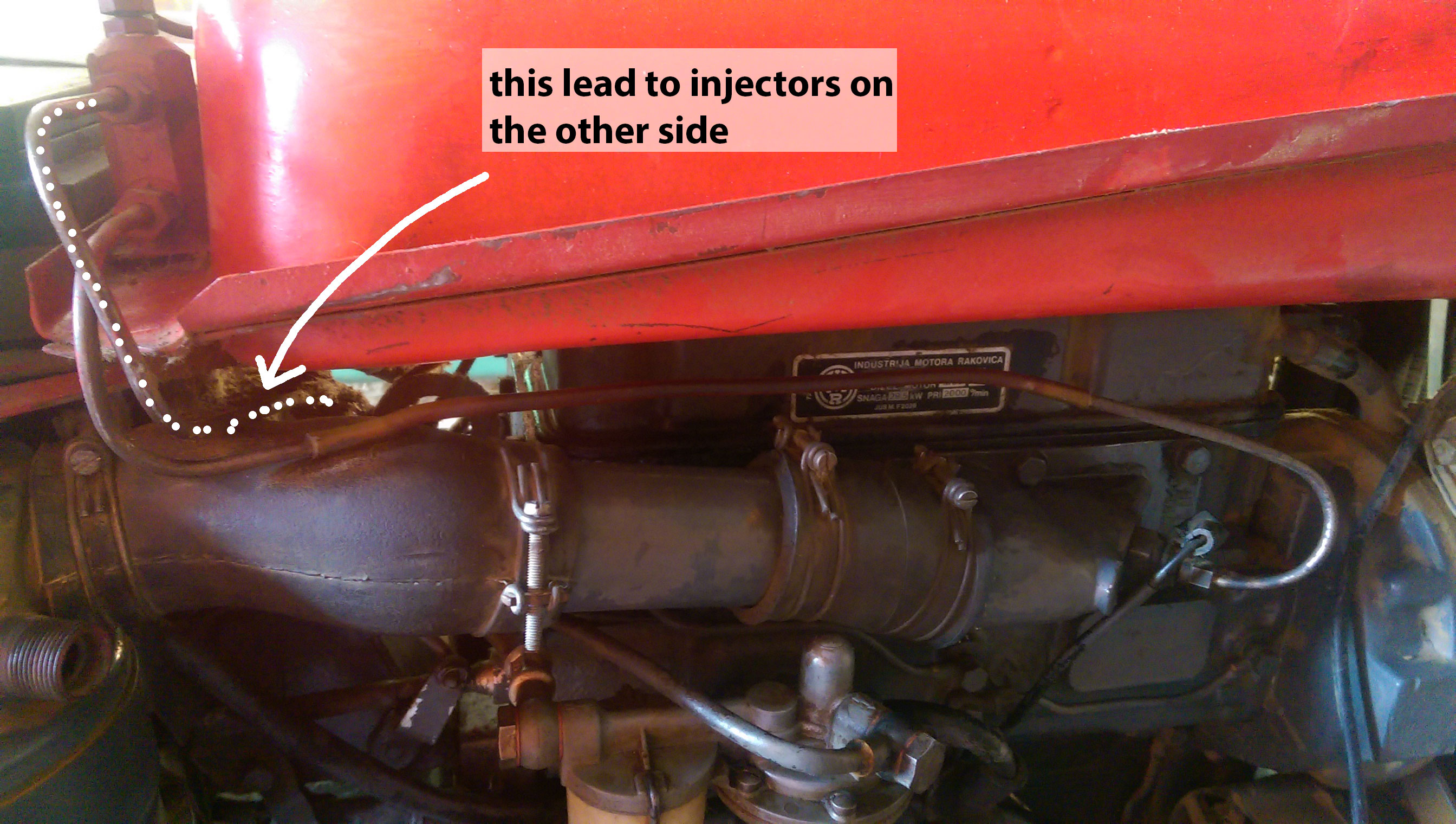

If its a CAV pump/system.. some of them had a cold start devise the was screwed into the air intake pipe.. Called a thermostart..
The thermostart was fed fuel from the injection pump & was electrically controlled by the key switch..
They use to burn up all the time & the fuel would still drip into the intake pipe.. causing massive amounts of smoke..
That's why I want the pictures of the intake piping & inj. pump..

My thoughts exactly here to. I reckon the heater plug is leaking internally into the air and on into the head.
OP when you start it at first is it very smokey?
Worth taking out the heater plug and out a bolt or something in the threads and start it let it run for a while so any diesel in the head will burn up. Then try it again when the engine cools/next day with the plug still.out
   / Ferguson excessive smoking #20
That is a good point I didn't think about....makes sense that it could be leaking.
No biggie to test. I don't remember if it's a ス or セ" pipe plug. Get one and pull it out, plug the hole and run it with it out where you can see if it's leaking. If you want to run it while it's out to see if the heater gets hot and it starts slobbering you need to ground the case good....pulls pretty good amps when heating.
You can pull it out and stick your finger in the manifold. If it was leaking you'd have an oily mess under it. Course there could be some oil residue left from when it was operated. Worth a check.
