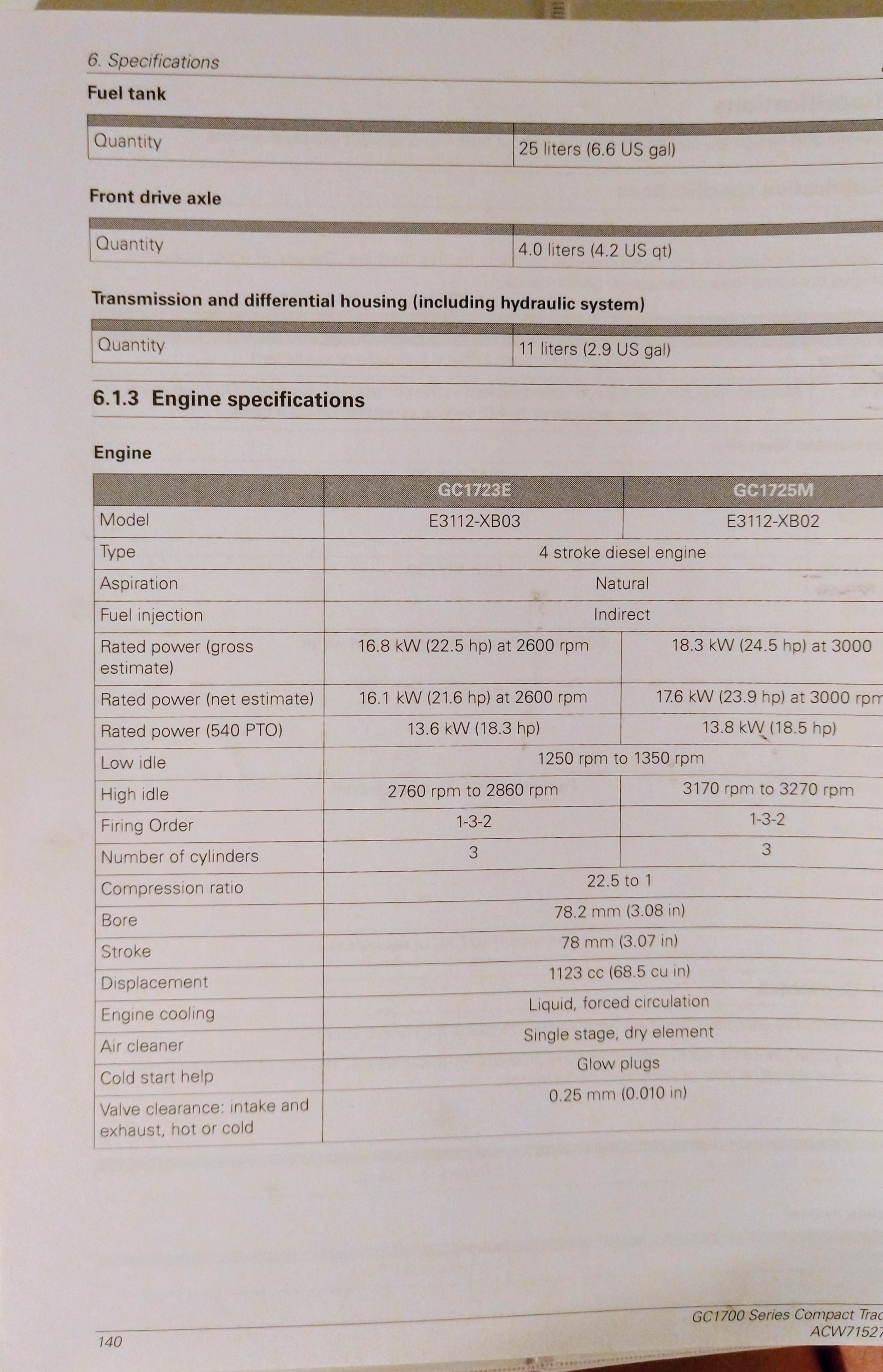

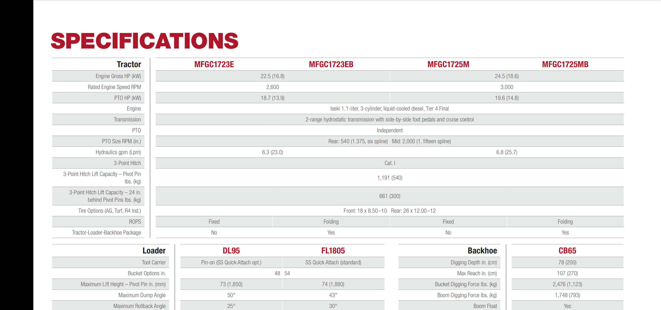

My point was they seem to be the same engine, adjusted differently ... From the sales brochure ...
But looking at the owners manual, it seems to have a slightly different number ...
But in the service manual under the engine category, it makes no distinction about them being different ... ?
I agree, it's the same basic engine. There may be some tuning differences in the injector pump to "detune it".
BTW, the trannies have slightly different gearing. I assume that is to let the engine run a tad faster at the PTO speed(s).

Curious what engine RPM you need to run to get PTO 540 RPM?
I'm just a tad under 2900, which is past your redline ...
The rear PTO (540 rpm) is at 2532 rpm on mine versus 2829 on yours.
The mid PTO (2000 rpm although the service manual [page 1-29] incorrectly says 540 for this too) is at 2476 rpm on mine versus 2947 on yours.
I have never used either PTO.

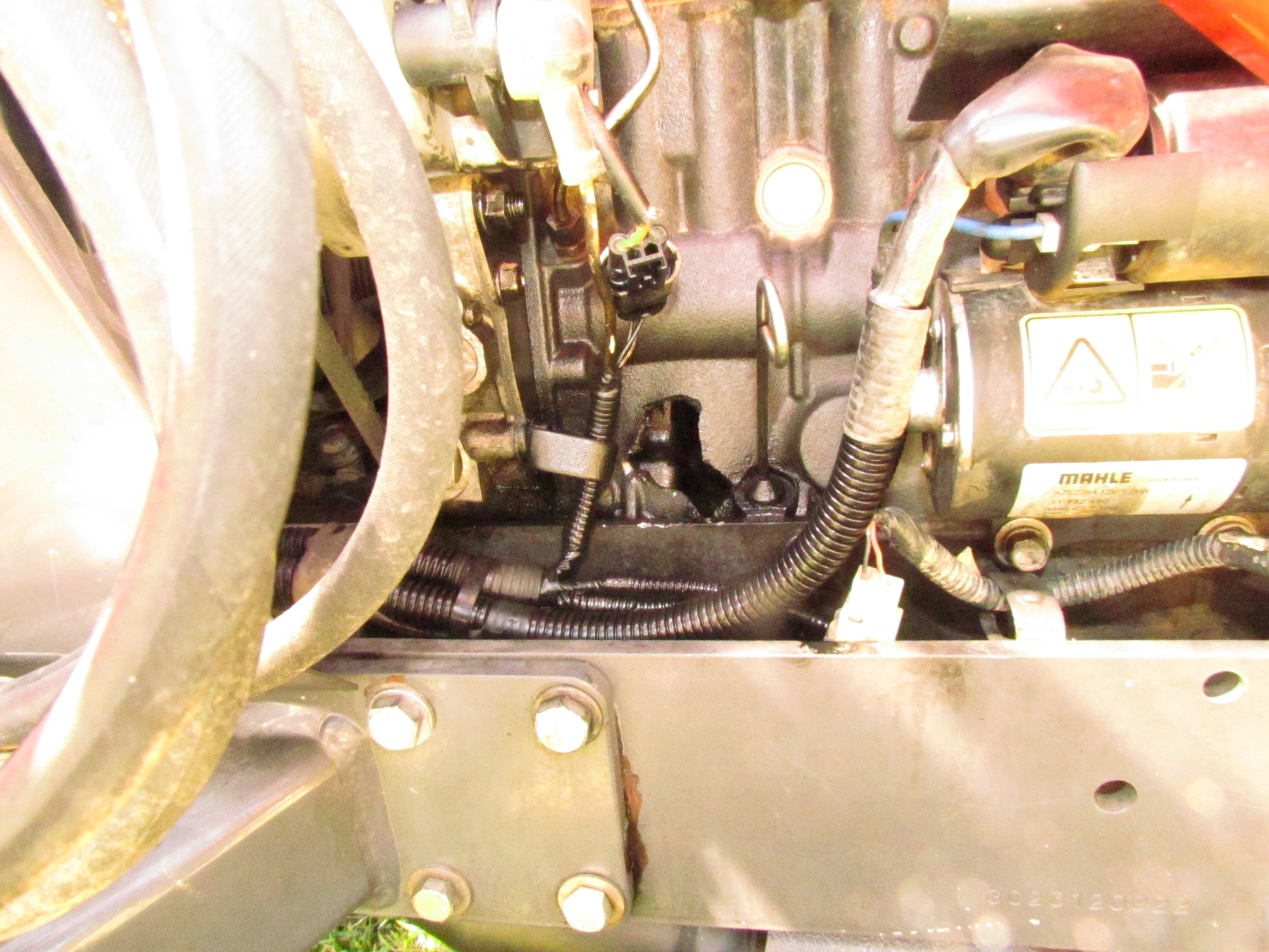

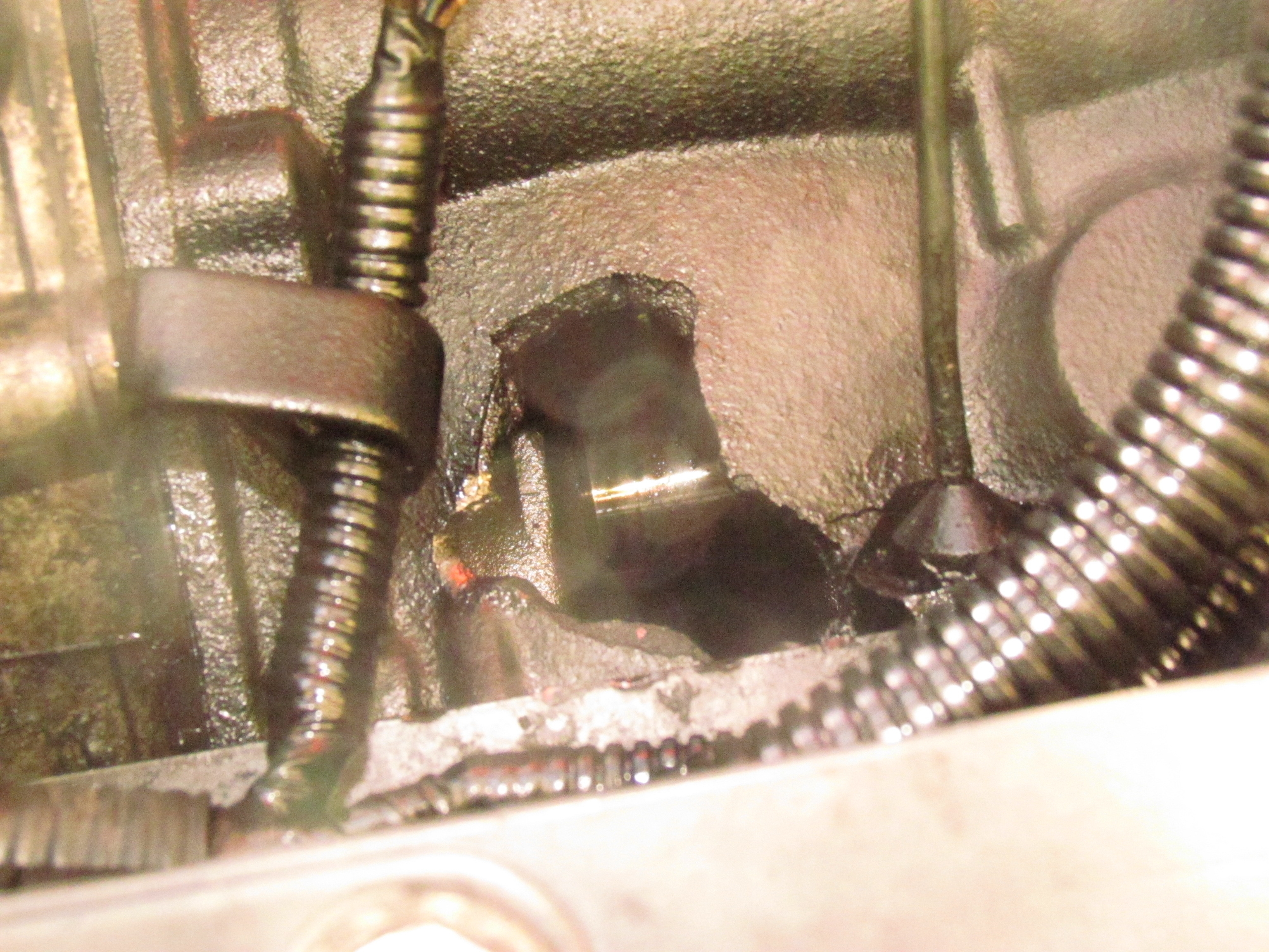

quote from I do cars presenter: "...after market inspection port"... when refering to holes in the block.
I to have had a big end break off and exit. Big end bolts failed. Picked up a piece of the block and rammed it between the piston and cylinder and stopped in 3/4 of a revolution.
/ Fergie's in ICU #49
Any more info from the dealer who's tearing the engine down? They actually might not spend any time tearing it down, and just replace the whole thing to save labor costs. Then ship the blow engine back to the factory for inspection and anaysis.
/ Fergie's in ICU #50
I sure wouldn't, if it was my dealership. Beside simple curiosity about the failure mode, there is no incentive to spend time paying your technician to disassemble it. Nothing reusable inside that deceased motor. But Massey might not even allow the dealer to tear it down.

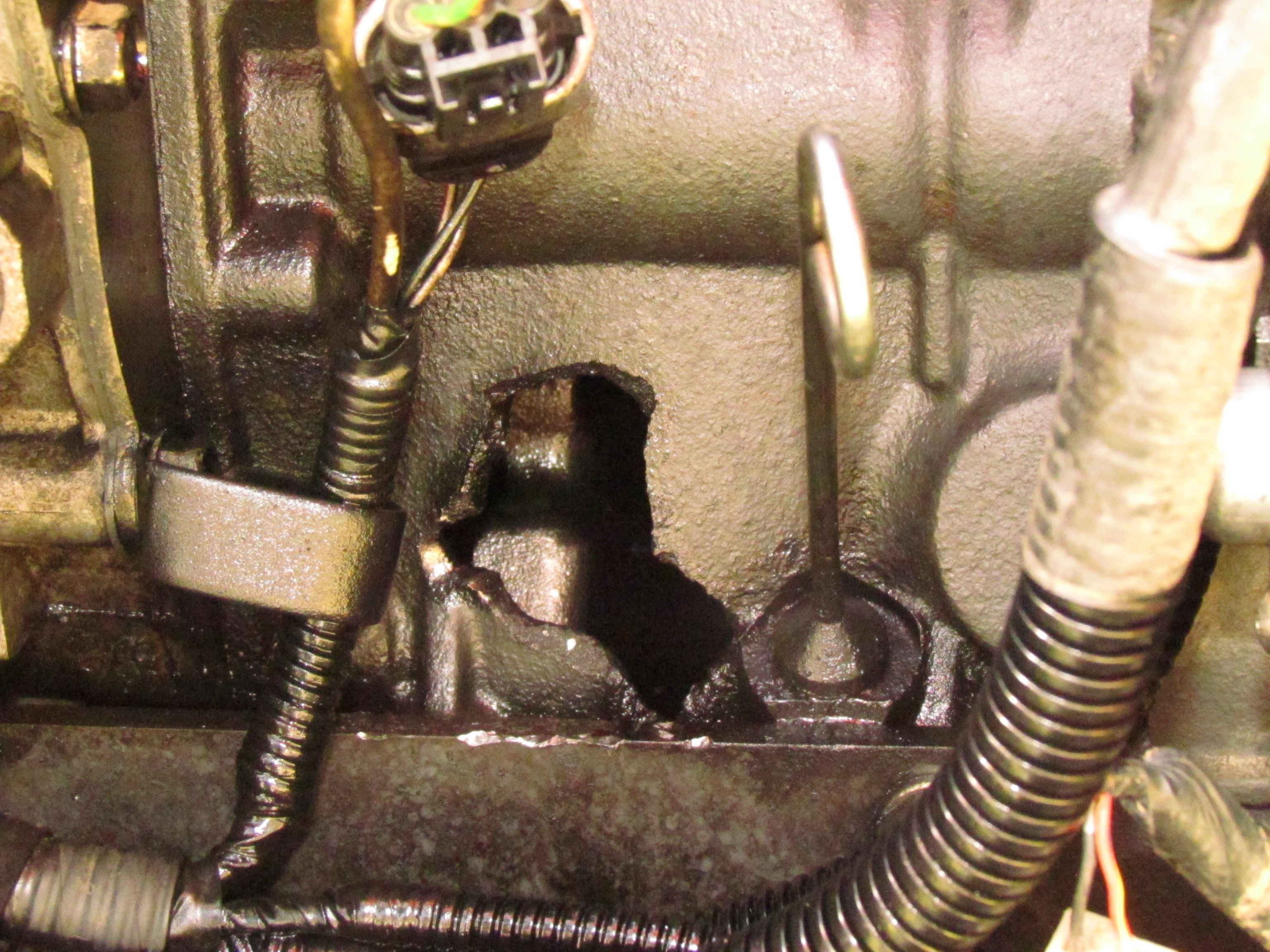

first post shows picture of hole in block...

I'd like to give you a nice update on this but we're not getting anywhere with this so far. The mechanic "started diagnosing" it last Tuesday and filed a claim with "the warranty people" but has not removed the engine. The service lady thinks he may have "poked a camera in it" but isn't sure.
/ Fergie's in ICU #60
may have poked camera in to take pic of rod ends to send to warranty dept. prob can't touch it much until they get the go ahead.
