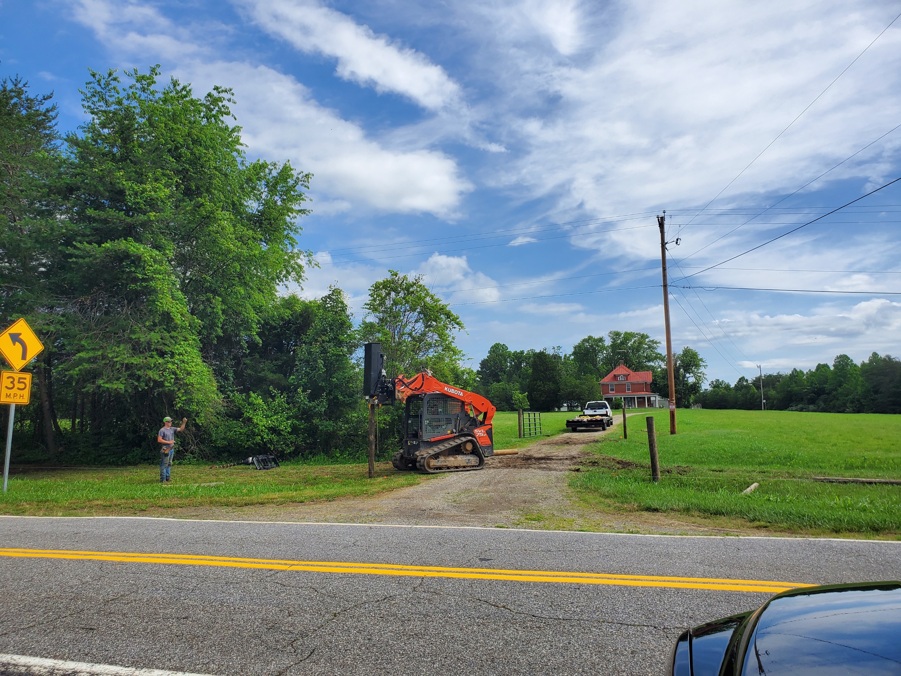

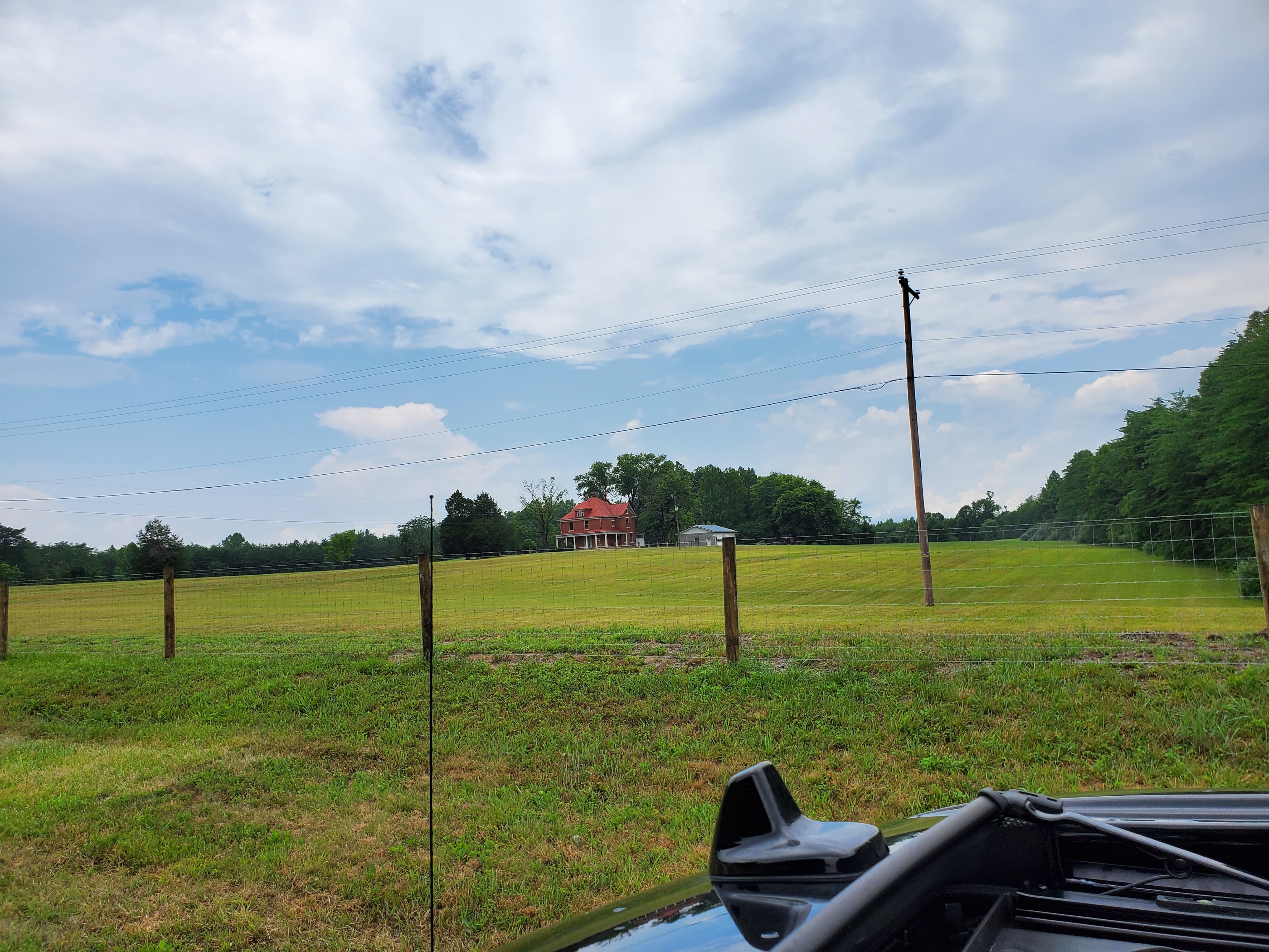

I just had about 700 ft of wire fence put in and the guy pounded all of his poles. 6" diameter, 8 ft long pounded to 5 ft. Solid as a rock when he was done. We used Tornado wire, nice stuff.
