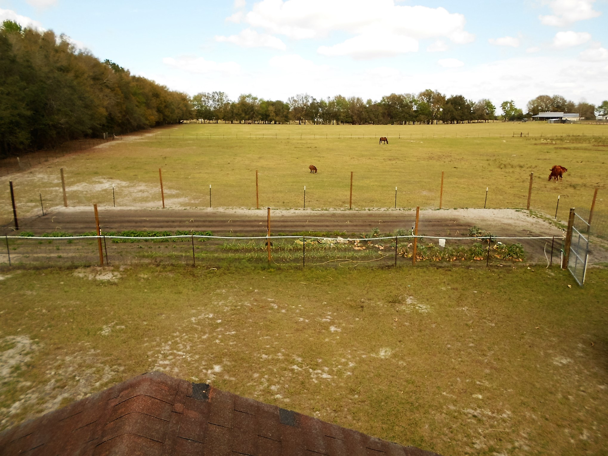

Here is what I did for my garden, field fence with 3 strands of barbed wire 8' total.

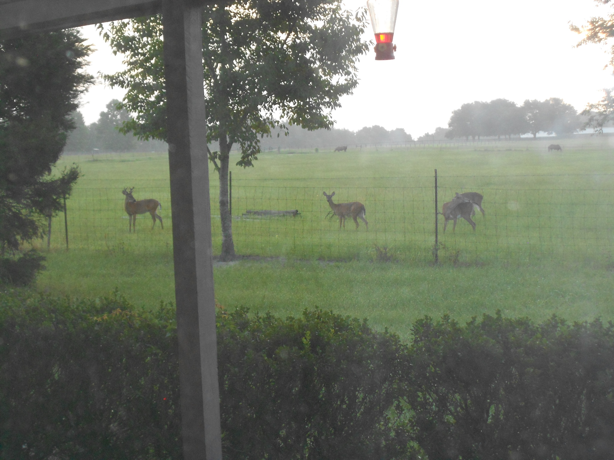

I took deer pic out my front window at my pasture, 3 Does and a 6 point! They are small down here.
