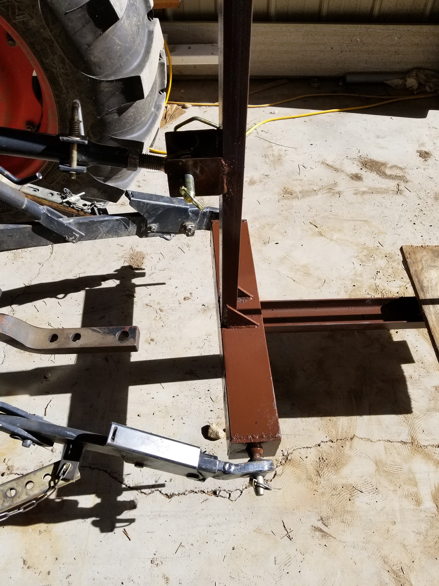

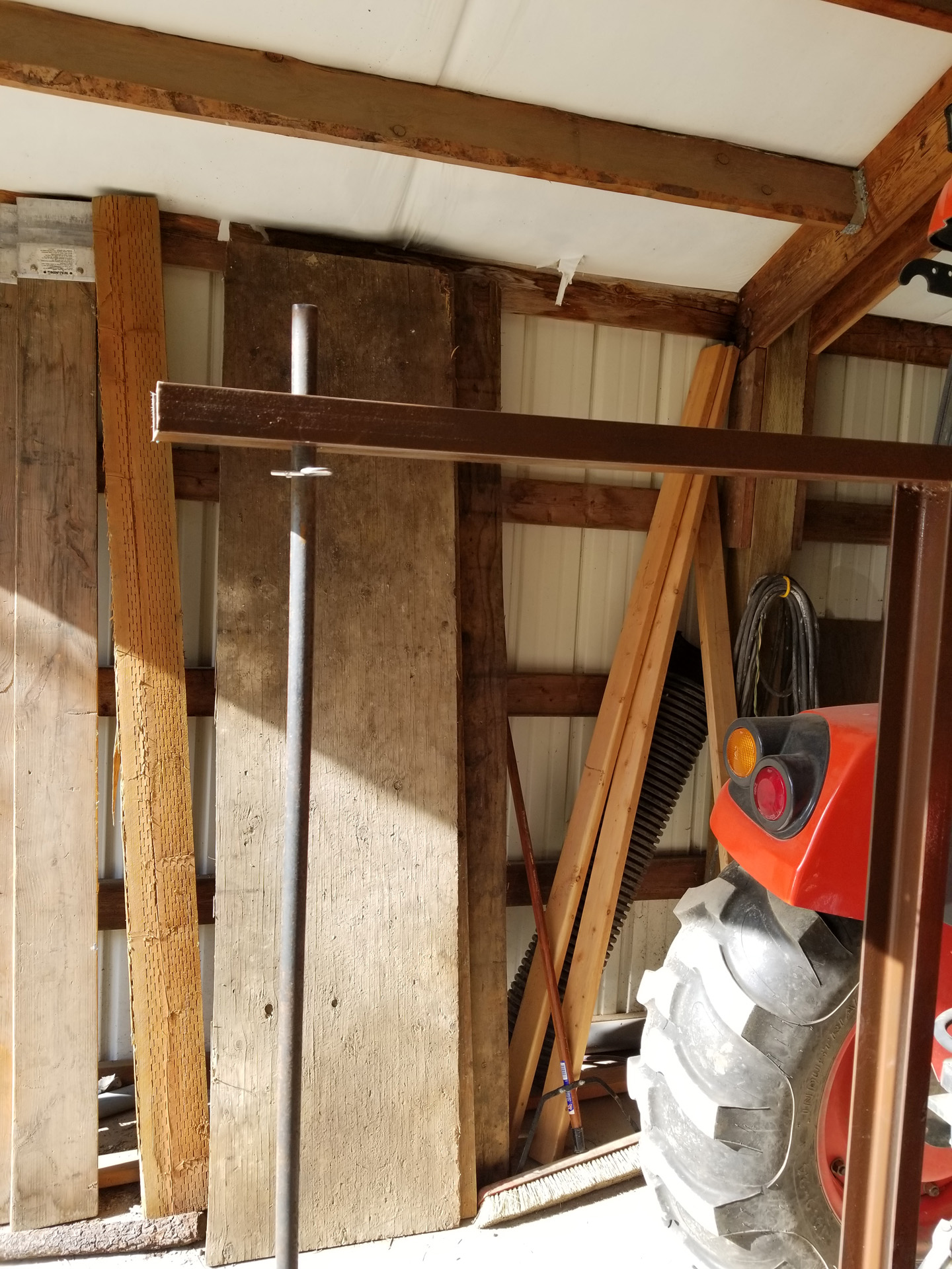

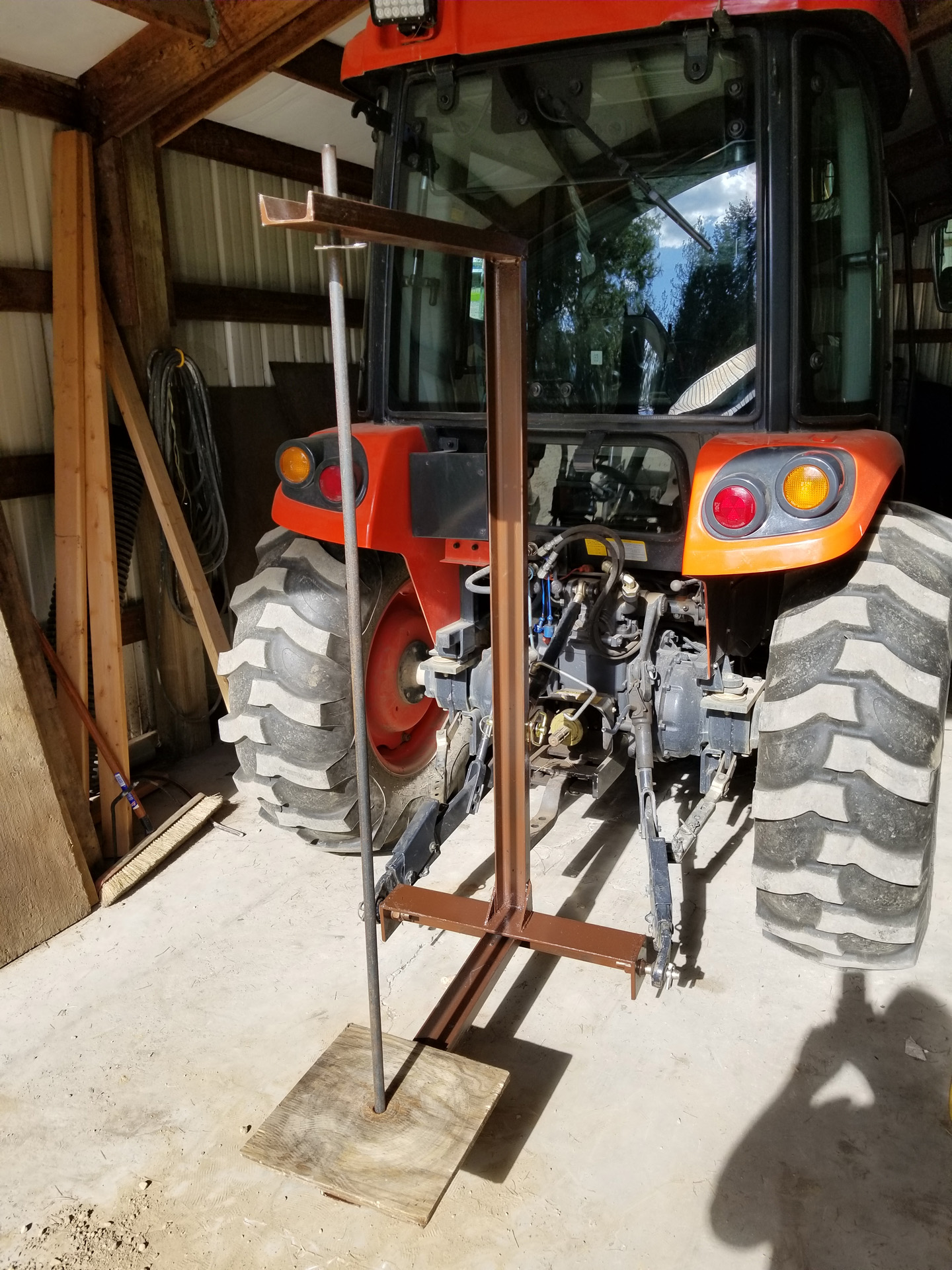

Clearing the fence line and setting posts you can easily do yourself. For T post holes make a sturdy spike that can be driven in with the loader for the hole and then insert the T post.

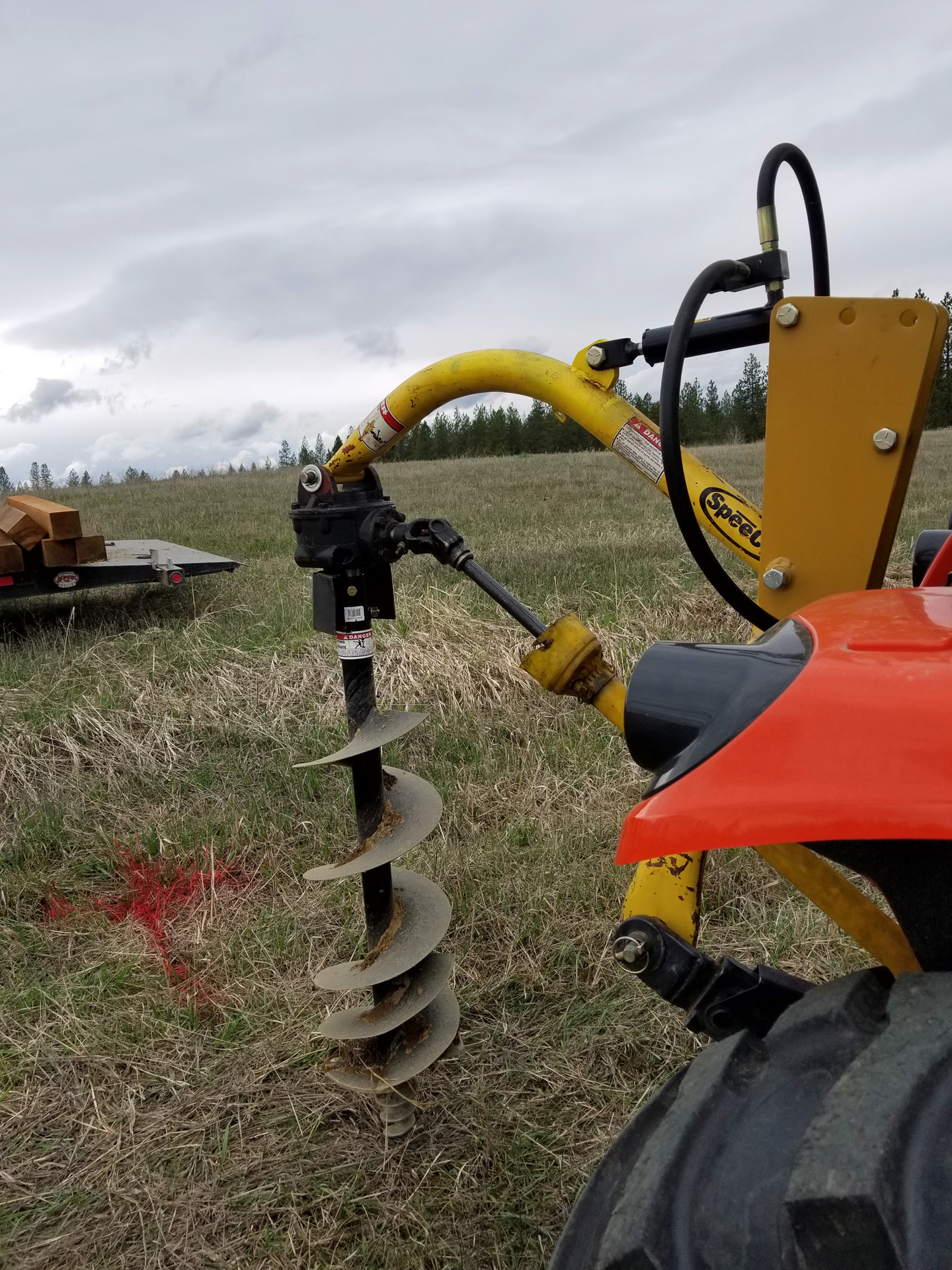

All you need is a 3 point auger. With 8 tip for 4x4 post or a 12 bit for 6x6. Ive fenced and cross fenced my 30 acre property and was not an issue. As for the wire unrolled, I built my own for about $60.00 in parts and an hours time. If you can't fab one, a welding shop can or plan on spending at least $600 for a factory unit. You can use the tractors pull strength and a chain to tighten fence. I use a manual post pounder and wait until after spring thaw to set t posts. Those hydraulic units are very heavy and awkward to lift over posts and to remove in my opinion. Ive used them to set posts in past, and in my humble opinion wasn't worth the effort. A fence grabber to hook fence to tractor was made with 2 pieces of angle iron, 3 grade 8 bolts and some scrap rebar. fence 1.jpg pull tight 1.jpg pull tight 2.jpg in use.jpg 20190507_164431.jpg 20190507_164421.jpg 20190507_164413.jpg 20190419_131746.jpg

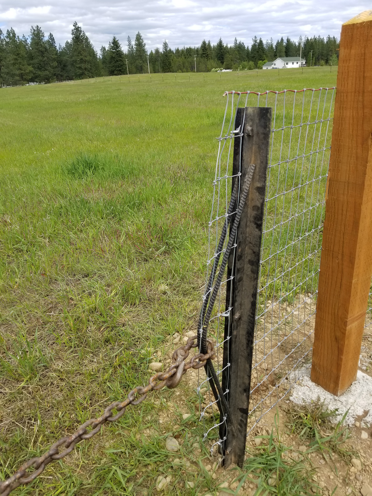

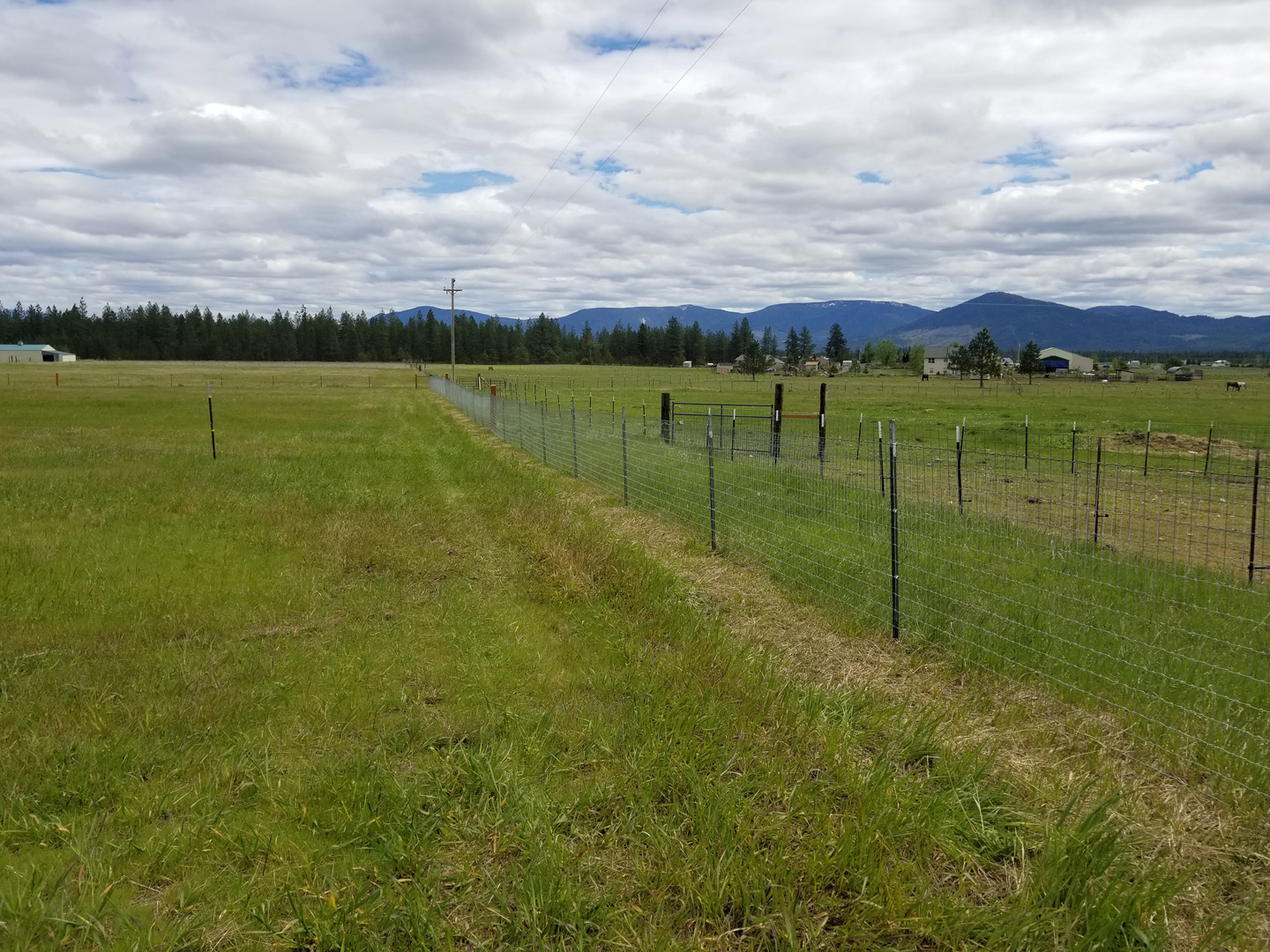

I would say the biggest question is how much the land needs to be cleared. To put up a fence you basically need the equivalent of a road. If it's just overgrown with brush you may be able to clear it with a tractor and a rough mower. But if it's gotten woody -- if you have to dig out stumps for example -- that's no work for a tractor, that's for a bulldozer or skid steer with a mulching head. That's a one-time job though. Once the fence is built you're going to have to keep it from getting overgrown again, probably the easiest way is to spray it with roundup. So budget for a sprayer. Unless your livestock can keep it clear.
I've put up lots of woven wire fence, I'm partial to the Kencove sheep and goat fence, 48" tall with 4" squares. I use 6' T-posts, put them in 18" with 6" showing over the woven fencing, then run a single strand of electric along the top of the posts. That makes the fence harder for goats to jump over and also keeps the animals from going up and pushing on the fence.
My construction process (and this is not something I invented, there's lots of videos on Youtube) is I make a corner out of wooden posts which I put in holes made with the auger. I attach the woven wire to the end post by wrapping it around the post and tying it to itself using a fence bending tool. Then I put the roll of fence on an unrolling attachment I got at TSC, and drive toward the next brace. If the roll runs out I splice it to a new roll using a crimper and keep going. When I get to the next brace I drive about 30 feet past the brace and then tension the fence. I use two come-alongs hooked to the tractor, and hooked to the fence by two pieces of 2x4 with bolts squeezing them together. I don't use the tractor to tension, the woven fence doesn't have a lot of give and I've pulled out corner braces by pulling with the tractor. I like the finer control of the come-along. When I get it the tension I want I start doing t-posts. Pound and tie. A post every 10 feet, and four ties on each post -- top, bottom and 16 and 32 inches. After a handful of posts I can see if the tension is right, if not I adjust it, then attach the fence to the brace with staples. Repeat until finished. When you get to the final brace tension the fencing as for the others, then one by one cut the horizontal wires about 18 inches past the post, wrap them around the post and tie them to themselves.
If your fence is just a rectangle, it is going to have some long runs -- 60 acres could be 2200 by 1100 feet. (It would be helpful if you told us how many feet of fence you're contemplating.) At some point you're going to hit the maximum length that can be tensioned at once. The Kencove fence is about a pound a foot, so a 2200 foot run is over a ton, you're not going to be able to pull that with a come-along. So you'll need some intermediate braces, which adds to the work and expense. I don't think I've ever done a run over 500 feet without hitting a corner or a gate so I don't know how long you can go.

A tractor mounted hydraulic post pounder will out produce a post hole auger unless you have alot of rock, you can put your corners and your steel tee posts in with. No concrete or packing dirt or rock into holes will be needed and it will be twice as solid in the ground. Shaver makes a really nice one, kencove looks to be built the same and you could be in either brands 8" driver for under $4000.
For what its worth if I was bidding pounding your posts you would be money ahead to buy a driver.
