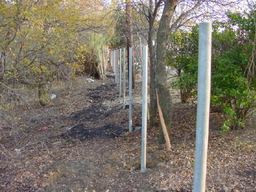

Here's another view.

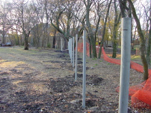

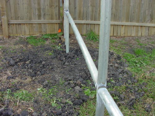

Looking west.
I like to put a center brace at the corners. With the schedule forty pipe it isn't necessary. But since I'm the only one that I know who consistantly does it, well, I shall continue, on principle of course.

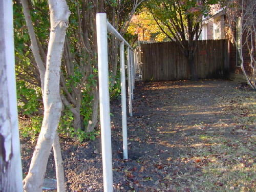

   / Fence project #34
This is looking down the interestingly tight section. It was a bugger bear to dig. It wasn't fun to weld in. And I look forward to putting in the wire like getting a root canal.

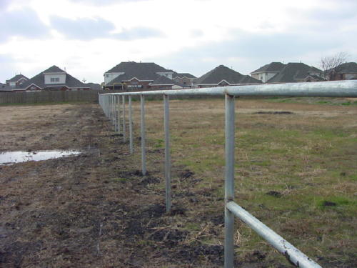

Looking back from the other end at the interesting section.

   / Fence project #36

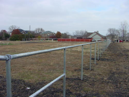

I've got about a hundred and fifty feet to weld in and then it's time to put up the wire. One of the things that's different about the way I do it versus the way it's commonly done around here is I put all the work into setting the posts in line and set for height. Then when it comes to welding it in it's just a matter of laying in the pipe and it's ready, all fitted up and with a joint even Ray Charles could sew up. The only cutting is done to so that all joints in the top rail are over a post. I've seen lots of broken apart joints done by weldors much better than myself. So I cheat. I make sure the joint is not only welded but it's welded to the post, insurance for the insecure you might say.
This is the last leg. It's only about a hundred feet in length.

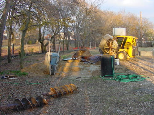

Remember this?
Check it out now after I've put most of those twelve yards through the mixer and then into holes in the ground.
