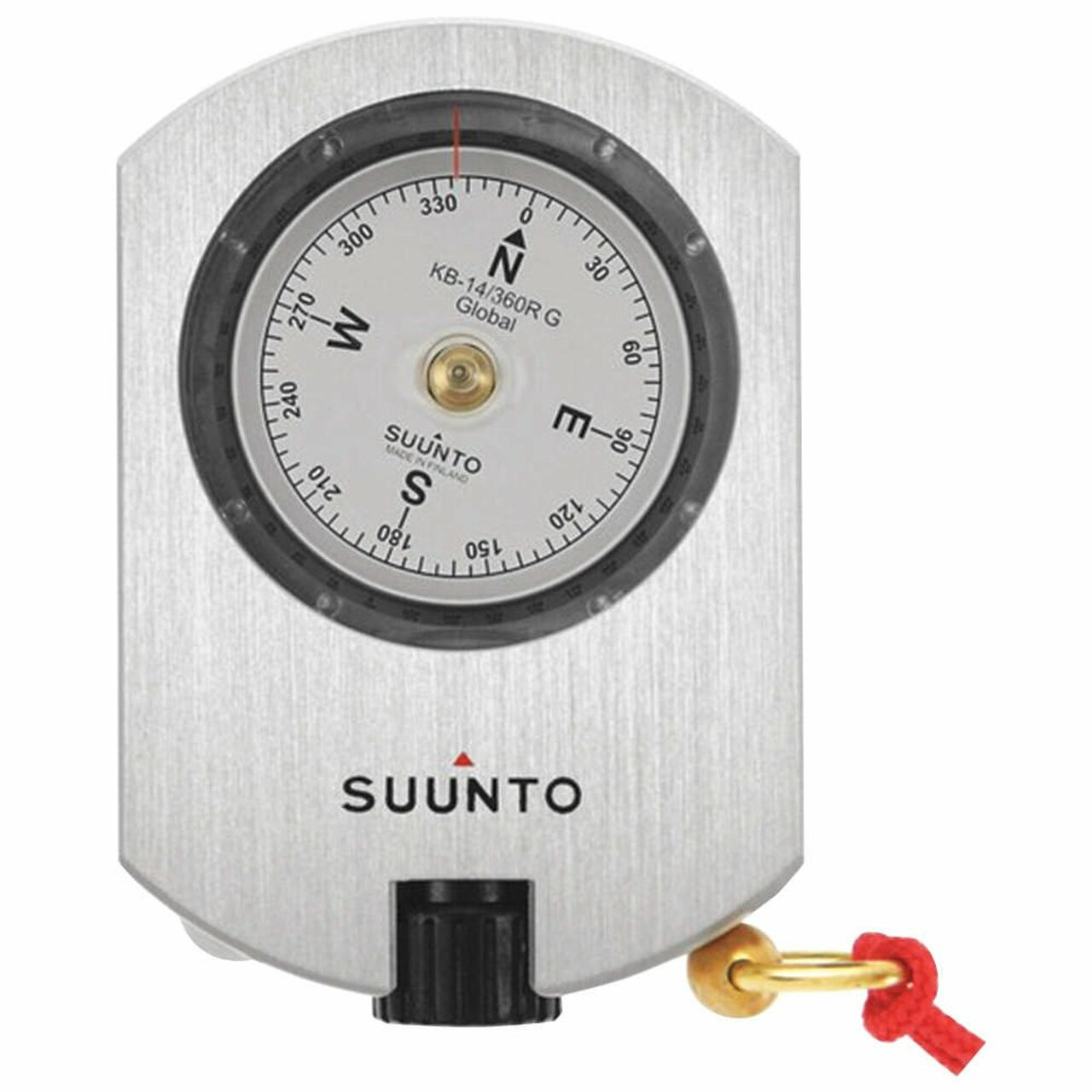

When I would help on a cave survey we did fore-sight and back-sites and it was still easy to screw it up. We used compasses like this. When closing a loop in a cave one little error gets amplified.
I used one very similar to that. You can look through the black thing at the bottom and read the dial while you sight what your looking at.
