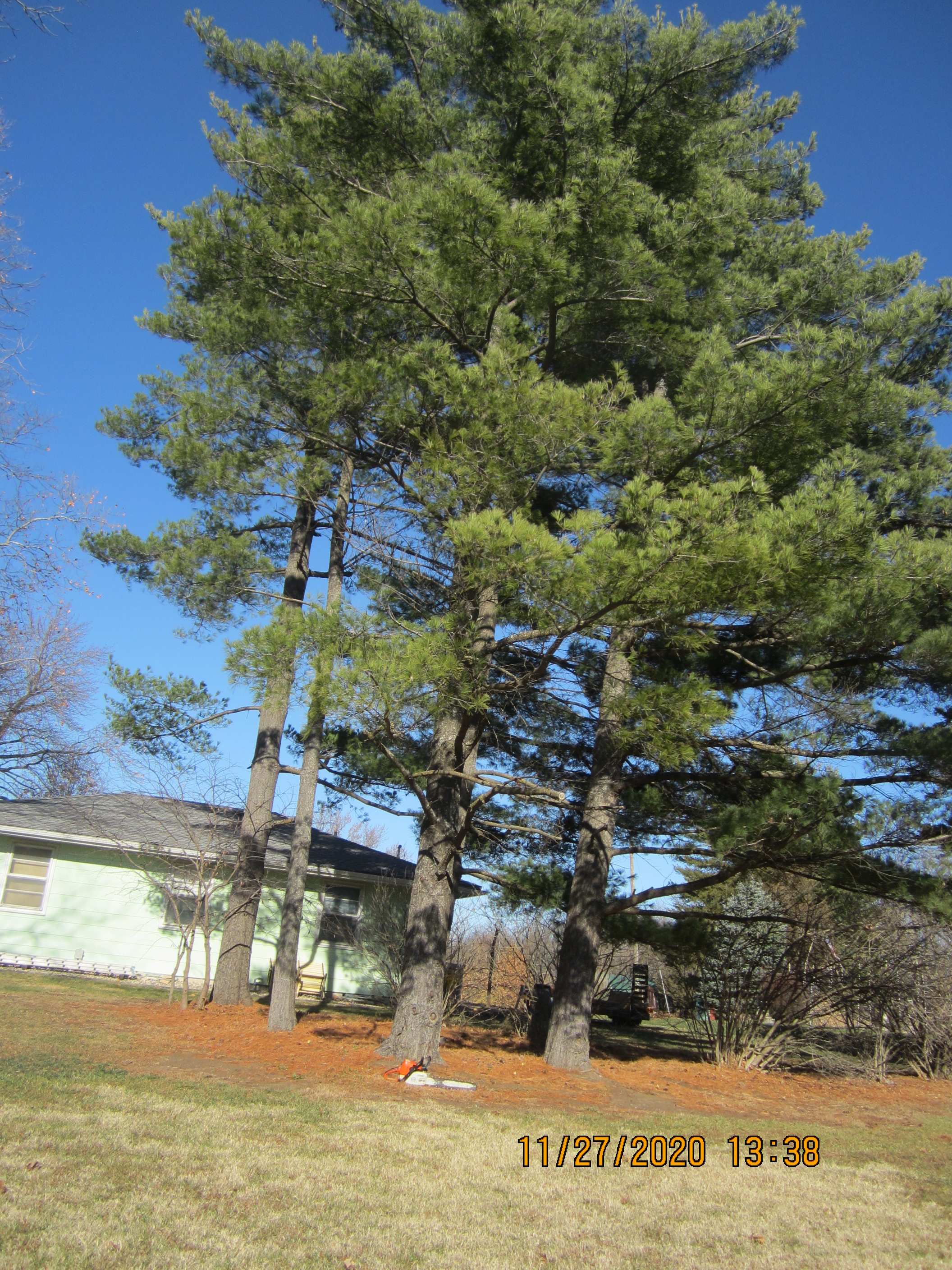

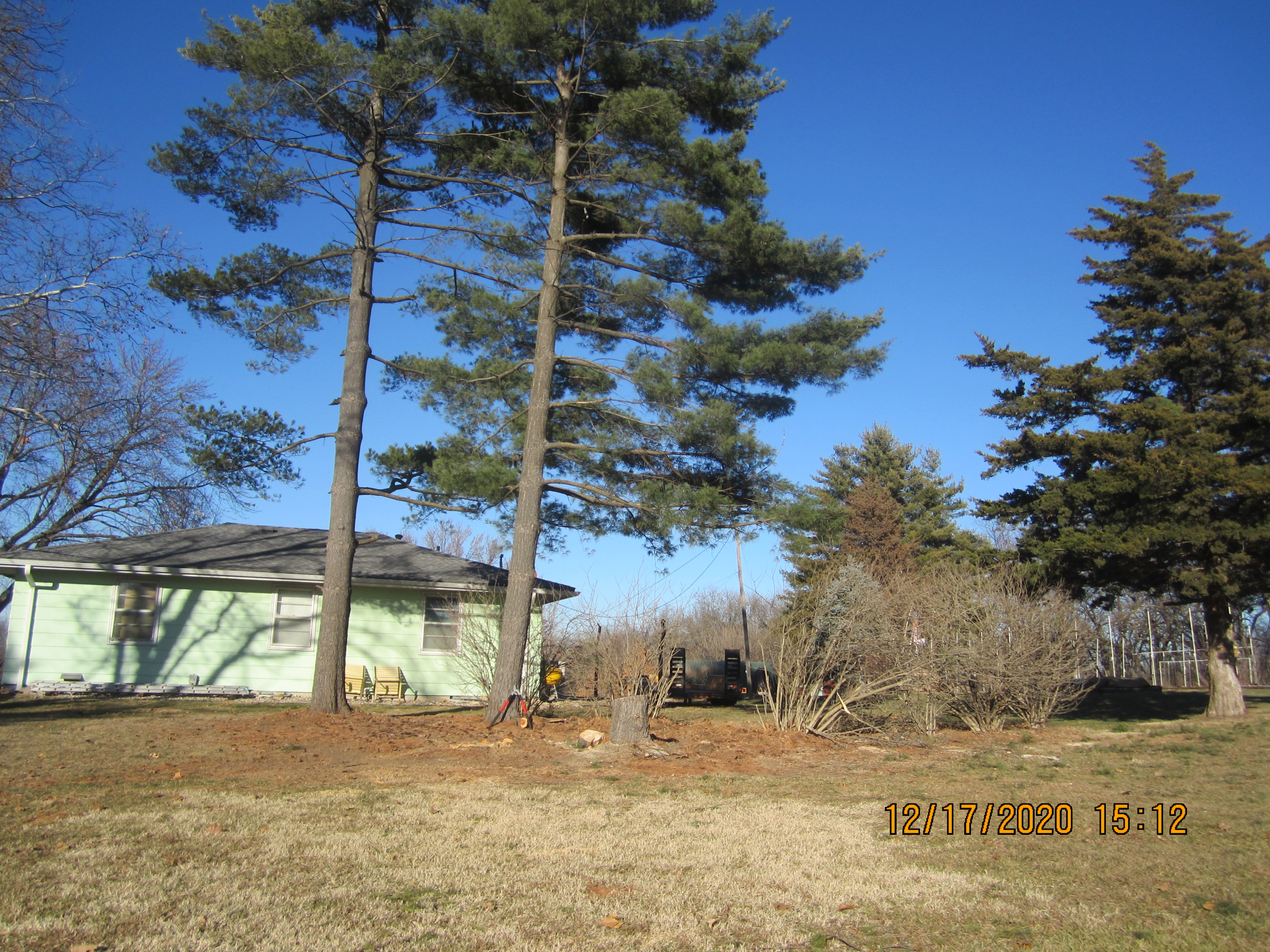

I have been working on a group of five White Pine which are about 80 feet tall. So far I have dropped three, but the last two are leaning toward the house with a lot of top growth that way also. I may chicken out and hire the pros to do them.
Cheers,
Mike
View attachment 682475CONFIG]682472[/ATTACH]View attachment 682473View attachment 682474
I've been running saws and falling trees since 1968. Only once did I try a "hazard tree" (one that will do serious damage) Large Black locust about 30" butt diameter, slight lean oveer a trailer house (occupied). Rigged to cable from anchor to pulley about 15" up the trunk and back to and anchor tree gives a 2 to one mechanical advantage. Loose end of cable to my comealong which works from come-along to a pullet with hook attached to the cable from the tree. Anohter 2 to 1 which combinded gave a 4-1 pull on the tree, cable from truck to pulley on achor to the comealong. Did my normal felling cuts to pull it 180 degree from lean. First attempt at pulling it only gained a minor amount, mostly slack in the rigging. Cranked on come-along, pull - nothing, deepen cut, pull - nothing except gain a little on the come a long each pull. Finally asked the people to leave the trailer house as i was sweating blood over a total failue.
They refused. Repeat the deepen cut, pull, crank on come along, pull. It finally went where I plannedf but I worked on that thing for at least a half hour. Never again.
I have also called pros to take down 3 trees so far around my house.
