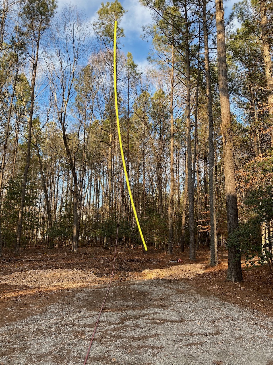

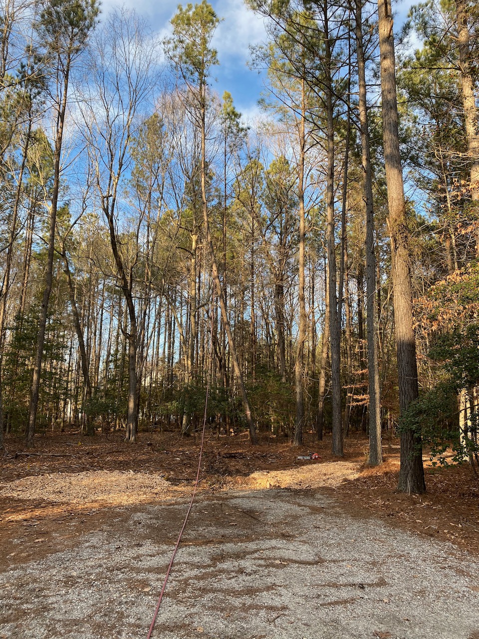

So today I finally took care of a tree I had been meaning to tackle for a long time. It had about a 20-25 degree lean on the bottom and then curved to vertical. Due to some desirable trees in the direction of the lean, I didn't want to do a normal Coos-Bay cut and drop it that way (for those not familiar, the Coos-Bay cut avoids a barber chair situation). So I used a more obscure (and risky) method to drop it to the side of the lean. This doesn't always work and can be dangerous, so you want to make sure you can deal with the possibility that the tree will fall anywhere in that 90 degree zone between the lean and the side. And you don't want to finish the cut with the saw, you want to do it with a pull while out of harm's way.
Here is the tree, highlighted in yellow in the 2nd photo:

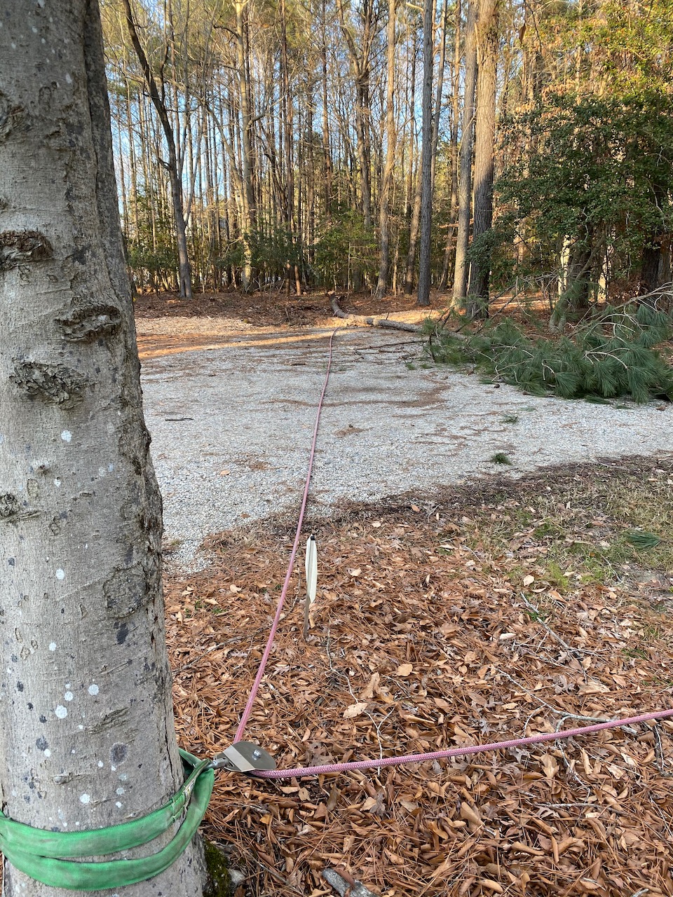

I got lucky with my throw rope and snagged a small broken limb high on the tree, and was able to attach my bull rope about 50' up the tree for very good leverage. The rope ran down to a big beech with a pulley, then turned 90 degrees to my driveway where the tractor was (safely out of range).

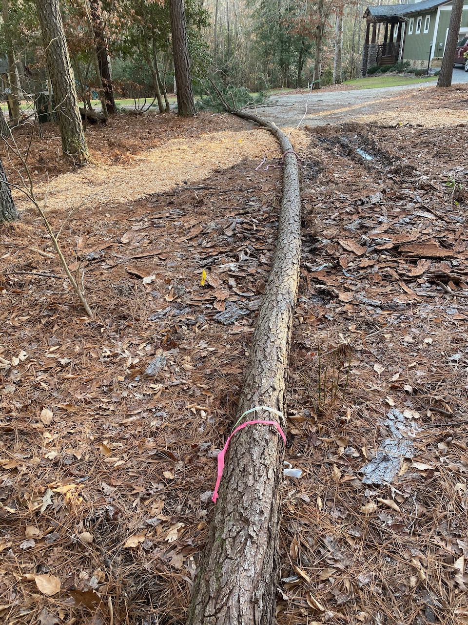

I made a shallow "open" face cut, then an angled back cut that left a wedge-shaped hinge. Then I got the heck out of there and pulled on the tree with the tractor. The cut worked extremely well, and the tree dropped perfectly to the side of the lean (it almost never goes that well). Here's that big skinny banana of a tree on the ground.

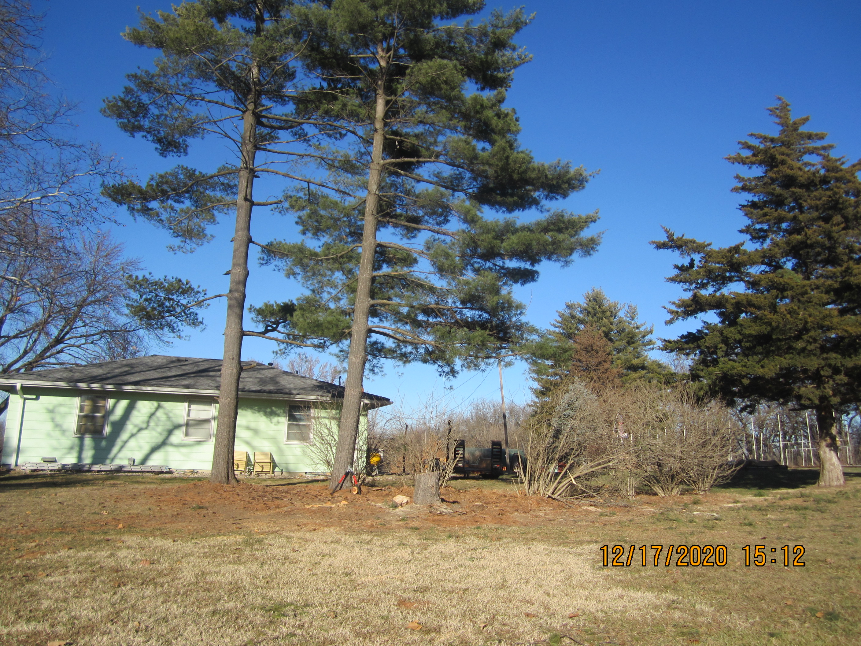

Thanks s219,
I have been working on a group of five White Pine which are about 80 feet tall. So far I have dropped three, but the last two are leaning toward the house with a lot of top growth that way also. I may chicken out and hire the pros to do them.
