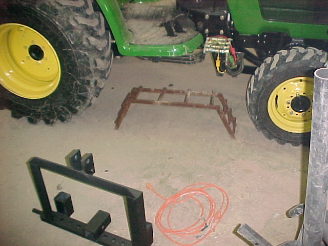

This might be of some interest to mid mount mower guys. I had a JD 755. I sure got tired of wresling that 350LB hog all the time. I built a set of ramps that fit between the front and back tires, angled legs and the ramp just cleared the top of the mower, lock the font axle in gear and drive on and back off. worked slick!

Dana,
Can you post a photo of those ramps. With the tractor on would be great if possible. I'm having trouble visualizing.

DDT That sounds like it would be handy, but I can't visualize how they're constructed. Could explain futher or post a photo?

I agree; need a picture or drawing /w3tcompact/icons/smile.gif. I've tried to come up with something like that but couldn't think how to drive on, disconnect the mower, the drive off.

OK, I have traded the 855 on on a 4300, still have the ramps so I'll need your help to visulize the mower deck.

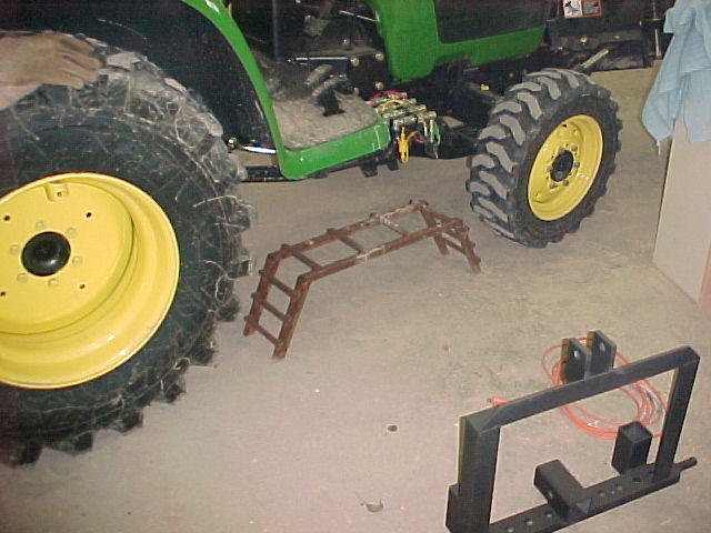

my ramp is 6" wide, the width as the front tire. ramp frame made out of 1"sq steel and cross bars are 1/2" rebar every 4".
I made this to fit a 755 with a 60" deck, it just fits over the deck, height and lenth. ramps are tight getting in and out but it works with practic. the angled legs can only go as far as your tires are apart. the 855 is 6" longer frame so it work real nice, enough room to get it in place.
direction's to unhook-
put mower on the ground
unhook PTO & all linkage
place ramps in place
you will need 4x4 lock in
back off
your free & gone
I hope this makes sence

DDT,
Let me paraphrase to ensure I understand...You are lowering and unhooking your mower so it is laying free on the ground. You are then placing your ramps over top of the mower, then backing up onto the ramp (basically on top of the mower) and then off the back of the ramp leaving your mower sitting on the ground with the ramps over it.
Is that correct??

Kevin
You are right!
I did find out that R-4's work better than turf's for crawling the ramp.
