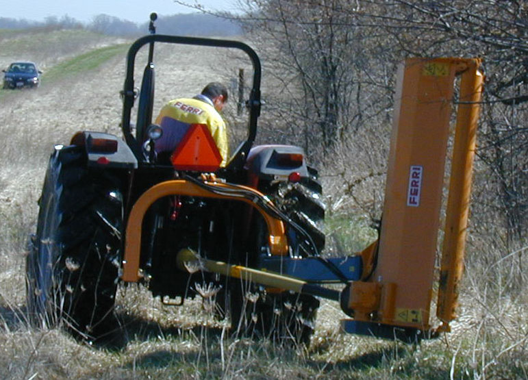

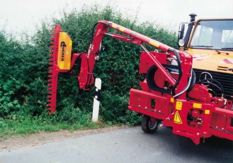

Given the miles and miles of roads that must be kept open, you would think,,,,,,,, that if driving down a road with blades spinning, would work,,,,, that it would appear more in Google images and YouTube. Maybe everyone's seen the county road dept's flail mowers on articulated arm (on a backhoe or excavator). Search google images for "road side brush cutter" and "fence line mower". Some examples, but nothing like that helicopter scythe.
Anyway I think about this a bit,,,,, because I maintain ATV trails, and snowmobile trails, snowboard runs. In my case I don't want shredded bushes next to the road or trail, because over the years it becomes a mass of ugliness that requires more "work" to get rid of. But because it's flailed, shredded, it can be "soft, sort of "safe". But it looks over the top sloppy and ugly! - why would a guy even bother mowing below such ugly brush maintenance? Certainly that works for some applications though, if you just got to keep the road clear, and not for enjoyment.
I'd think indiscriminate straight line cutting would leave a dangerous situation with sharp sticks, that if you didn't walk the line, inspect, and remove, may even be a liability if not dangerous for your own bush-hogging. I certainly would not leave sharp sticks in the bushes for snowboarders or other recreationists to discover if they went off-trail.

This is private property and it is not in my yard, around my house, or my shop. Don't give a F$%&* about the "mass of ugliness". Just cut it again next year. Certainly no snowboarders or recreationists. Again this is posted private property. And to repeat I am not trimming trees around my house. I does not have to be pretty. Does not have to be spinning blades either. Just trying to come up with something that will do the job and not cost $$$$$$$$.
This last picture is a perfect example of what I am dealing with. Notice the mess hanging out into the clearing just in front of the tractor. It is almost a perfect solution too except I don't think it will go as high as I would like and also for the cost involved.

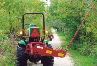

I bought one of the ditcher flails mower this year, not as good as picture by the manufactors does ok on the ground but once in the air to cut the side of you'r trail's leaves a scragly mess. no way it will take on the larger stuff you wish to cut anyway best just pick days with nouthing better to do and go after it with poe saw @ wheed eater with saw blade. Slagiatt

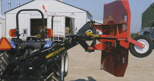

So I am moving implements around today..and I was pondering your challenge. I use a pto drive powered sickle mower with a belt to the bar..which allows me via hydraulics to angle the bar straight up for ( trimming low branches, hedges, limbs etc or go negative for banks...) then it hit me..can you do the same thing with the disk mowers like this? maybe hit up a metal fab shop for used metal cutting saw blades,, replace cutting disk with those? mount a stop bar a few inches in from the orbital tip of the blade to stop the branches from twisting around said blade. power it via hydraulics.. so you can fashion a quick attach to the FEL. Counter weight opposite side rear from the FEL side its weight is on? attached is a pic of one about the same size as minefile.aspx.jpg
