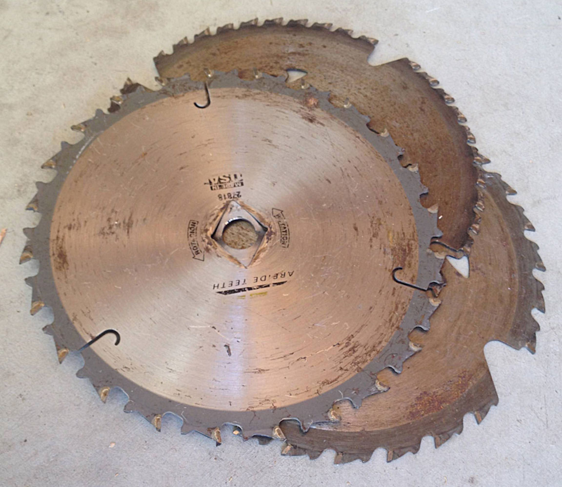

Hate to be a spoilsport for a good project,,,,,,but I do exactly what that that guy's doing all the time, with a string-trimmer that has a skilsaw blade on it. I can reach higher, reach lower, cut many more angles, cut each branch in a more sensible way, including flush-cut at ground level, and cut much faster. And not leave any eye-pokers.:shocked:
I can also reduce a cut branch to 1-foot chunks in seconds, and not have to pick it up. TING TING TING TING. Done. I tried a 10" carbide blade, it was heavy, took awhile to spool up and seemed very dangerous, I like the 7 1/4" skilsaw size. Plus I have a stack of old skilsaw blades, so it's almost zero cost.

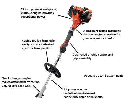

I recently bought a new echo PAS266 PAS-266callouts.jpg with the quick-attach system - and a 3 foot 'extension', I can cut 11 feet high. I have the chainsaw attachment too, for bigger stuff. The skilsaw is much faster and much lighter than the chainsaw on anything less than 2". Out on the end of a 6 foot (or 9 foot) pole the chainsaw weight makes a huge difference, as well as the speed, how long you have to hold position.
Having both is good, especially if you get one stuck you can unhook and cut it out with the other. I find the skilsaw blade to be far easier to use, and can work many more hours than with the chainsaw attachment (due to weight and cut speed). Plus you can cut bushes flush at ground level with the skilsaw.

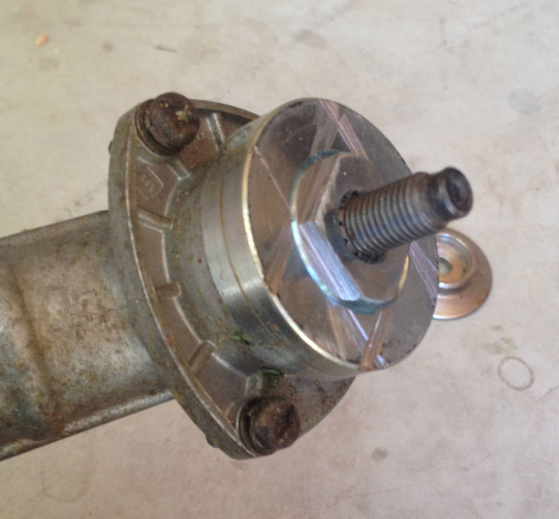

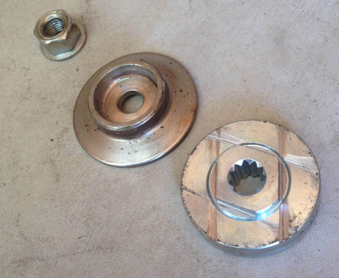

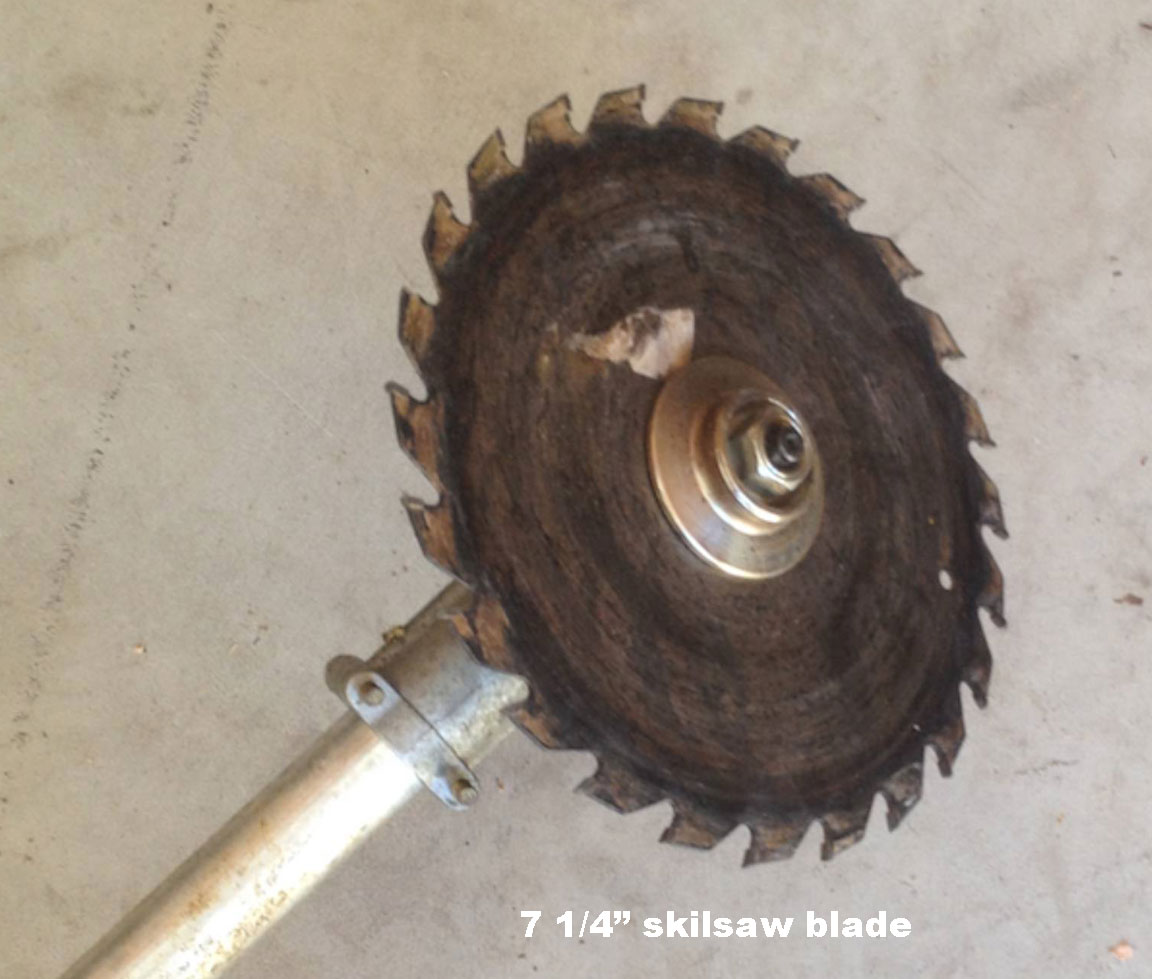

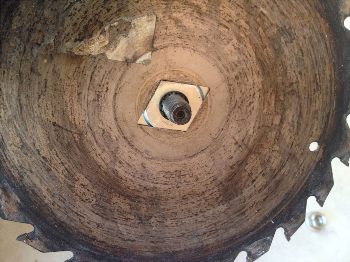

Here's how I attached the skilsaw blade. Don't even bother testing echo's 'brush blade', you need carbide. You just touch the branch, and TING, TING TING it's gone.
Sorry for going off-topic, depends if you want to build something, or cut brush. If you want to cut brush, I'm certain the string trimmer option is better.

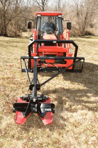

I have one of those. They sized the cylinder big enough to cut anything that will fit within the jaws. It's way overkill for small stuff though because the cycle time on that 5 inch (or so) diameter cylinder is slow.
What machine are you using it on?
I am thinking about getting one, the V417 has 22 gpm, so might not be too bad.

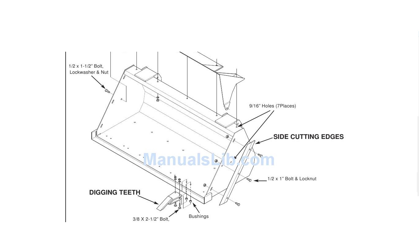

I have seee a bucket with a receiver tube on both sides of the bucket. this allowed the user to mount a hitch tube 3 ft long. The end of the tube has to sections of 3/4 metal he had milled at a 50degree angle. The same set up a seatbelt cutter works. They pulled up, snag said branch and backed up or let the FEL down and slice the branch was off nice and clean..largest I saw was 3'. Wish I had a pic of it.
I made something similar. It is two "knives" mounted to the bucket. See below. They work OK but would like to have something faster and able to cut bigger limbs.
