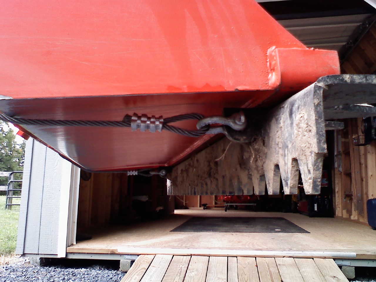

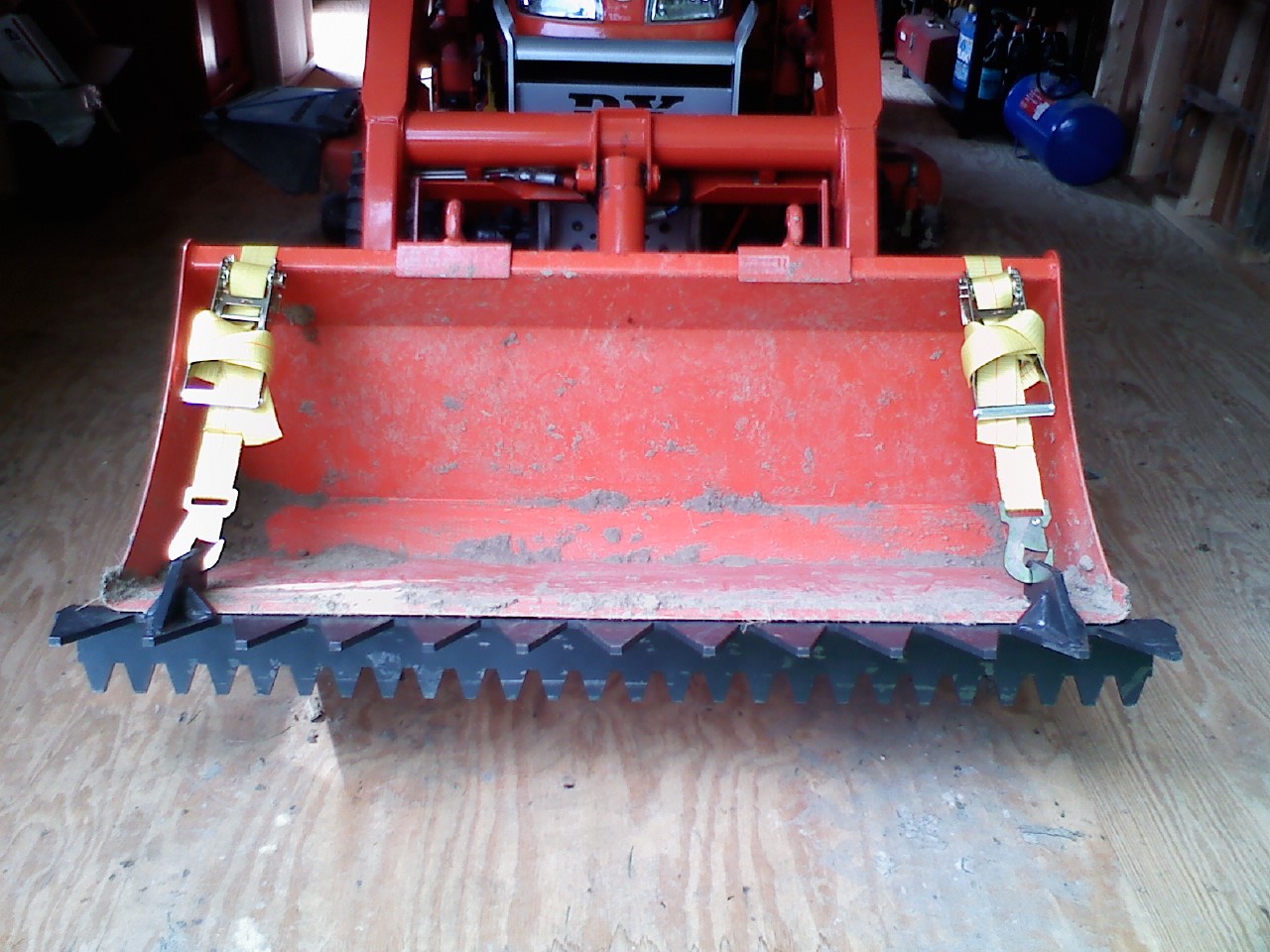

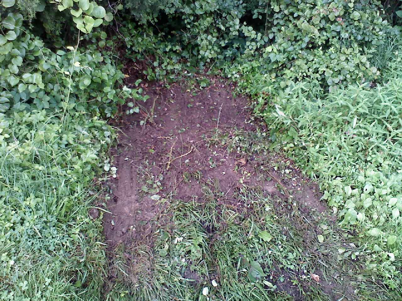

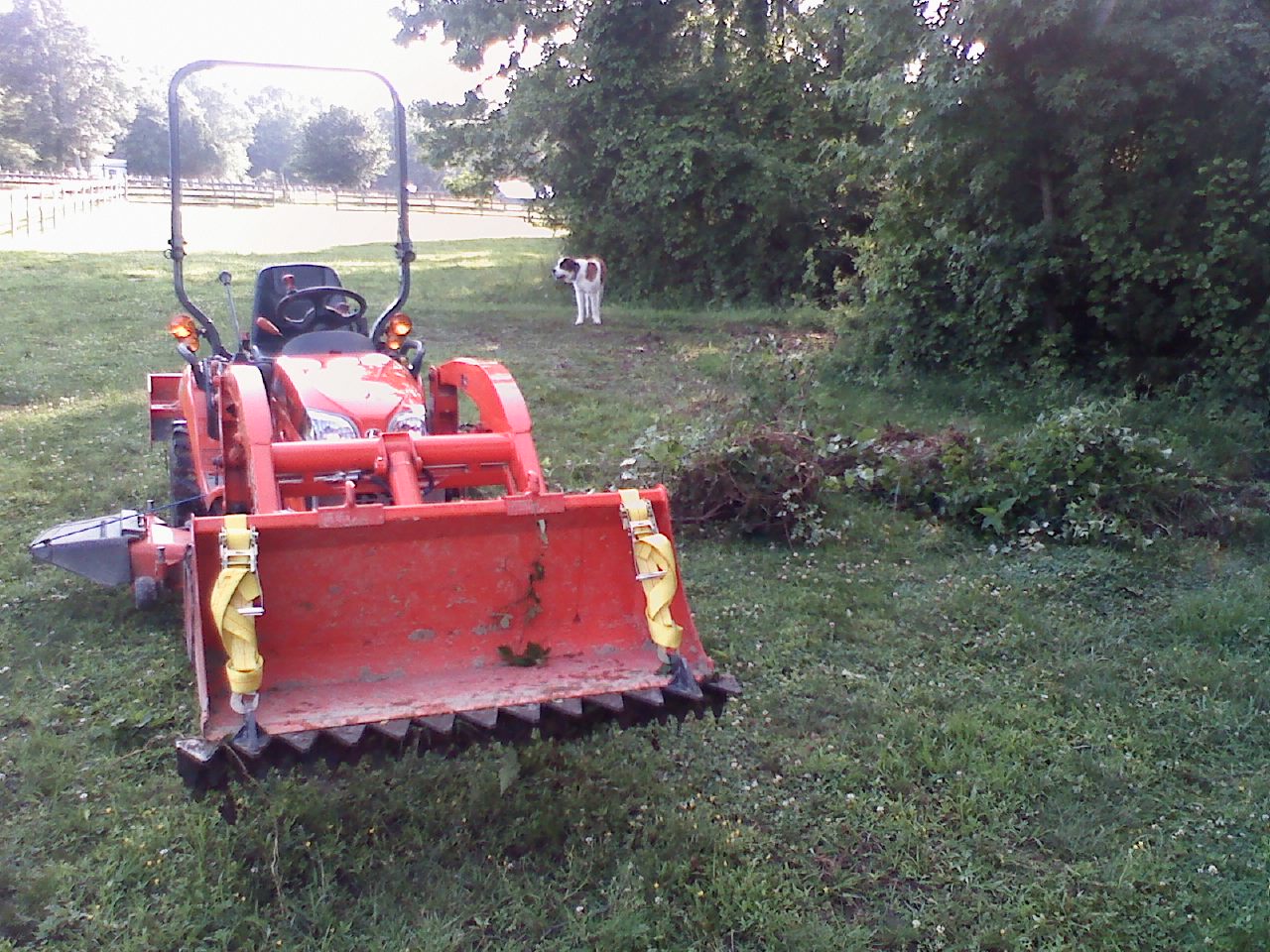

In my limited experience, a toothbar wouldn't be the right tool for the type of land clearing you need to do. The toothbar is great at digging into hard packed dirt and popping out roots and small stumps. The tool that I would suggest is the Ratchet Rake Ratchet Rake, LLC - Tractor attachment, Bucket attachment, Loader, Skid loader, Kubota, Skid steer, Landscape rake, Brush remover, York Rake, Harley Rake, Rock Rake, Tractor rake attachment, Construction attachment, New Holland, Bobcat, Fire safety, . Watch their video on their website to see what it will do and judge for yourself. Only problem is that you can only get the Ratchet Rake from select Tractor Supply stores now and not directly from them.
Bought my first Ratchet Rake for a B3200. Sold the B3200 or traded it to a BX25. Contacted Ratchet Rake Co about buying another Ratchet Rake for the BX. Told them I wanted to sale my old one. They later called me and gave me a mans name Ph# and sent mine to him here in Ky.He called as he was hunting one the size I took off of the B3200. He came up and picked it up a week later. Everyone was happy. He saved a few dollars, I got enough to buy one for my BX25 and the company made two customers happy. Sorry to see they stopped direct sales but manufacturing and sales is tough. Still available at some TSC's.
It's the best and easiest to hook up and un hook implement I own. It takes less than 2 minutes to attach and ratchet down secure and even quicker to take off and by myself.
It is also my most used implement not counting FEL and BH as implements. It is great with a capital G for clearing out scrub areas and for preparing dirt for grass seed. Forward to clear out over growth and tilt and back drag leaves the dirt ready to throw seed down and ten drive over.

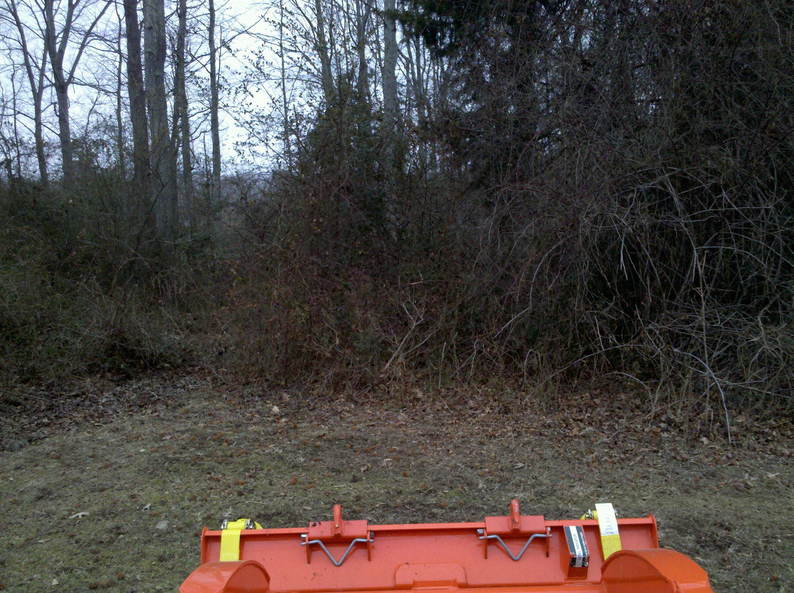

This thread made me want to go out today and use my Ratchet Rake again now that it's not so wet outside. Attached are a couple of before and during pictures of what the Ratchet Rake can do. I forgot to take an after picture (just like I forgot to lower the ROPS again before putting it away:mad:).
To the OP, I highly recommend getting a toothbar, it's a useful tool in many ways.
