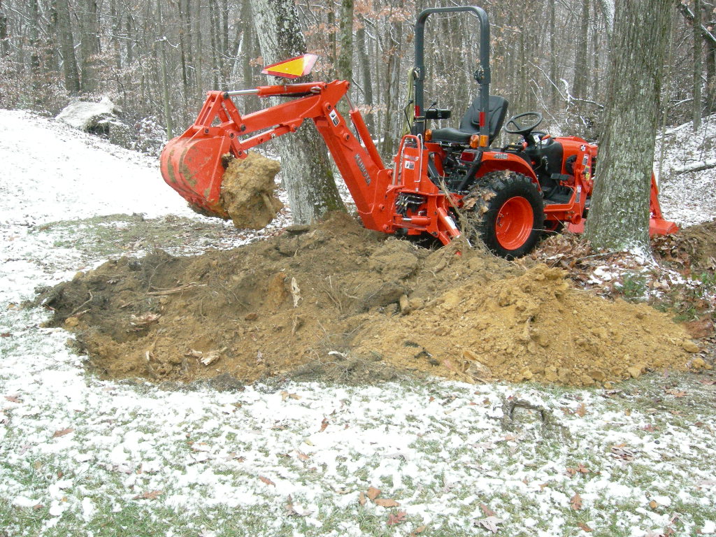

/ FEL Tooth Bar or BH Thumb? #5
I got a thumb and no toothbar. I will probably get a TB eventually, but I got the thumb first. I did a little stump digging over the weekend.:)
J.
Ok, going to show some of my inexperience. The thumbs for the BX aren't hydraulic? So - in order to use the thumb, you need to position the bucket, get off the seat, lock the thumb, get back on the seat and then the same deal to disengaged the thumb? Is this correct?
I bet I'll get bashed for this, but this just doesn't seem productive to me. Someone help me understand...
/ FEL Tooth Bar or BH Thumb? #8
All you have to do is position the fixed thumb in front of whatever you're trying to lift and then curl the bucket until it grips.
Riiight. Ok, not as bad as I thought. So position the thumb into a good spot for use while needed, then position it back when done. I feel stupid - something so simple, but hard to reason until you see it (or are told). Thanks.
