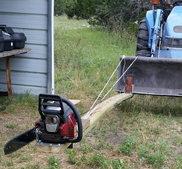

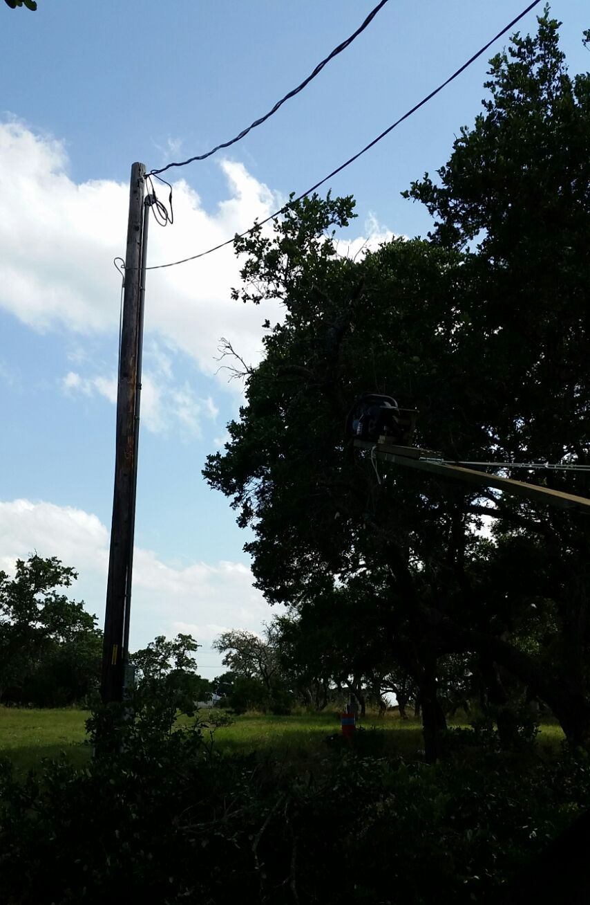

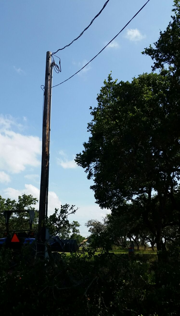

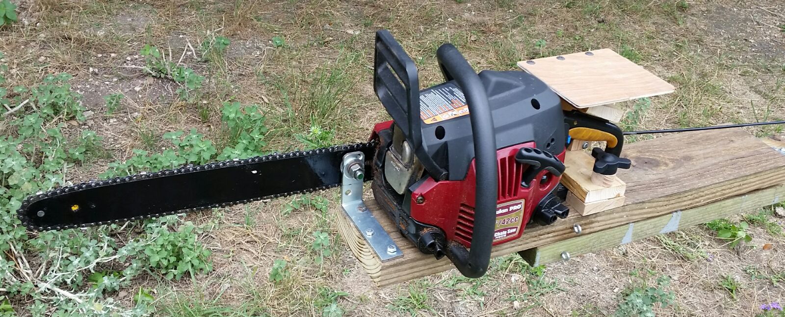

Haha, thanx for the accolades guyz.
Feeling some inspiration.....
I have an FEL, an electric (Remington) pole saw, a piece of 20' fence top rail, some guy wire, an extension cord, a switch or two and a tree hanging over a telephone pole (no power line on it).
Not sure if I have the guts or not though.
I had originally thought about making a human bucket lift cage, attached to the FEL. Or, just renting one. But there was so little room up in some of those trees. Plus, the thought of accidentally bumping the hydraulic control gave me the heebee-jeebees.
Not shown is the practice sessions.
Find a five-foot pencil, and practice signing your name.
Kinda like doing brain surgery, by way of the ****...

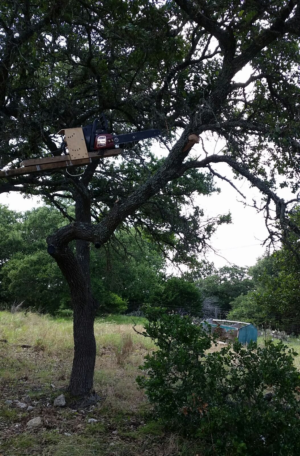

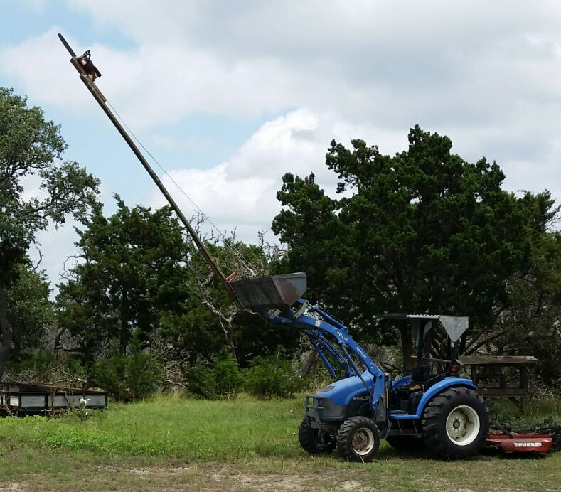

/ FEL mounted tree limb trimmer #43
:thumbsup:
....and you didn't get your saw pinched or hung up in a tree 25' above the ground! :cool2:
...nor did your saw mounting board bust apart from the boom so that a running chainsaw comes flying out of the sky and lands on your lap. :cool2:
Maybe he had seat belt on
