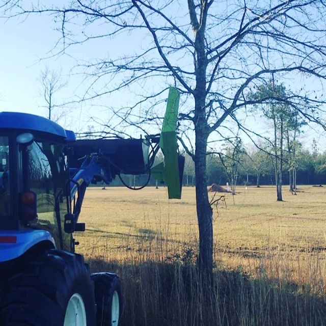

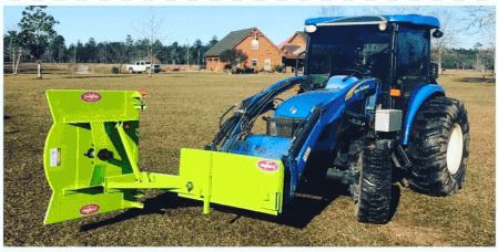

Well thats a perfect reason why I made a point to post on here before I went and did something drastic like building the death machine I had drawn up plans for. That implement is exactly what I am looking for. I just sent the guy an email. I have looked for quite some time and not found anything on the internet like this for a reasonable cost (which i think $2,200 is very reasonable for what I can accomplish using it).
I have no idea how I missed the other post that you added a link to. It answered most of my questions. If I can sell a few things around the shop I will be getting one early this summer and post some videos.
For anyone else who is looking landsharkusa.com is their website. Not a whole lot of information there and very hard to find through google, but helpful to give you an idea of what they are building.

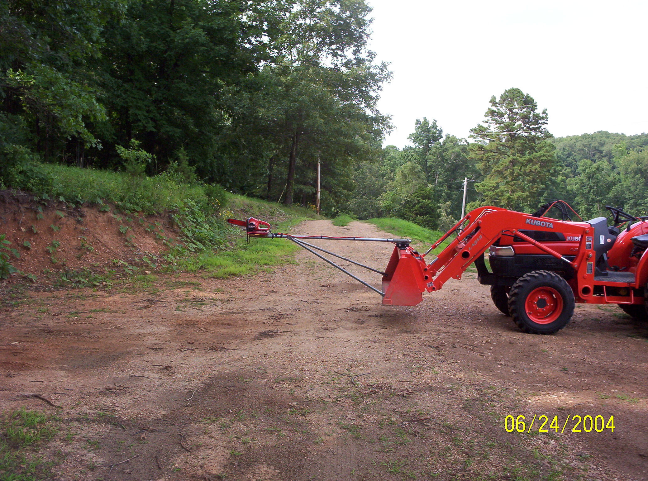

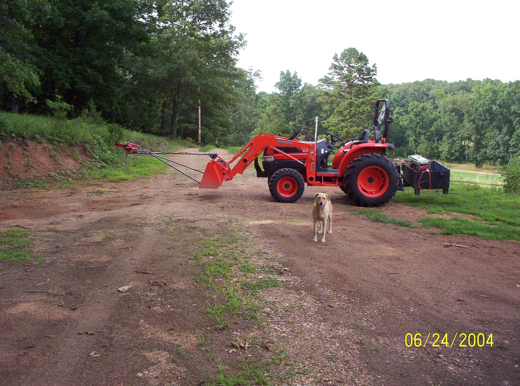

Here is what I done, works great. Note the saw must be spring loaded so you don't put to much down pressure on it and brake it. I also have it spring loaded to one side.

Xfaxman: Yes I meant Lane Shark. I must have mistyped. Sorry to lead everyone in the wrong direction. I have a need to trim 7+ miles of treelines with oak trees nearly identical in size to the one in the picture you posted (from 6" to 12" DBH). For that reason I must be able to do it quickly unless I want to quit my job and trim trees full time.
Bukit: I would like to see that thread if you ever find it. That was my original plan, and I believe circular blades may be even more effective than traditional mower blades. For my purposes though, I believe the Lane Shark might be perfect.
I have spoken with one of the guys at Lane Shark and intend to get one before this summer. For the cost (I think it will be around $3,100 total) I haven't seen another product that comes close to it. I don't think it says on their website, but the rep told me that they could make the SSQA version compatible with my JD loader quick attach specs. That means I can remove it for transport or to replace with my bucket in a matter of seconds.
I will keep this group up to date on how it goes. I know there must be quite a large number of people on this forum and reading as guests who are looking for a similar piece of equipment in this price range. Expect some photos and videos hopefully by mid-June.
This is actually pretty darn ingenious haha
I like it!!
