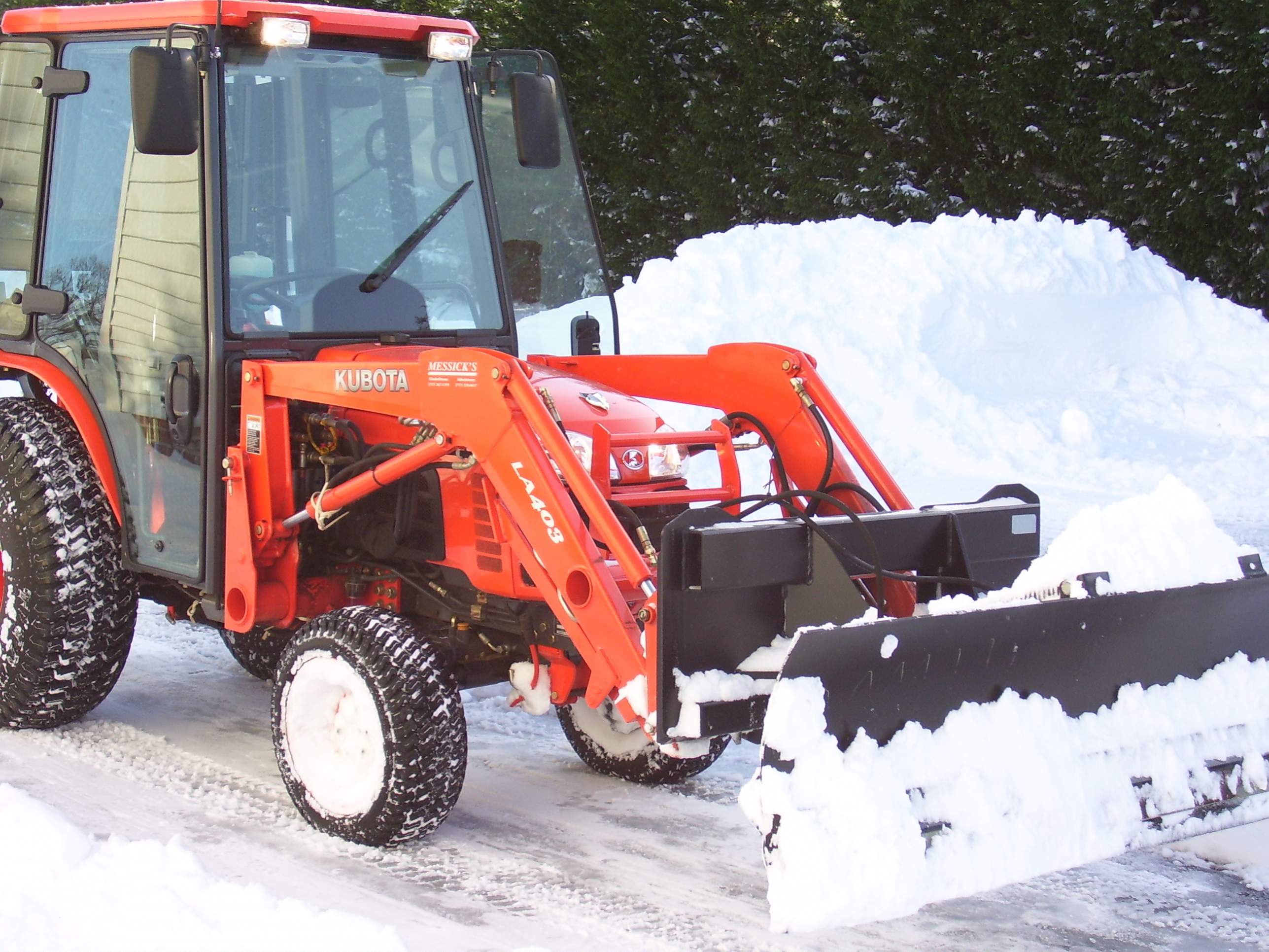

Is there a mod, or a blade that you could switch out the loader for? I have about 1/4mi drive that was a bugger to keep clean with my little Furgeson last winter. It's doubly hard when you are either pushing or pulling a typical rear blade.. My neck cannot handle it.
I'm looking at a 5500 and thought it would be wonderful to have that mass pushing snow. Any thoughts?

Lots of forums here that have the information you want..from snow plows mounted to the bucket ,quick attach plates(remove bucket),sub-frame mounted front blades.I had a sub-frame mounted snow plow on one tractor:worked well but you lose the Front End Loader(at least the tractor I had),I currently have a Curtis snow plow attached to my FEL (QA plate) works very well for me.I can change from bucket to plow in minutes.

I changed the bucket pins on mine to 1" pull pins. That way I can take my bucket off and attach an old 7' plow blade to my loader arms. I don't have angle power angle so can only straight blade but it works for me. Later in the season when I need to move snow I put the bucket back on.

I live about a 100 miles North,worked in that area for ten years;they measure snow in feet.:D I also have a FEL mounted plow,8ft. Curtis with power angle...tractor weighs 6500lbs.

I use this, of course I have a quick attach front loader.
