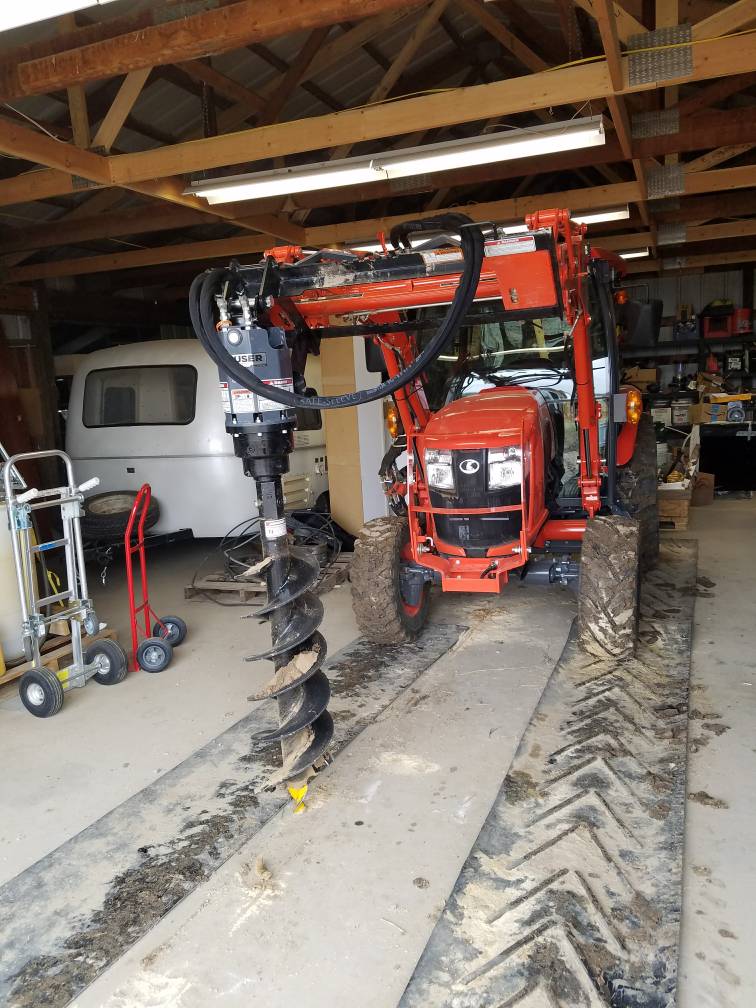

I bought the EP6 danuser auger drive, and absolutely love it. So much nicer than the 3 pt ones as far as I’m concerned. There are several brands that are all good such as McMillan, danuser, Belltec, landpride , etc. Which ever brace you go with, make sure it’s able to be mounted offset-able so you can see what the auger is doing from the tractor seat, if you get a center mount you won’t be able to tell what is going on very well, mine is offset to the left .. They all have different augers available too a good quality auger designed for the soil conditions you have makes all the difference too. IMG_3250.JPG

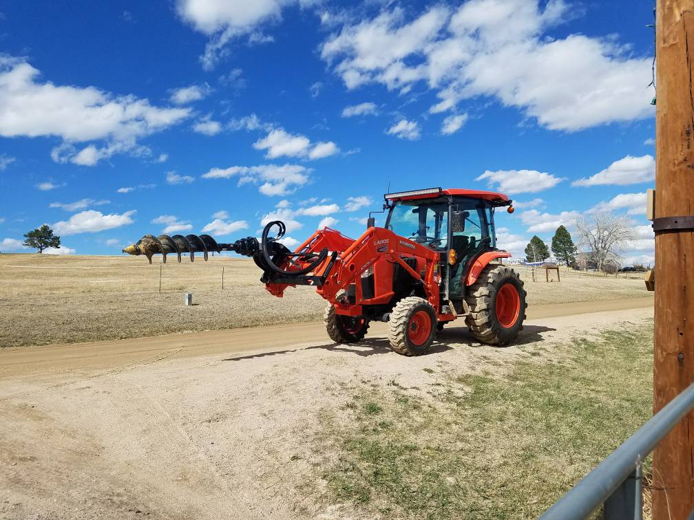

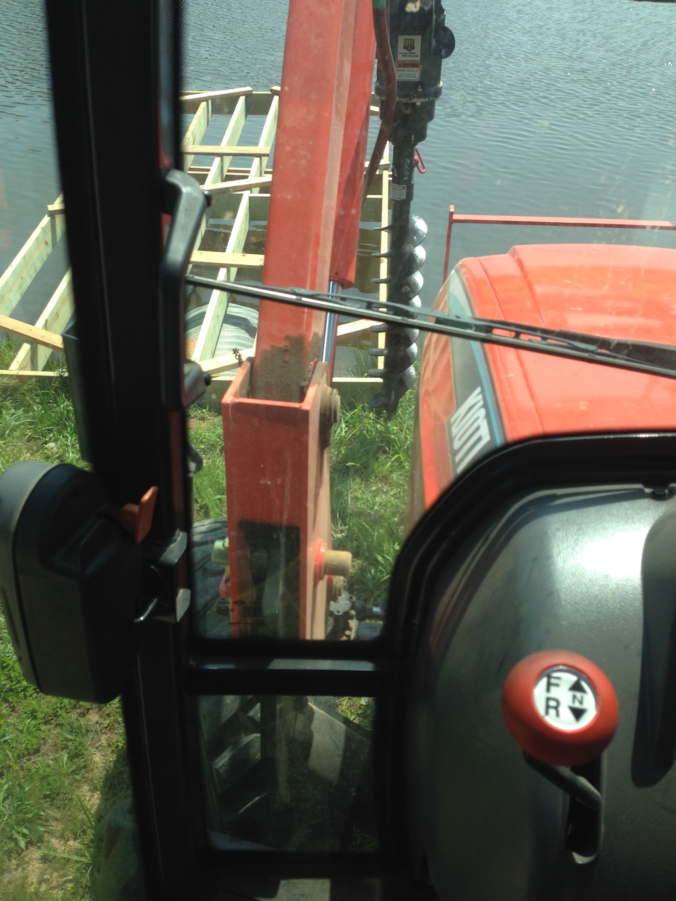

Same as previously noted. Happy with my Danhuser. It's the small one to match my 10gpm flow on the L4060. Less than 14hp hydraulic vs the 25hp PTO I had on the old L3200. Noticably less power than the old PTO PHD, but worth it due to reverse, downpressure, ease of mounting, visibility, etc.
Offset mount for visibility is the only way to go.20170401_133255.jpeg20170402_145306.jpeg
