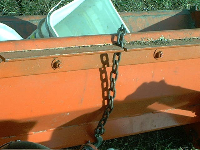

I borrowed an idea on the forum here. Sorry I forgot the name, but regular posters probably recognize the approach. Starting with a length of angle iron, I cut three pieces to fasten to the top of the bucket. These were cut into two short pieces - one for each side, and one longer piece. They mount against the lip of the bucket for a little added strength, and have U-shaped slots to accept 3/8" chain. The slots stop where tha angle and bucket lip meet, and were made by punching a hole, then running them into a bandsaw. The center angle has a couple extra slots to use up excess chain. The chain I normally use is about 20' long with a grab hook on each end. It's handy dangle the length (center pick) or lengths (double pick) needed then grab the leftover with the remaining slots.....................chim

That's a really clean looking setup Chim.
Jerry
/ FEL hooks #24
I agree - the set up looks great and appears simple enough that even I might be able to handle the welding /w3tcompact/icons/smile.gif. Just another great idea from this TBN community.
Bob
/ FEL hooks #25
Chim, the quality of your work is great. They look really sharp.
I'd like you to consider a couple of points. They're from experience with working around such stuff.
I'd have preferred you arranged the angle of your slots so that the chain in tension is pulling against the steel's strongest angle. As it is you have the chain pulling against your angle iron where it is weakest. Much load and it will bend. And what scares me is if it bends the chain might slide out. There's only been a couple of times out of thousands when something like that has happened to me that it wasn't the perfectly worst time to do so. I guess that's why I'm such a worry wort.
But your attachment is so simple and effective that I'd suggest you make just one modification to make it perfect.
I'd take your brackets off and weld some straps across your angle iron. Say quarter by one and a half arranged so that there's plenty of clearance for the chain to slide in but as close as possible so your slots are supported as much as possible.
This would help support the slots and more importantly from a worry wort's perspective it would give you the opportunity to put in a pin through the chain link so that it would be impossible for it to slide out. The pin being long enough to catch the two supports on each side of the slot.

Harv, Thanks for the advice. I was considering welding some nubs on the backs of the angle at one point too, just to help keep the chain from slipping out. I do have to tell you that I've had daylight under the rear tires already while moving a 5' rotary mower hanging from the bucket without affecting the angles. This was after the rears had a drink of Prestone...................chim

<font color=blue>I'd have preferred you arranged the angle of your slots so that the chain in tension is pulling against the steel's strongest angle.</font color=blue>
I like Chim's set-up and I am thinking of using it. I read your comment above and I am having trouble picturing what you mean. Can you elaborate a bit?
/ FEL hooks #31
Hi Tony,
Your steel has three directions you can pull from. The thickness of the plate, the width of the plate, and the length of the plate.
Chim has his slots so that when his bucket is parallel to the ground the pull is against the thickness of the plate.
It also means if he tilts his bucket the pull down will have a ramp for the chain to go out and off.
What I suggested was a strap across the hypotenuse (sp) of the angle iron. This would mean the pull would not only be against the thickeness of the plate. It would also be working against the combined strength of the width of the angle and the thickenss of the bucket wall it's bolted to along with his bolts.
Imagine sliding your chain into the slot. On each side of the slot let's say you have one of those straps I'm talking about. Then for safety's sake you put a rod through the first link so that if the bucket is tilted forward the chain can't slip off becaue the pin catches the one or both of the straps.
Chim's idea and craftsmanship is beyond reproach. I hope I don't come across being a critic of it. What I'm offering is in addition to his idea to help it be safer and hopefully stronger.
