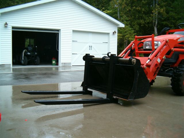

I just bought a pair of the "bucket forks"listed and custom made by my dealer. Check them out here:
PALLET FORK ATTACHMENTS
The functional load bar not only adds extra support to make your bucket practically indesructable but it transfer the weight from on top of the bucket directly to the pins.
The components all come off and can be put on individually so there is no excess weight for the operator to handle.

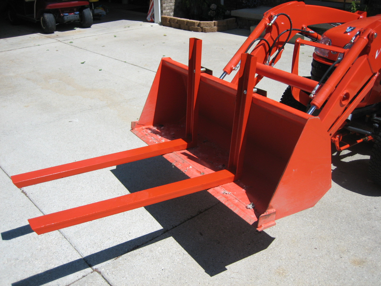

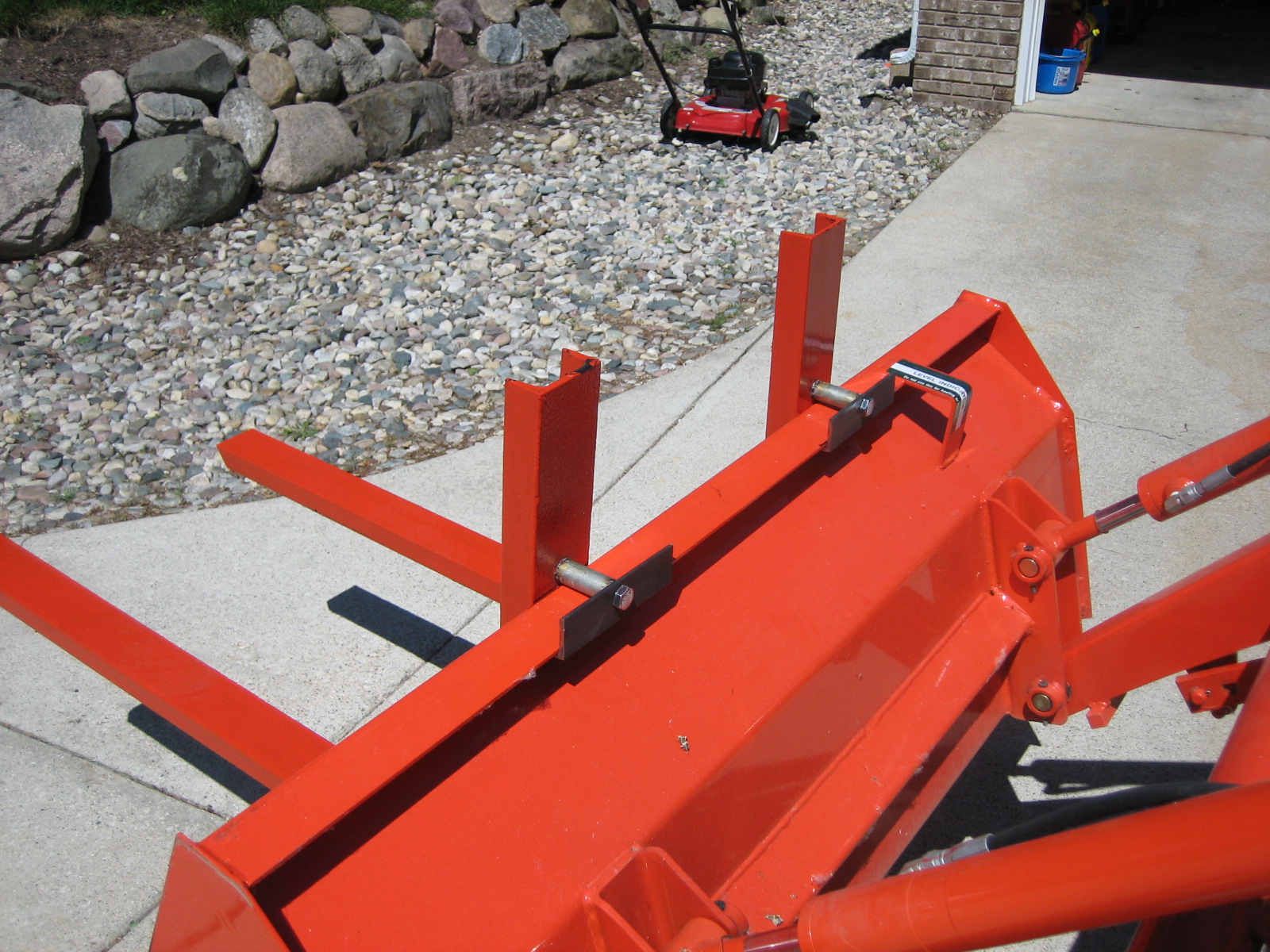

This works for me, cost less than $120 and has held 500 lbs. so far.

Rimshot, Apparently the outfit you bought from offers the "load bar" option or a customized pallet fork set up that connects to the FEL arms once you've removed the bucket. On my Kubota BX24, removal of the bucket would take about 5-10 minutes with a rubber mallet and two wrenches. I'm asking for more detailed pics from them of both set ups. Sounds promising. Did you consider the otehr option described above?
/ FEL forks for subcompacts #10
Hi bx24d,
Yes sir, I did consider the bucket removal/fork option. I think I made up my mind to utilize the bucket mount pallet fork for two reasons. The first of which is convenience in that I don't need to R & R the bucket even though it is easy to do. The second reason is I like what the load bar does for the bucket. With that load bar attached, this bucket has to be literally twice as stout as the way it came from the manufacturer and it is a good bucket to begin with.
Incidentally, that is no tube or pipe that goes through those eyes to secure the forks. It is a solid core of round stock steel of 2" diameter. This set of forks is obviously very well conceived and the workmanship is excellent with heavy stock and fine welding. My hat is off to Michigan Iron & Equipment of Morrice, Mi for fabricating this heavy duty fork for a very reasonable price.
Is that just channel iron for the forks and frame? Nice setup. I only need lightweight lifting and this looks like something I could build myself.
Do you have additional photos?
Thanks,
Clem
