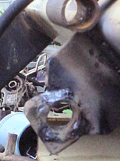

Been a entertaining day got cylinder lines swapped and put it to work. I was cleaning the tundra out of my 8ft x 200yd swamp all was going well untill I tried to pickup double bucket of tundra and split clevies pins mount on QC rack. I had forgot to wrap with 1/4 in. strap. O'well it was fun while it lasted.
/ FEL coming
#25
It's repaired. here's ma shot of the upper cylinder after repair. At the top is a piece of what was there before.

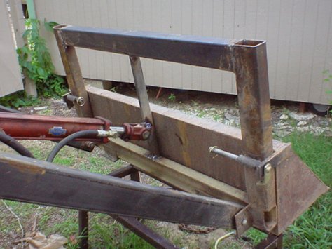

Here's a shot of what I call a QC rack with small bucket hooked up.

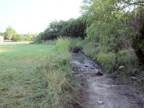

Here's the bedrock bottomed ditch I'm using the FEL with thatch spikes to clean the tundra out of.

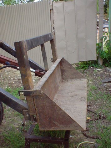

Here's a shot from the side.
