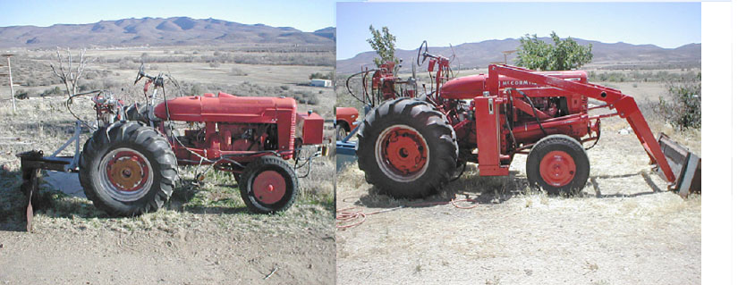

Got the curl cylinder hooked up and working but haven't finished QC sub frame yet. Will ger pic's soon.
/ FEL coming #22
</font><font color="blue" class="small">( I've seen more wide front ones tipp over than I ever heard of tricycles. )</font>
Yeah, I think a wide front end does not help nearly as much as one would think. I've never seen a tractor with a sway bar so there is no roll resistance from the front until the full tilt of the front end is attained, which is probably too late to stop the momentum of a rollover. On the other hand having the pivot point a couple of feet off the ground should add some roll stability.
I think the biggest disadvantage of the tricycle gear with a loader is that all of the weight bears on one spot on the ground so you get less flotation and a greater tendency for a single obstacle or rut to spin the steering wheel out of your hands as the front turns to full lock. (Yes, I did drive an M some in my younger days.)
It's stilll a lot safer than a motorcycle....

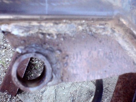

It's repaired. here's ma shot of the upper cylinder after repair. At the top is a piece of what was there before.
