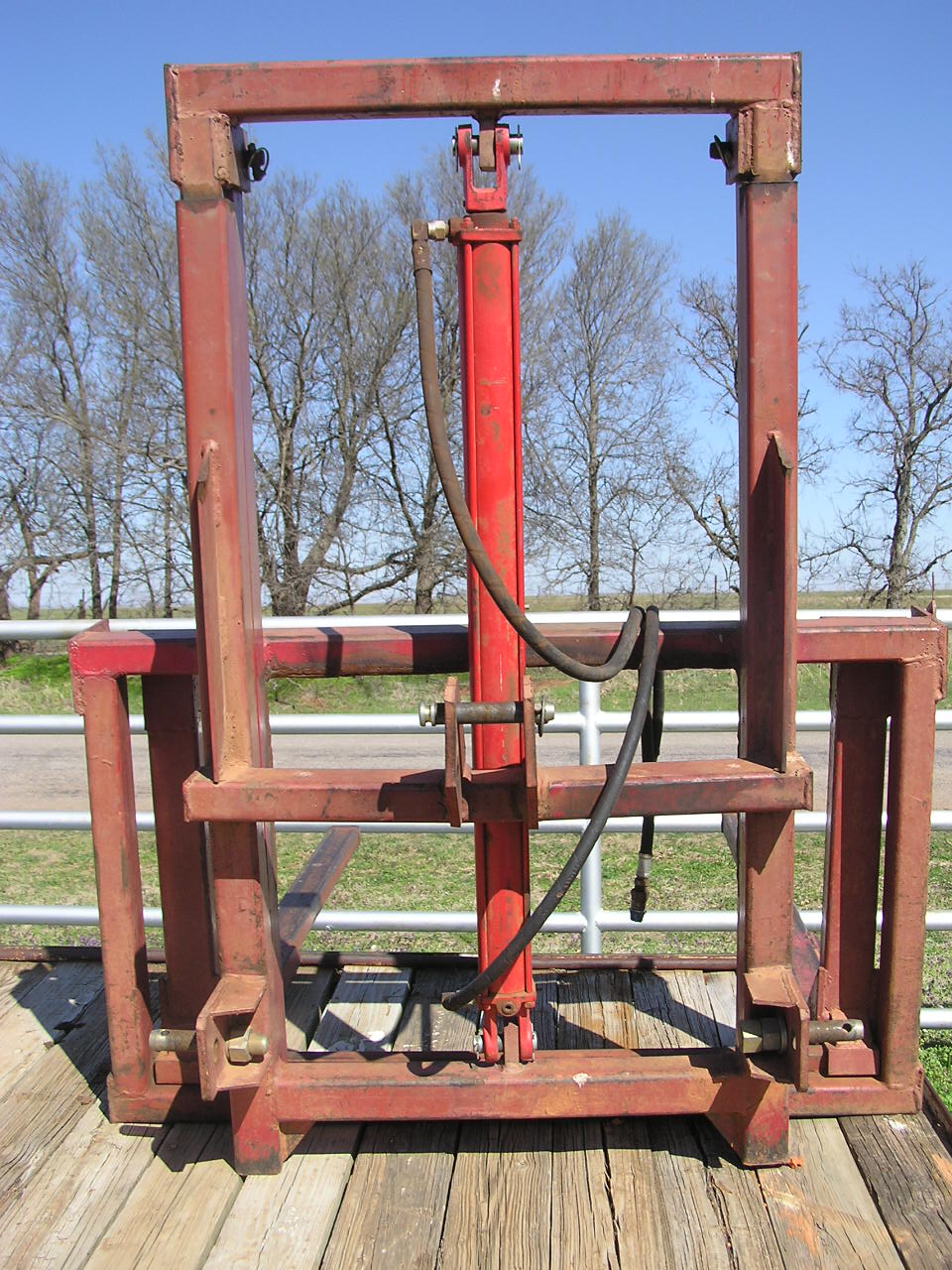

Attempting to upload pictures of my FEL mounts? Hope the files are not too large.

Yes I plan to after fitting hydraulic cylinders to arms. Want to make sure I do not interfere with hydraulic hoses etc. Any suggestions on what material to use? How strong do they need to be?

It depends on the tractor, our B7500 uses 3/8" x 2.5" flat stock.
The Massey Industrial 30 that Dad used to have used a piece of 3x6ish box tubing.

Dabwood40, can't tell from the pictures, but you need to for sure have "axle bars". One on each side of your underbelly mount going to the rear axle. Might be 2x2x 1/4 square tubing for your size tractor. They put the weight on the real axle and take stress off of the middle of the tractor.
If you're interested in what may happen if you don't build it correctly, aahere is a picture of a Massey 1010 with a busted transmission housing!

Some of the Japanese Massey's had aluminum bell housings. They were particularly prone to breakage. But even a good cast iron bell housing can crack.
We have designed and built well over 100 sets of loader mounts over the last 15 years and your advice is good. I'm not so sure it is the transfer of weight to the rear axle that takes the stress off the middle of the tractor I think it is more of the torsional stress. Whatever the dynamics are, I agree that a couple pieces of tube mounted low going back to the rear axle area and a couple pieces of tube or reinforced flat stock (made like a "T") mounted high and going forward to the bumper area eliminates the mount trying to rotate.
