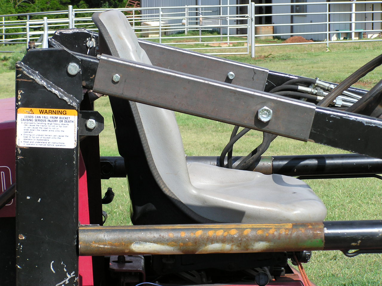

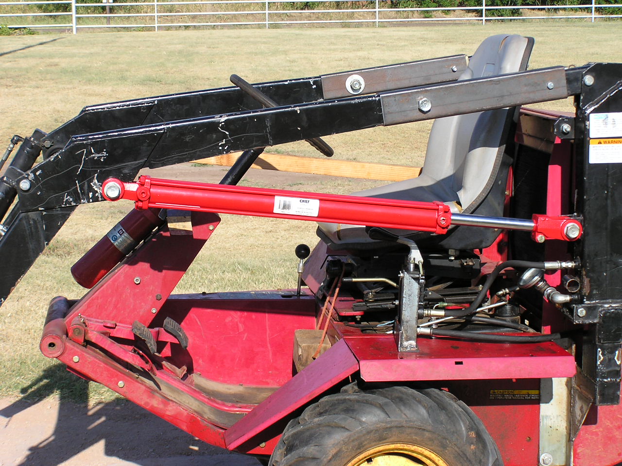

I bought a used loader and lengthened the ams to clear the front of the machine: FEL, TORO Groundsmaster Put Together

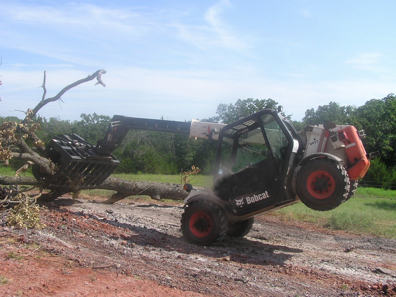

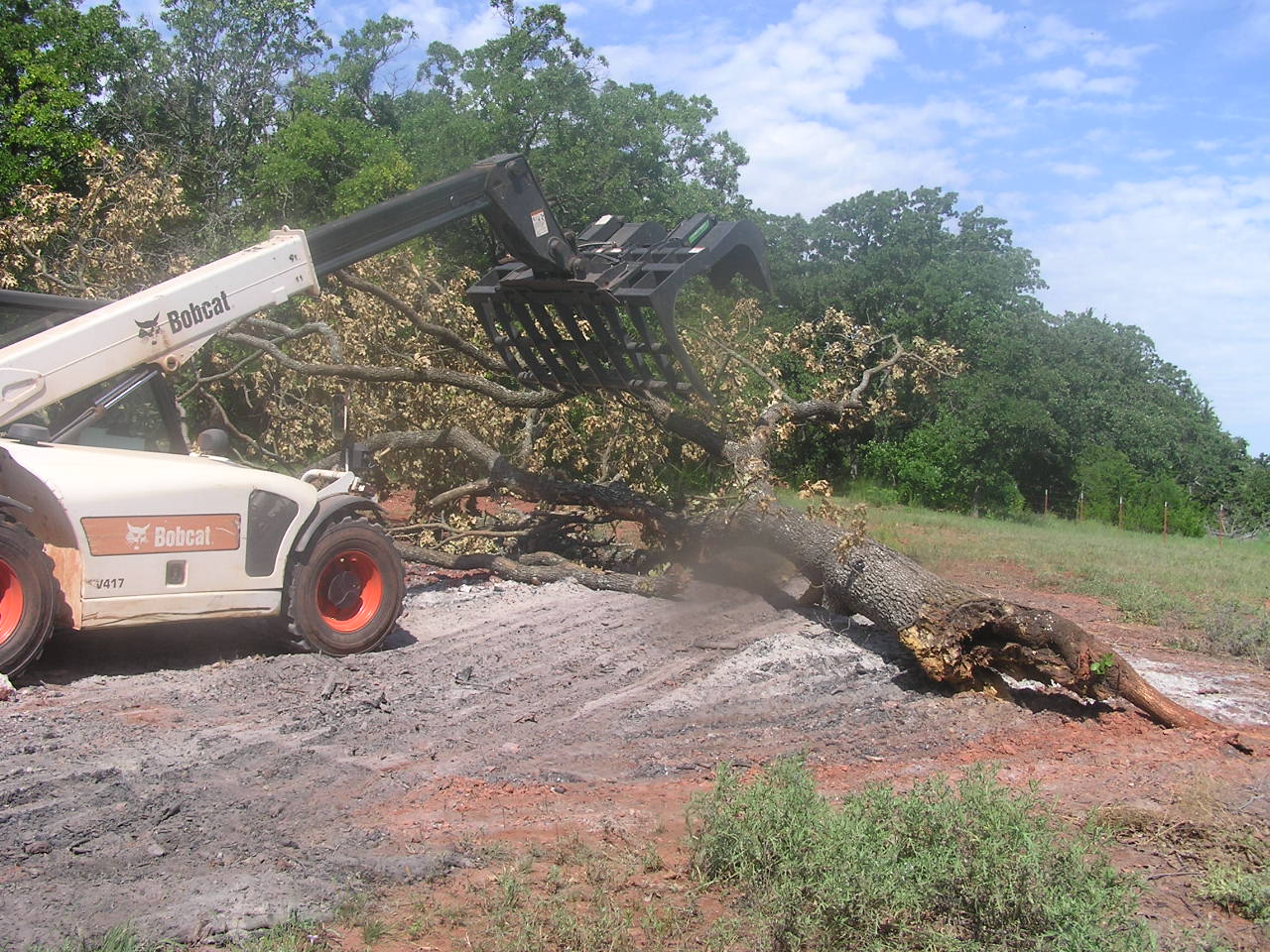

I don't think it makes any difference where the arms pivot. Do you have any thing that explains it?
What I think is the front axle is the pivot point. The amount of weight picked up by the FEL determines when the rear tires come off of the ground.

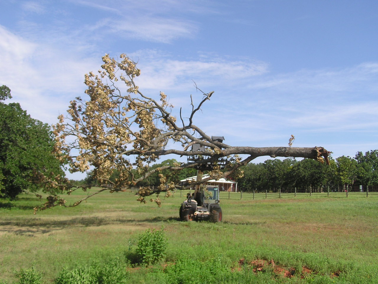

On my machine the boom pivots over the rear axle. It will pick up over 6,000 pounds with the boom retracted and the rear will stay on the ground. As the boom extends the rear axle will come off the ground.
This tree weighed about 2,600 pounds and the grapple weighs 1,168 pounds:
At the burn pile I extended the boom until the rear came up, then slowly raised it more for the picture:
Lowered the rear back down and opened the grapple:
