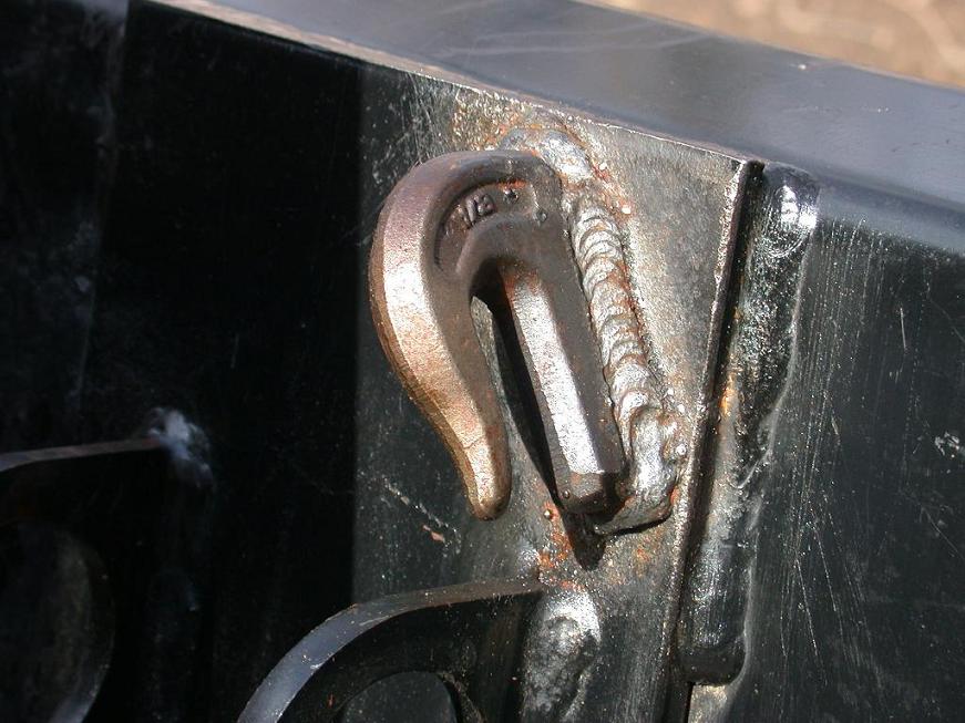

For those of us with less talent, there are grab hooks specifically made to weld on. They are very reasonably priced too. You can order them from AW Direct , a towing supplier. I bought 6 of them and welded them on my backhoe and FEL bucket. I've got a couple left over and may weld them on some of my implements so I can move them around (for service or adjustments) without hooking them up to the 3pt. I'll share one pic of the FEL grab hooks, one on each side. For some reason, I prefer to lift with 2 hooks always, so I don't have a center hook.
   / FEL Bucket Hooks #35
Rob, was that with your arc welder/genny at the property? Your weld looks good. The bucket weld beside it looks like they missed the mark though. By the location of the hook do you run the chain over the bucket top?

Yes, on the property...see...I'm learning from your examples. /forums/images/graemlins/cool.gif
Chain over the bucket top edge?
Yes, and no...I turn the bucket "dumped" when lifting so the chain is held only by the hooks. If I were to pivot the bucket backwards somewhat, it would run the chain over the top only when lifting dead vertical, but barely. So far I have not done that yet and that's why my top lip is not bent yet. /forums/images/graemlins/grin.gif I put them there not only for vertical lifting, but when I want to "roll" a big rock or log into the bucket.
