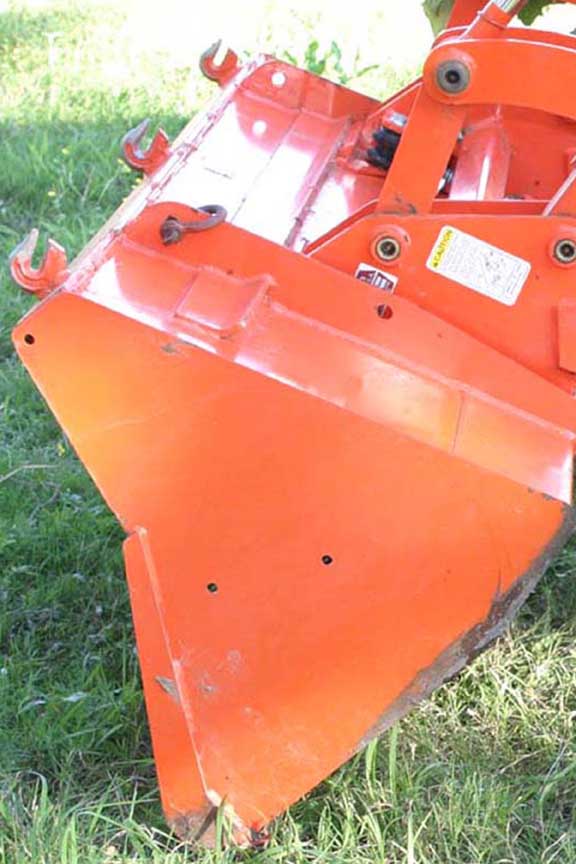

For those of us with less talent, there are grab hooks specifically made to weld on. They are very reasonably priced too. You can order them from AW Direct , a towing supplier. I bought 6 of them and welded them on my backhoe and FEL bucket. I've got a couple left over and may weld them on some of my implements so I can move them around (for service or adjustments) without hooking them up to the 3pt. I'll share one pic of the FEL grab hooks, one on each side. For some reason, I prefer to lift with 2 hooks always, so I don't have a center hook.

Rob, was that with your arc welder/genny at the property? Your weld looks good. The bucket weld beside it looks like they missed the mark though. By the location of the hook do you run the chain over the bucket top?

If you have them too far apart, as on the pic by the dude with the chrome-pimpy, and you attach a loaded chain to one side only, you will certainly have the whole unit out of balance and will put extra pressure on the opposite seals and arms.
If you added them about 40cm to 50 cm (about 14 to 18 inches for you American dudes) either side of the centre of the bucket and used your chain as a central pivot, you then get total evenness and correct balance, which is far more safety friendly, and better for the balance.
Do we agree on this? We have set up our FEL's this way and it's mainly from a safety aspect.

Yes, and no...I turn the bucket "dumped" when lifting so the chain is held only by the hooks. If I were to pivot the bucket backwards somewhat, it would run the chain over the top only when lifting dead vertical, but barely. So far I have not done that yet and that's why my top lip is not bent yet. /forums/images/graemlins/grin.gif I put them there not only for vertical lifting, but when I want to "roll" a big rock or log into the bucket.
