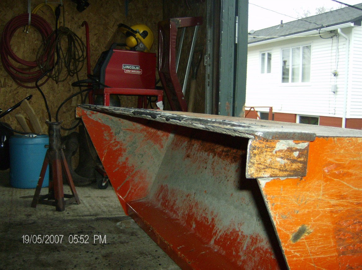

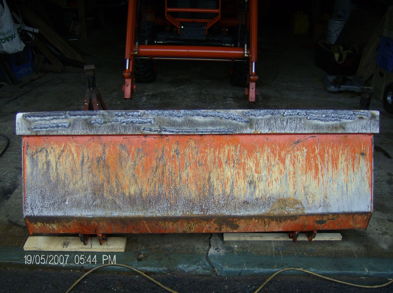

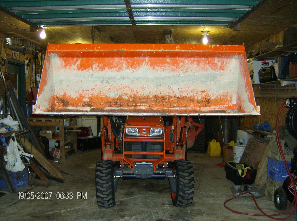

Well I got at the loader to straighten the bow out with my welder and after the first couple of runs I thought I was going no where but then it started to come together . There was a dip in the loader of about1/2 to 3/4 of an inch in the center now I must say it is much improved.
I will leave the welding on it till the winter when I need it for snow clearing then I will grind the welding of the bottom of it.
I was wonder what a leaf spring would be like for re enforcing the bottom of the bucket have the thinest part of the spring out towards the edge of the loader and then cut it the length you need for the depth of the loader. Have two of them and weld them to the inside of the loader. Divide the loader up into thirds for the spacing of the springs. you would only need one spring to do the job.

Do you have any before pics? That looks pretty good.....what did you do, just run lots of heat and some 7018 rod?

No I should have taken some you could see the difference .Hard to say how it would work on your table .Do you have a piece of plate to try it on first.

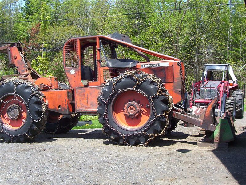

The "Skidda" has a lot of down pressure. Still had to cut some slots to make the bucket edge straight. It's an inch thick.
