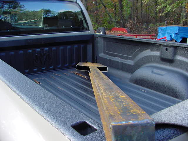

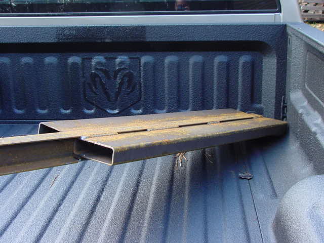

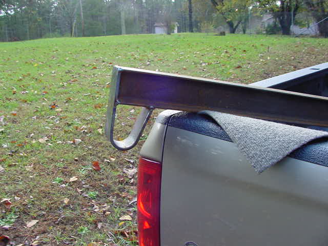

Some scrap 3" I-beam and box to fit your forks make a simple boom pole.
   / FEL Boom Pole - Lift ? #5
Number #2
   / FEL Boom Pole - Lift ? #6
Last one
   / FEL Boom Pole - Lift ? #7
The box is 4' and the I-beam is 10'. On my tractor (Branson 2810) max height is 19' 6" (3' off front bumper) 16' (6'8") and 12' (11'4").

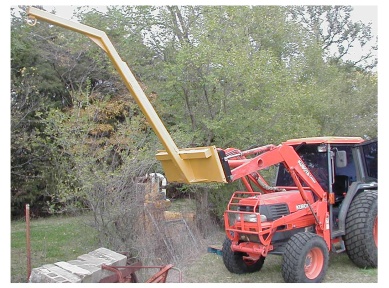

This is mine, see attached. It is made at Quality Welding. http://www.qualityweldingservice.com/liftboom.html
Very handy nice and It will reach about 20’. You have to be careful if you put a lot of weight on it … you also have to put a lot of rear weight. KennyV.
   / FEL Boom Pole - Lift ? #9
Kenny,
I like your design. It looks like a factory job. How high does it lift?
