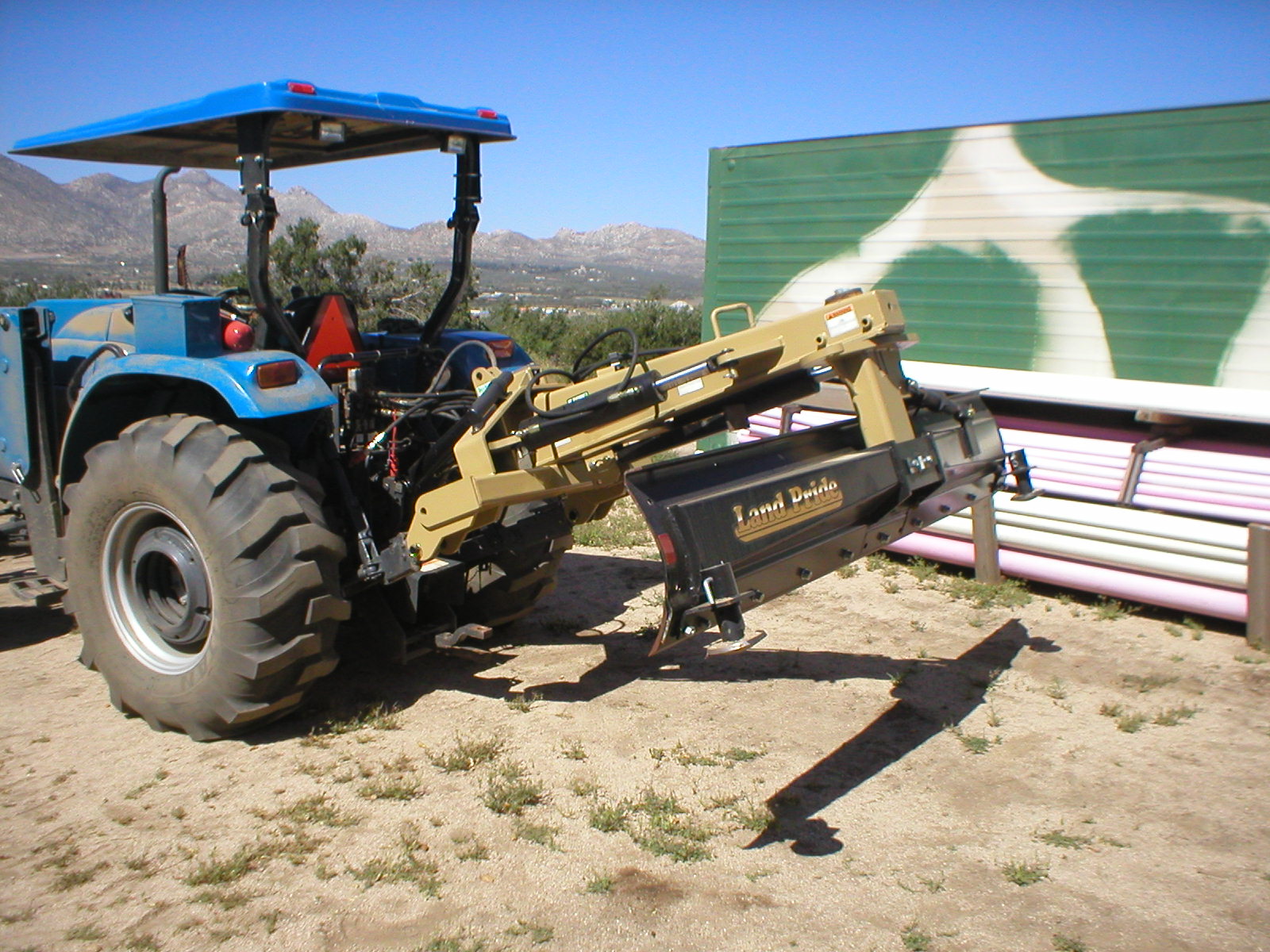

I think that you will have better luck with them if you can get them dished some. Mine are about 1/2" if I remember correctly.

You didn't have any issue with it digging into the ground? bet will be much better when the ground is frozen though

they are dished about 1/2"
Buyers S.A.M. Snowplow Aftermarket Manufacturing Plow Shoe - For Life Out Here
They will be better when the ground is frozen. I actually don't need them then. That's the reason I put them on, for use on thawed ground, but I'm not sure they're going to work the way I was hoping.
I thought of skis, but they are very narrow and I was afraid they would leave 'skid marks', much like these round feet seem to. :(

Well, they look flat to me. :confused2: If the ground is soft, it's going to leave marks, not much you can do.
