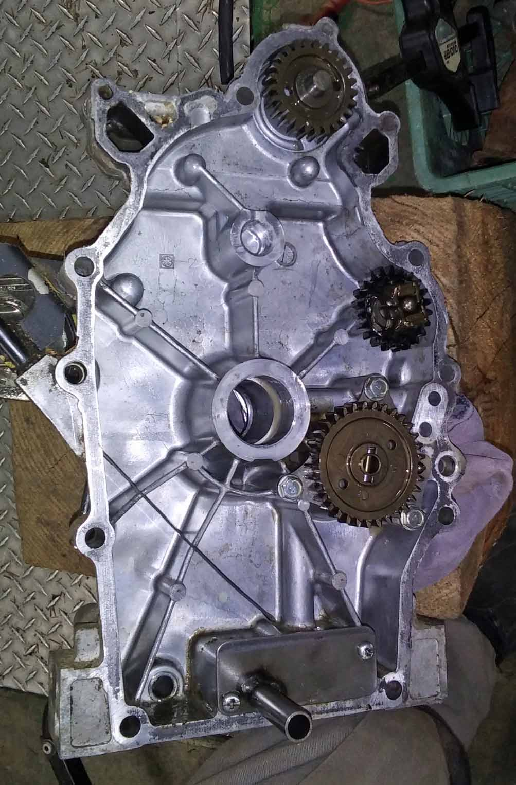

Well, I could not get my engine running right, so I had to pull it.
You can see the governor in this photo. Turns out, the person who tried and failed to get this engine running did a few things wrong. He installed the steel cam gear kit, but somehow managed to install an oil pump RV spring that was too short. No oil pressure. It looks like there is an oil pressure kill switch, which did not allow any spark.
I seem to have the FD620D-GS11 engine, which also seems to have a 2-piece governor lever with left hand threaded bolt holding it together.
/ FD620D #33
The correct spring is P/N M138429 $0.90
Later models had the two pc lever I could not tell the bolt was left hand from JD parts
