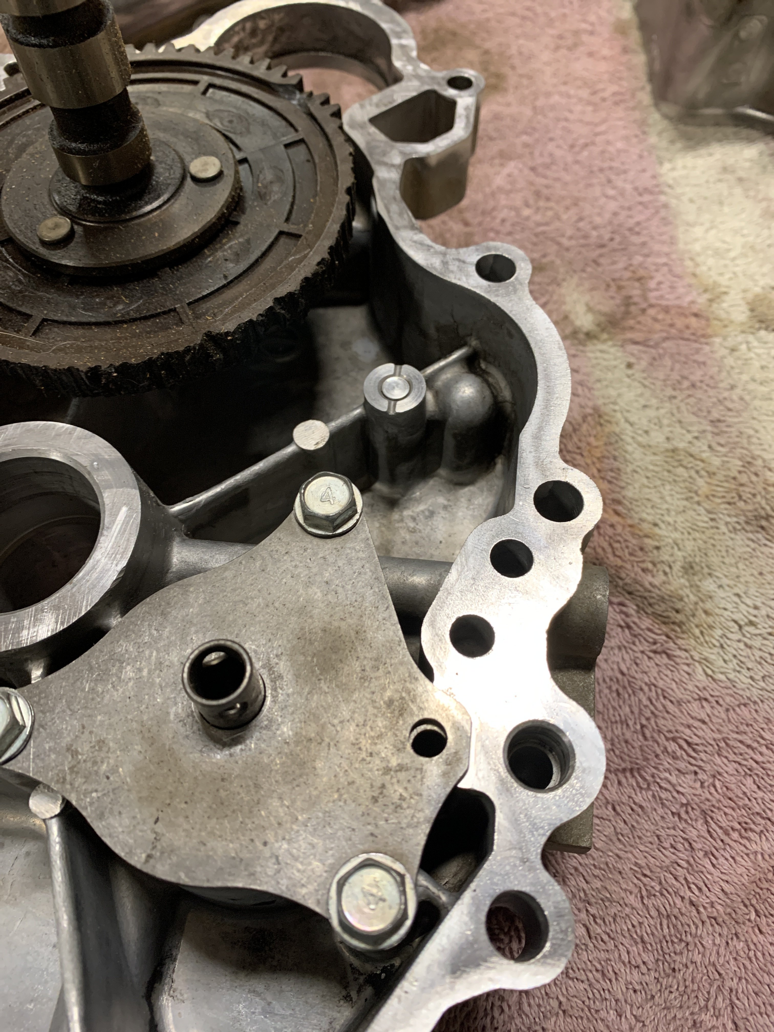

Hey folks , just joined and looking for some advice , I’m brand new to Kawasaki engines , but have always tinkered with all kinds of engines ...
I picked up some one else’s problem, a Mule with a FD620D engine ..
“Someone “ had taken the engine apart to the point of finding the broken cam gear and then abandoned the project. I have it all apart and have cleaned up the case and all other parts . Now I’m at the reassembly phase and having some questions.
It appears that the govenor stud is “missing “ it doesn’t appear that it has broken , actually looks almost factory to not be there . And I don’t see a place for the govenor rod to pass through to actuate a govenor if it were there . Where there other means of rpm control that was used?

A Model would HELP! Can you find a tag on the Mule, not engine, with a model number? It might be, for example: KAF 620 A4
Did you find any linkage parts for the governor? IIRC the governor shaft will be in the other half of the crankcase, end coming out between the cylinders. Kind of hockey stick shape. 39003 that a lever mounts to.

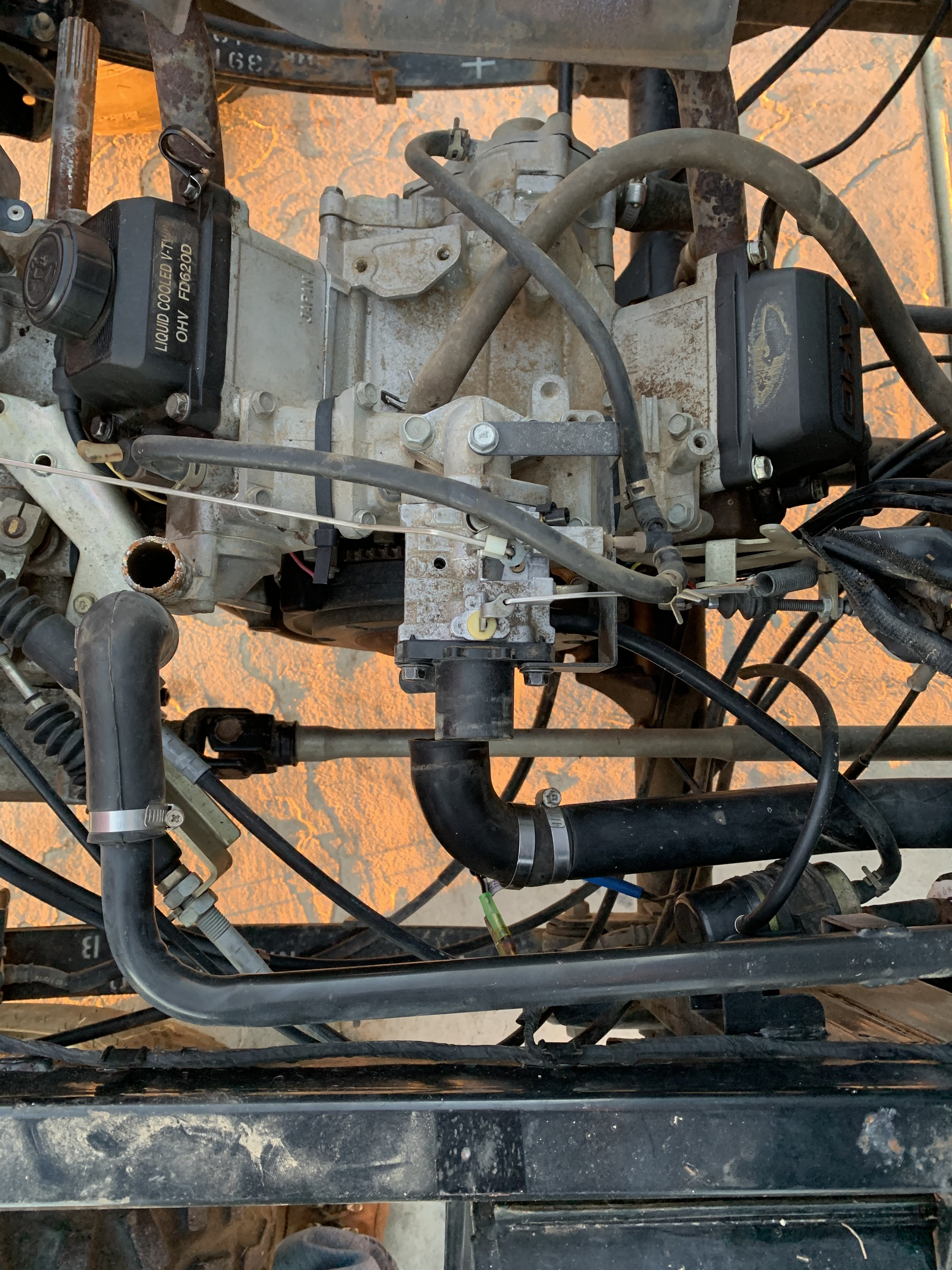

This is how it was when I picked it up

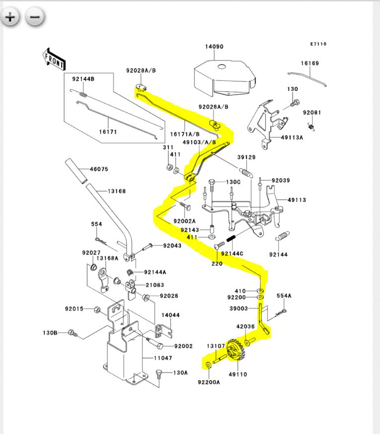

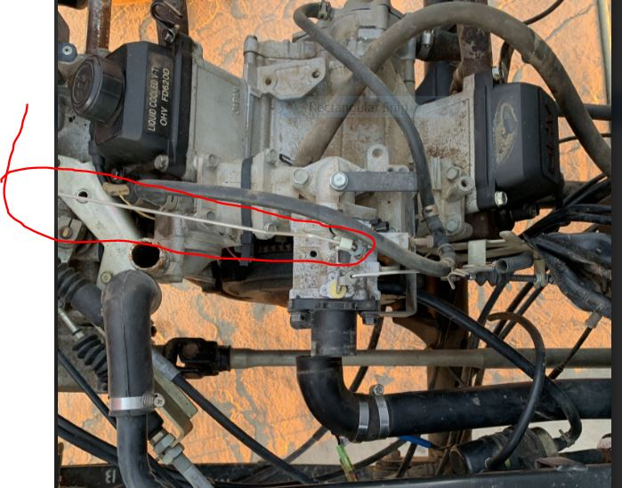

It may be in the transmission. Where does the rod (left end as pictured, red circle) connect P/N 49103/ A/B? I think this is the governor linkage P/N 16171A/B
First picture front of machine is to the right
Second drawing front of machine is to the left

Yes , your are correct , it’s in the transmission... after searching and searching , I blindly went with the idea , that if it wasn’t there , then , it wasn’t there.. I reassembled the engine and have had it running .
Where is the fan at for the cooling ? Up front of the mule by the radiator? I haven’t heard it come on at all , and the coolant get hot , but I’m in sure if it’s circulating I’ve opened the the cap and the fluid level has dropped but it seems to be slowly moving , is that normal? And there is no temp gauge
