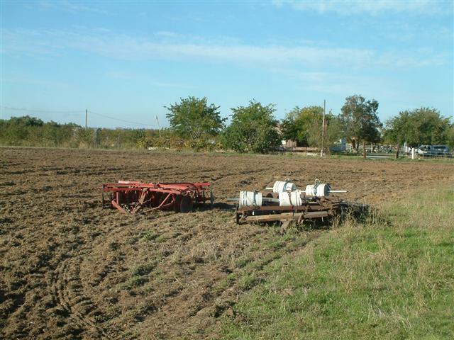

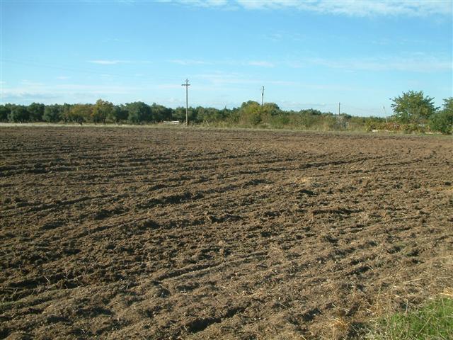

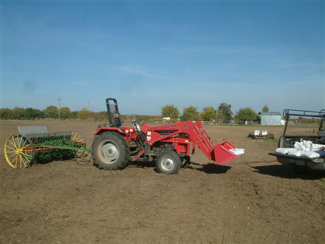

Like you, I started with a small parcel of flat pastureland (6 acres out of 10 on my place). I mowed the weeds as short as possible with my 6 ft brush hog and 2008 Mahindra 5525 (54 hp engine, 45 hp pto). Then plowed with a 6.5 ft wide offset disc with a DIY drag attached (a piece of chain link fence with some concrete paver blocks for added weight) going over the ground three times.
The first year I planted Kanota oats. The seedbed wasn't perfect (quite a bit of trash on the surface) but I had to live with that because my soil is thin gravely loam and not suitable for turning over with a moldboard plow (which just flips the bad soil to the top and buries what good topsoil I have)

I planted oats with an old 10-ft wide Minneapolis Moline P3-6 grain drill that I restored

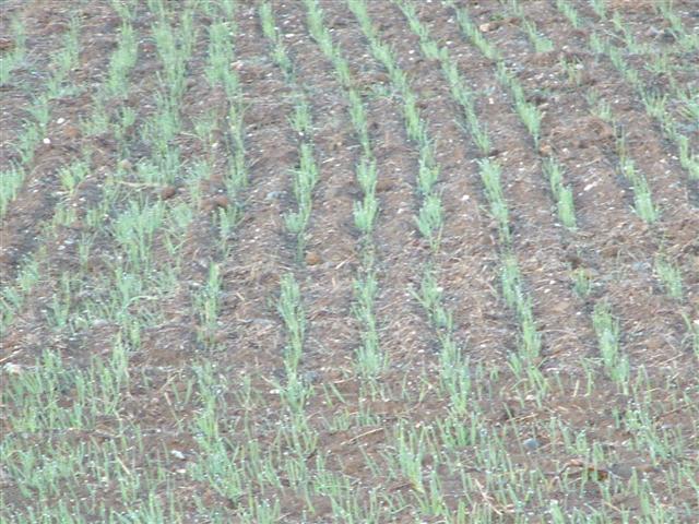

got pretty good germination

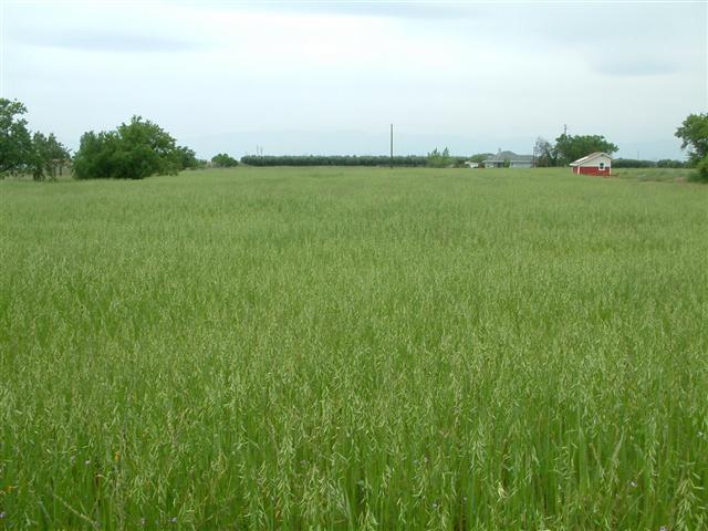

and a pretty good stand of oats

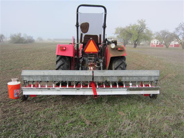

This year I planted two acres of a Lana vetch/annual ryegrass mix, two acres of Austrian winter peas and two acres of bell beans. I used a DIY drop seeder for the vetch/ryegrass

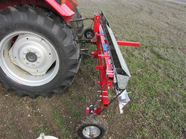

Flusher, what is the planter in the second last picture?
   / Farming for Beginners - equipment questions #15

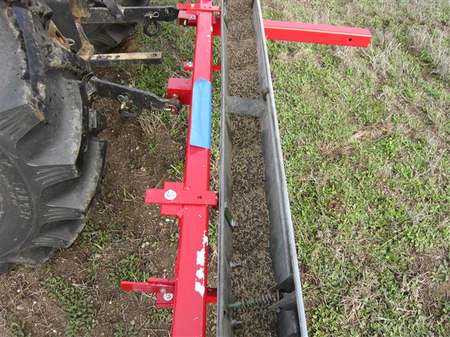

That's a 10-ft wide DIY drop seeder I made a few months ago. I salvaged a pair of John Deere grass seed boxes from a old Minneapolis Moline P3-6 grain drill. Welded up a frame from square tubing to attach to the 3pt hitch. Made a 2-bounce seed chute to spread the seed evenly in a line. Added sprockets, axles, chains and drive wheels.
I included a hitch so I can attach my cultipacker to the seeder and do the seeding/packing in one pass.
