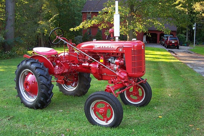

Good Afternoon Tommy,
Earlier in the thread you mentioned the exhaust manifold. When i rebuilt my Super A , I was able to make some vertical cuts in the pipe, and then using a chisel and hammer I collapsed the exhaust pipe and removed it. I cleaned up the threads and was able to reinstall a new piece of pipe, so dont throw it away unless your sure its shot !
Good Luck !

Wow...Nice lookin' tractor Scotty.
The pipe from the manifold is out, but the threads are half missing (rotted).
I was thinking of re-tapping it with a larger diameter, or I was just going to weld a new pipe to the manifold, but decided to just get a new manifold.
