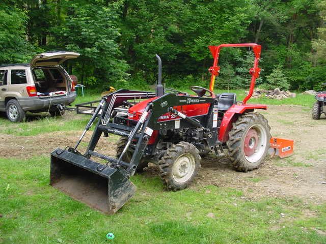

/ Farm pro 2425 PTO speed? #14
I never looked at it that way. Also more friction and lost power but I guess everything has it's drawbacks. I was doing some loader work along side a 21 HP of another brand w/ a 3 cylinder and the guy took mine for a run and couldn't believe the difference. His would bog w/ a bucket load @ 1200 rpm's and mine wouldn't hesitate @ 800 Rpm's lifting a comparable load. He was impressed. Not to start a tractor war I won't mention his brand but my jinma has a rougher fit and finish, costs much less, had a few issues, and works like a bull on Steroids...
