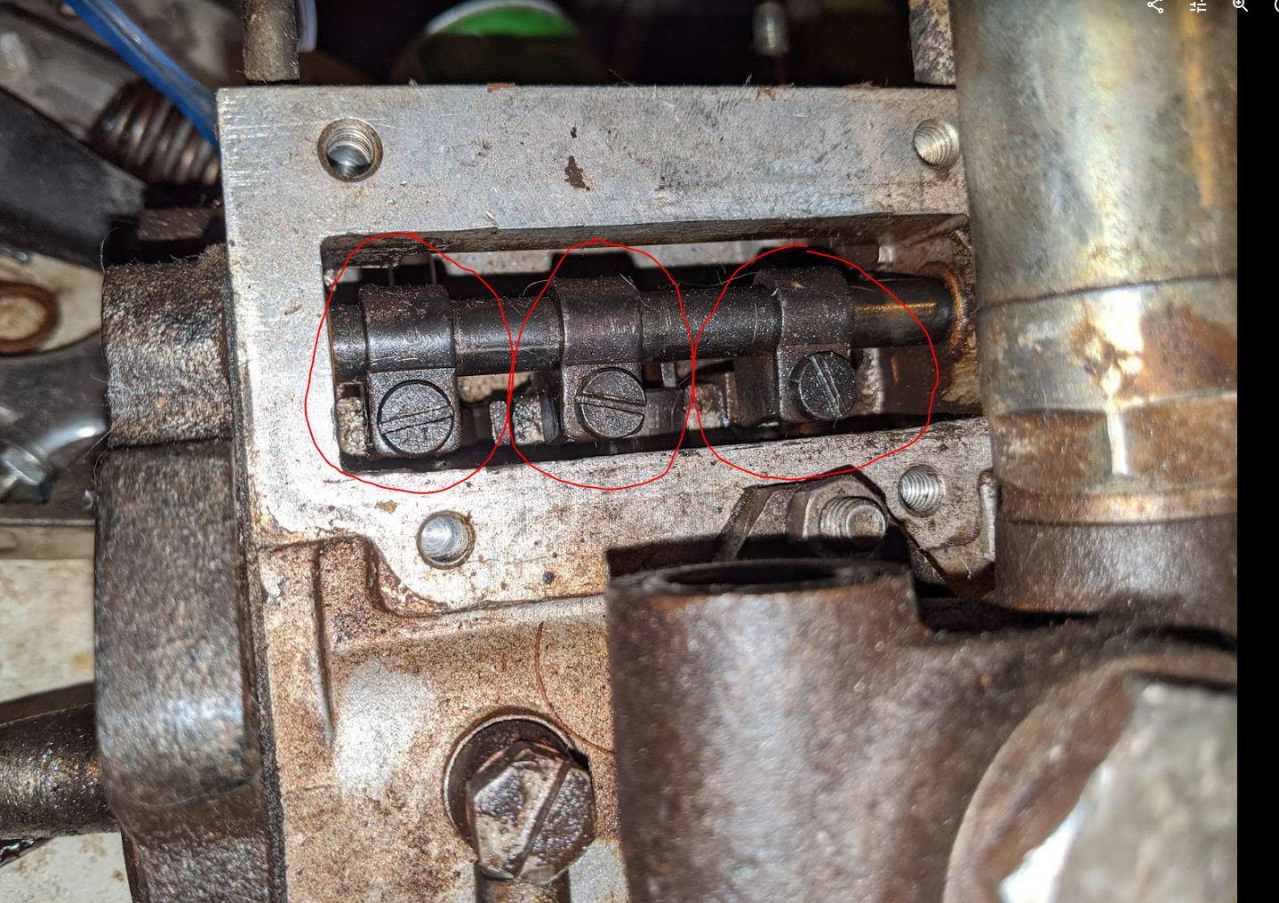

Alright, had some time this morning to look into the tractor again. I pulled the #2 injector and swapped it with another one. No effect at all.
I decided to remove the service cover on the fuel pump to try and see if anything was sticking or causing the injector to receive less fuel than the other injectors? I can't say that anything was gummed up, but I did clean everything out with carb cleaner and WD40. Rinsed with new oil and started it back up. The number 2 injector now causes the motor to stumble when I loosen the fuel line. But now the engine is knocking really hard again. This knock was not occurring since the last post I made. and seems to be a new issue?
I tried cracking each injector to see if one seemed to be the cause of the issue, and now #3 makes the knocking sound completely go away. I recorded some videos of this effect as a reference.
FarmPro 2425 Engine Knock 4
I assume now that the knocking sound is a "fuel knock" based on the ability to remove it by cutting fuel to an injector.
I also noticed that if I increase the RPM the knock continues while the engine is under load, but as soon as you let off the throttle the knock sounds goes away until the engine speed has stabilized. Just a reference point, trying to gather some diagnostic data.
Is there a possibility the fuel injection pump is the problem? Could the injectors be out of sync?
Thanks again as always,
Eric
/ Farm Pro 2425 Engine Knock #38
Just some random thoughts here:
If you swap the #1 injector with the #3 injector and the problem follows the injector that will be easy to fix. If the problem stays with #3 then it is either the pump or a problem in that cylinder.
I can see how excess fuel could cause more combustion in one chamber, but if it goes too rich it wont fire. I would think that the smoking might be related somehow. If you are getting enough fuel overload to cause hydraulic lock it would definitely be washing down the cylinder wall and that would be really bad and should be obvious if you pull the head.
Finally could there be a restriction in the intake manifold that would cause the #3 cylinder to run richer than the others? For that matter could the valve timing and clearance be off for #3? Maybe something slipped when you put it back together. A second look might be a good idea.
One question I have is could that piston have been installed wrong? I don't know if they have to be installed a certain direction.
If #3 is knocking when firing but not when coasting what physical parts could do that? Rod and crank bearings, piston and wrist pin. Could the piston be slapping the cylinder some how?
#39
Hey Piper,
All good points, I have tried moving the problem injector around and it seems like the problem does not follow the injector. I believe the reason the knock has changed locations is due to my meddling with the injector pump fuel rack.
A little more backstory - back to where this all started in post #1. I bought this tractor "running" but with significant issues. In the original diagnostic we determined there was an issue with the fuel delivery being inconsistent, and when I pulled with injector pump timing gear I found the woodruff key on the old pump was sheered off and the bearing on the shaft worn out. I bought a "new" pump and pulled the old one. I still have the old one and have been going through it to learn a little more about how the pumps work and how to tune them.
So fast forward to the new pump. Arrives with all the ports covered, looks new. Try to pull the fuel shutoff and it is locked tight. Before I install it on the tractor, I pull the service cover to see if the fuel rack is stuck and it is. Golden gummy film on the entire gallery. I sprayed some WD40 in the whole compartment and used a screwdriver to pry the rack back and forth to free it up. As a reference, I have my old pump available and for comparison, it's fuel rack is smooth as silk. In the process of doing this the screw down clamps on the rod slip in position. See the image below for a reference of the screws I am talking about - this in on my old pump that I have laying around now.
I realized that this was probably an issue, and loosend all of the clamps. Slid them all to the left side of the rack until each "bound" and then re tightened. In retrospect, I think this was the point where I messed up.
Cleaning the gallery again today also caused one of the clamps to slip - so I moved it and re-tightened. After restarting the tractor is has the loud knock on the #3 cylinder. Typing this all out makes me believe I have messed up the injection pump calibration/setting and that is the source of my issue.
Can anyone confirm this is my issue? And if so, is this something I can correct or do I need to replace the pump again or have this one serviced?
/ Farm Pro 2425 Engine Knock #40
Moving the segments IS DEF. where u messed up.!!
THOSE ARE the individual fuel adjustments for each cylinder..
I have set them ON the tractor before..{Ford}
IDK if "YOU" should do it while the pump while its running..??
Here what I suggest>> remove the side cover, pull the stop to find out which DIRECTION is STOP..
Then, with the engine NOT RUNNING, move # 3 segment SLIGHTLY to the stop direction..
U have HEAVY BLACK smoke, right ?? that means its over fueling.. so u wanna cut the fuel back.. so u move it in the cut-off direction..
AND TIGHTEN..
THAT adjustment is very sensitive.. so go slow.. restart the engine & see what u have done..
