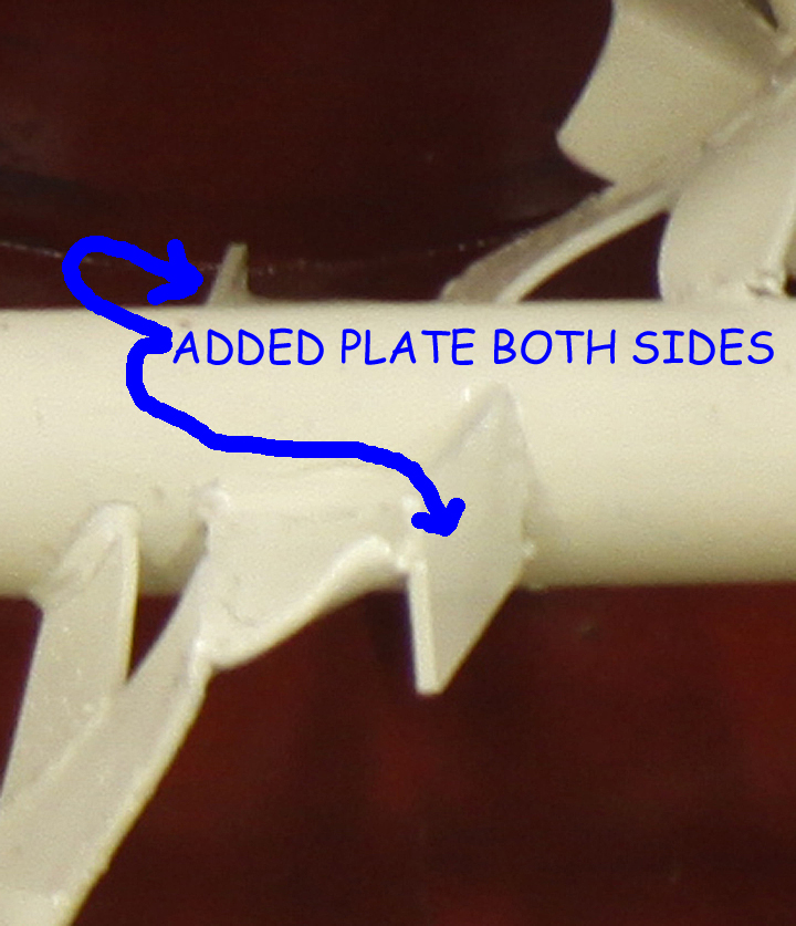

I had a farmking blower for about 6 seasons. they work great. The only issue i had with mine was i bent the augar several times on hidden rocks (we grow rocks in N. Idaho... i kid you not. they show up in the middle of my lawn every year...large rocks). I ended up having to weld a few support plates on the auger and this stopped all further trouble. Also learned not to use too strong of a shear bolt. The blower worked best after the ground was good and frozen. Congrats.
Mine had hyd chute rotator also...worth every penny.

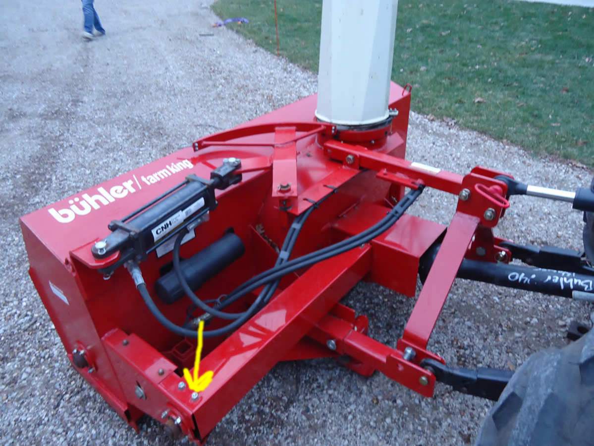

Can you explain to me how to replace the auger shear bolt? I can't seem to figure it out.
Thanks much.
/ Farm King 740 snow blower #15
Can you explain how to replace the auger shear bolt. I can't seem to figure it out. Does the sprocket and bearing have to be removed first?
#16
The auger shear bolt is located by the small sprocket that the chain is on. If you rotate the auger (usually best to have someone else rotate it while you look) you will see 2 circular plates and a small hole for the bolt to go through. you have to line up the 2 plates and holes to get the bolt in. I attached a pic- look at the yellow arrow but it will be under the metal cap which you don't need to remove. Hope that makes sense but if it doesn't let me know and I can take a picture of exactly where it is.
#17
To answer your other questions- no- nothing needs to be removed to replace the auger shear bolt. To replace the 2 prop shaft shear bolts you will need to take the driveshaft off but thats easy as well.
