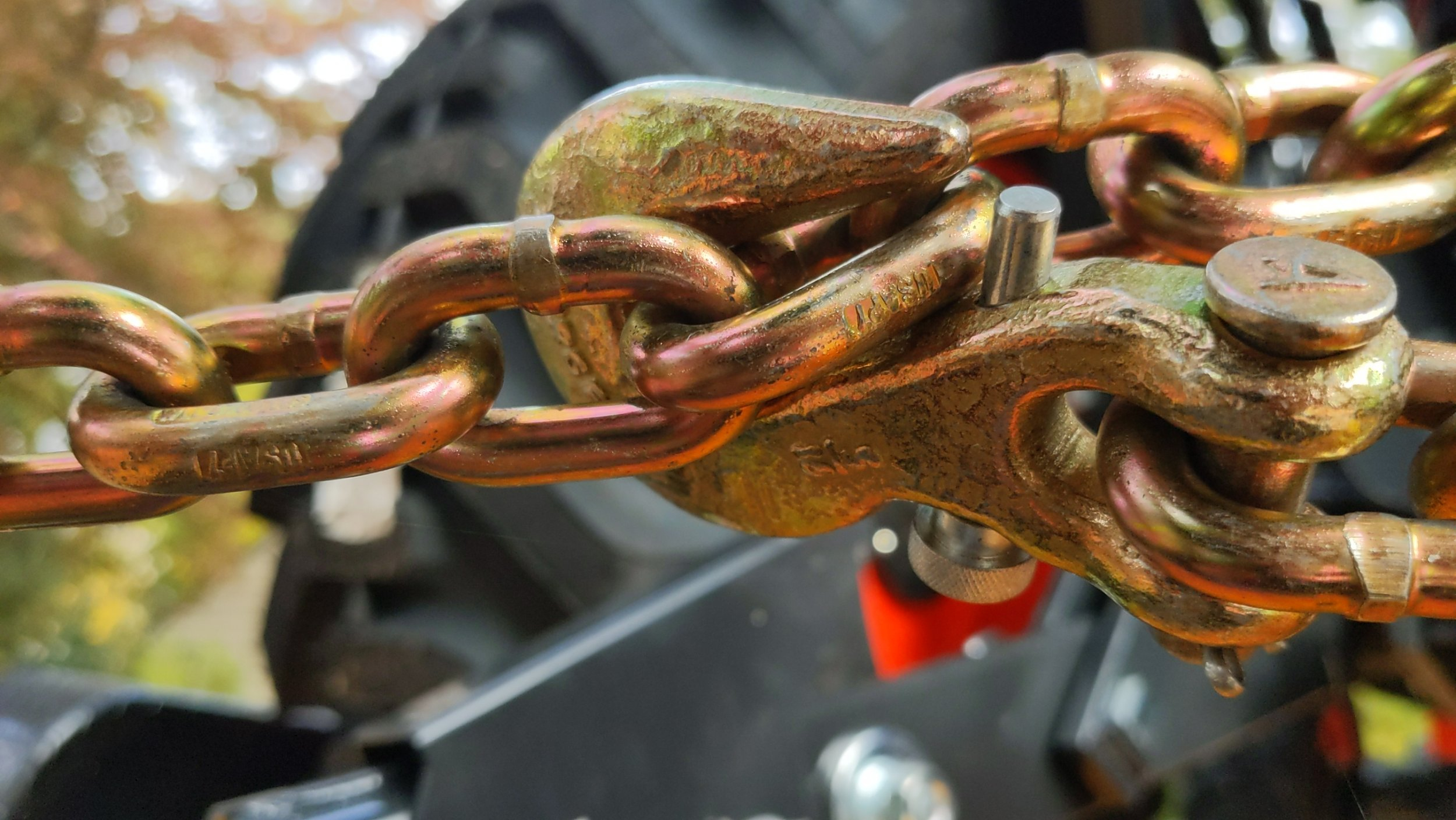

Edit: I'd also reccomend keeping your hooks facedown (open end being the face), that way if you get sudden slack they will not not fall off (yes, that is what the pins are for, but why fight gravity?). In your last image, both of the yellow speed-binders look to have one up and one down. If one can't get the hook facedown, they should face away from the strain of the load (the left one closest to the trailer faces towards the tractor it looks like), if they are faced away both the chain and hook should drop together instead of the chain falling out of the hook.
Your chains will also stay together from loose on pickup if facedown or away from the strain. As you pull the chain into the hook from slack.

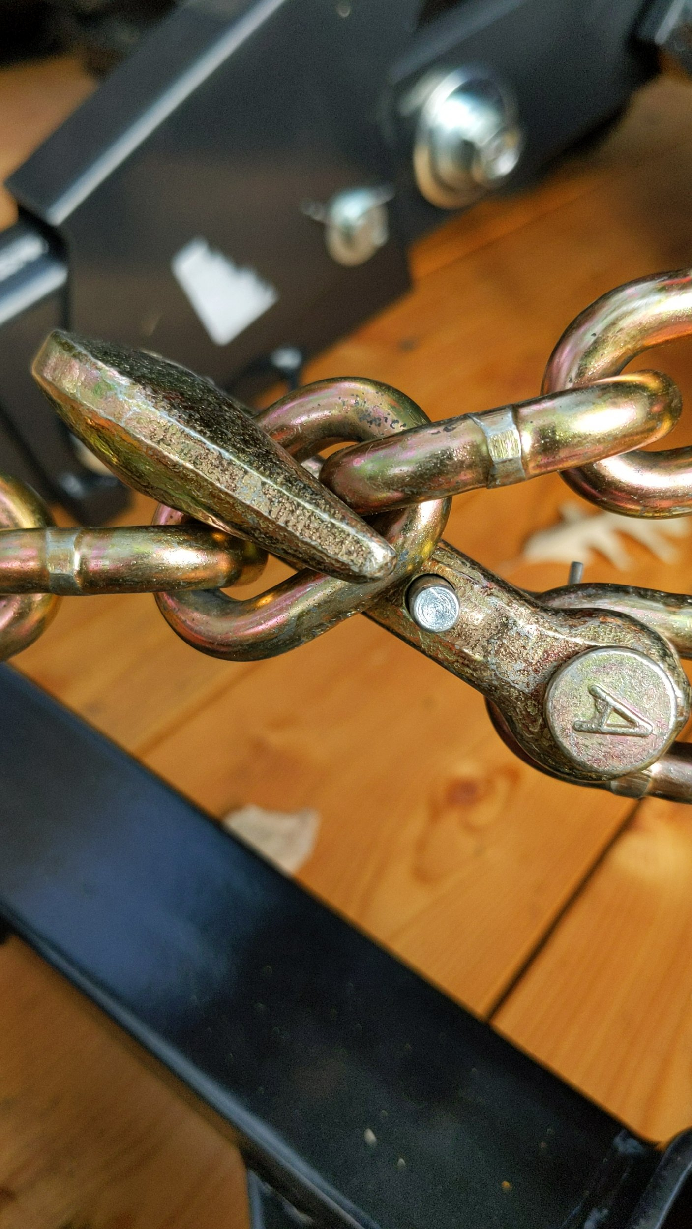

pretty new to chaining anything. For my grade70 chains i dedicated to my tractor's trailer, i bought 'locking' style clevis grab hooks
  • because it makes setup a tiny bit easier (no dropped hooks before i get it snug), plus
  • theoretically in a "bad event" where there was a some momentary slack (broken chain on a different corner, collision, etc) the locking pin might keep the hook engaged until the (shifting - again, SHTF situation) load finds a new position. Theoretical, border case; but I drive an undivided winding two lane highway that has zero barriers, a 15' embankment to a river, and a bunch of idiot drivers - so I'll take anything i can get :)
Anyway, two of my four hooks, after just one use, clearly have had some load put on the pin (and the pin can obviously take *zero* load - one locking pin cannot be operated at all, even with pliers, and the other one is very tight now but still hand-operable.
Here's a picture of how I have them bound: This one is undamaged, has ~1/16" gap to the pin in this setup. Of course i didn't know the pins were damaged before i loosened the load the first time, so I don't have any pictures of the 'bad' engagement - but I was pretty careful and it was set up exactly the same way.
Here's the hook that is still 'barely operable' (I've left the pin open where it stays by friction now)
Can you think of anything i could be doing wrong here? About the *only* variable i can think of is 'loop length' before i grab the hook to its chain; mine are short, maybe 6" here. Thanks!!
Change tractor to a 2 points tie down instead of just 1. Most securely is typically at axle.

There are safety reasons, why orientation is something to be educated about. A few quick points on this. You want the force to be pulled into the throat of the hook, regardless of what style hook. If you orient the hook so the force is into the tip and not the throat of hook, you have set the hook up for failure (it only takes one failure) and you have a bad or worse day!
Hooks falling off chains is frustrating—probably why you went with these hooks to begin.
A loose chain is dangerous as is a loose load.

There is a reason I've never ever seen those hooks with the pins being used. They are practically impractical. You could hook everything up correctly but still have everything move on you
